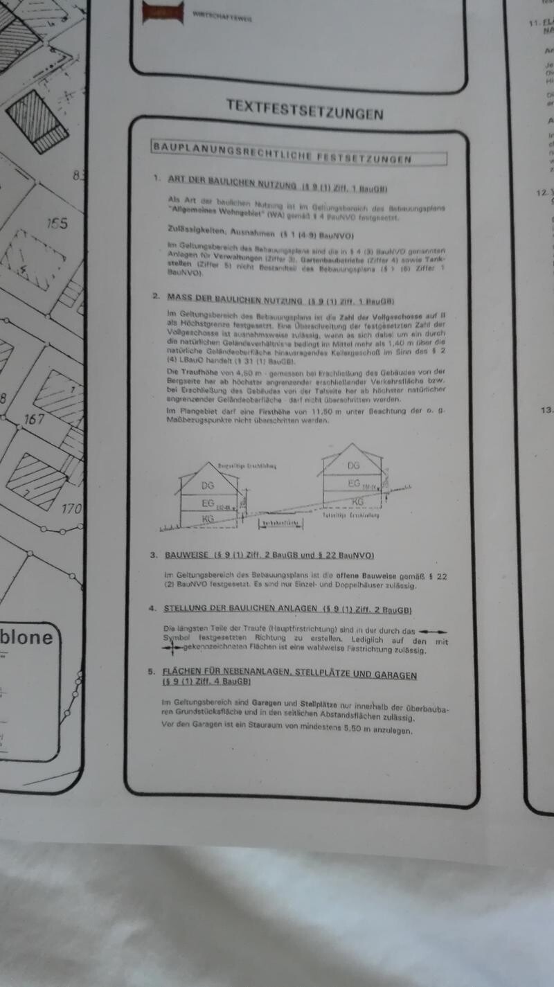

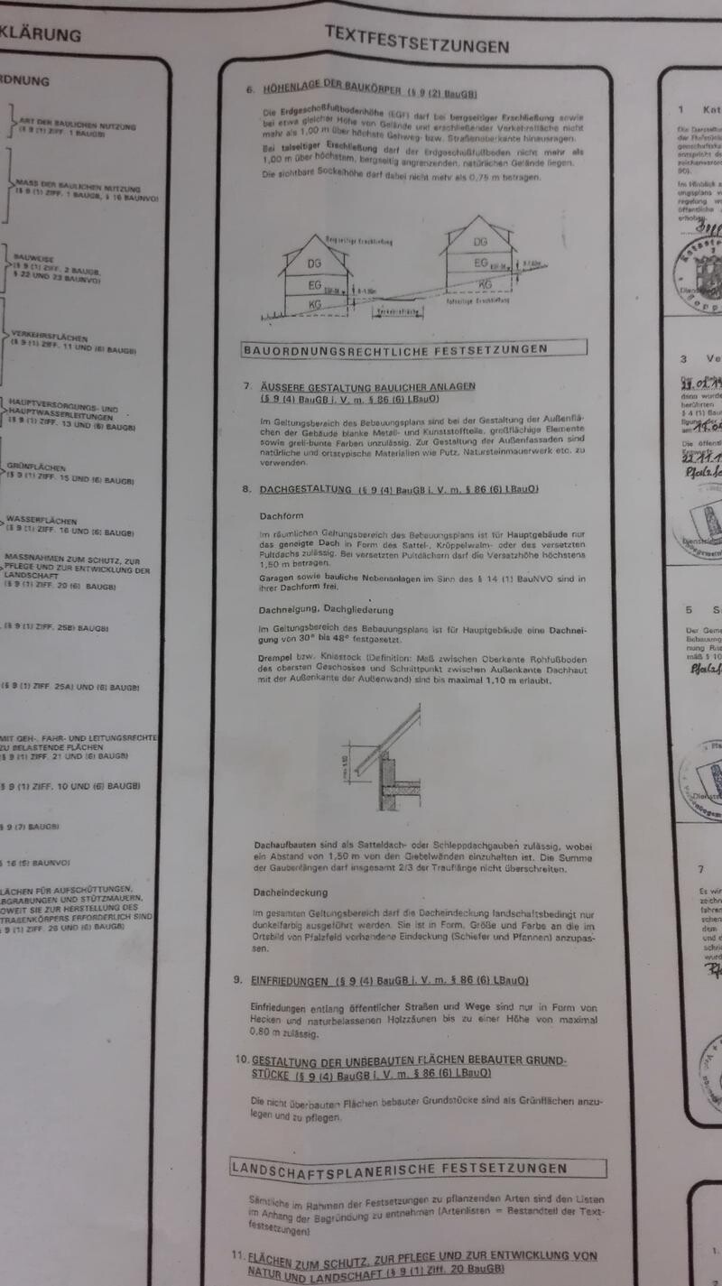

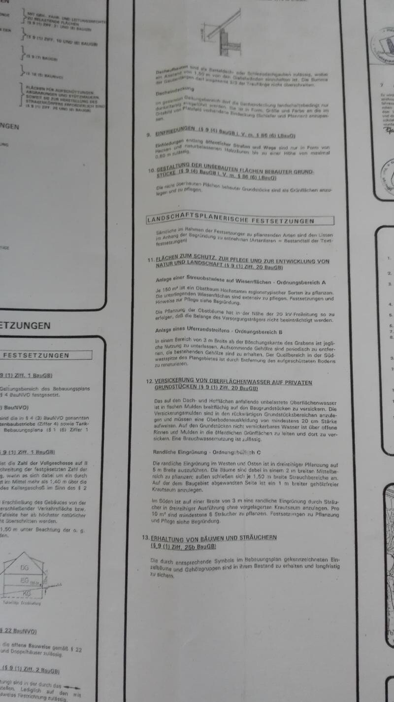

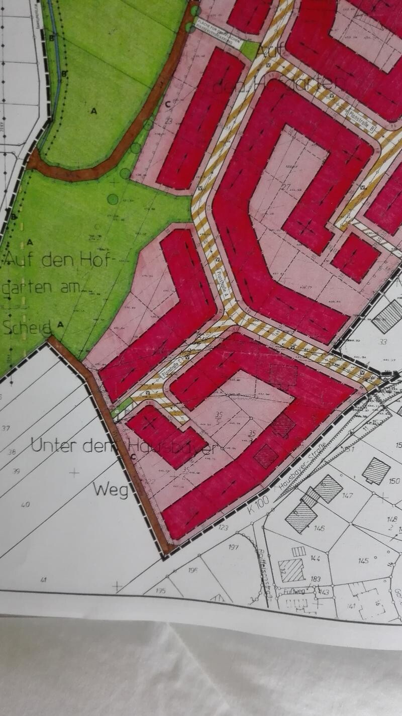

Here are the site plan and development plan (many regulations were later relaxed in the bylaws). It is a challenging building plot, and positioning the garage is not straightforward due to the required setback distances that must be observed.

Black and white document with text, heading: Landscape Planning Provisions.
Image of a page from a building regulation document with diagrams of two houses and text sections.
Page with text elements on land use planning provisions and house diagrams.
City map of a residential area: red building blocks, green park to the left, yellow-striped streets.
