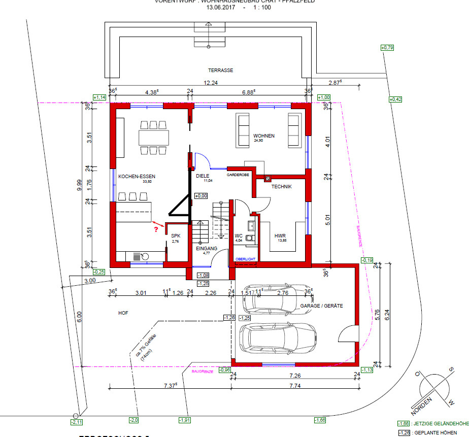

We have now had several meetings with our architect and are unfortunately quite dissatisfied with the designs. These are the 5th drafts and still far from what we envision.
Here are the designs for now.
I am particularly bothered by the awkwardly shaped rooms. According to the architect, this is necessary due to the structural requirements of the urban villa...

Linda85 schrieb:
And the questionnaire
Development plan/restrictions
Plot size 914 sqm (approximately 9,830 sq ft)
Slope yes, visible in the plan. About 3 m (10 ft) from the street to the rear edge of the house
Building window, building line and boundary see plan
Edge development see site plan
Client requirements
Style, roof shape, building type city villa
Basement, floors 2 full floors without basement
Number of people, age 4, including two children
Space requirements on ground floor and upper floor see design
Overnight guests frequently
Open or closed architecture rather closed
Kitchen and dining room in one space with large sliding door to the living room
Fireplace tiled stove in the living room, ideally can be fired from the hallway or utility room
Music/stereo wall position open
Garage used as basement substitute, two parking spaces in front
Who designed the plan:
- Architect
What is disliked? Why? Complicated room shapes
Preferred heating technology: Gas underfloor heating plus tiled stove
Why has the design developed the way it is? For example
So far, discussions have mostly focused on dealing with the slope; the rest developed somewhat incidentallyS
Silent0107 Jul 2017 09:27Angled walls are not necessary in a townhouse and nowadays are never strictly required from a structural perspective. Instead, there are beams and girders for that purpose.
In my opinion, the intricate room layout is more due to the architect starting with an angled design on the ground floor and then directly copying it to the upper floor, so that the load-bearing walls line up exactly – this makes the structure simpler and more cost-effective.
Unfortunately, I don’t understand what you mean by “angular.” Would you prefer a more open layout? The only “angular” part is really the entrance to the dining room / hallway area. If you remove the angle, the hallway feels uncomfortable and cramped.
My issue is the “stairwell.” It makes the whole space feel rigid and somewhat eerie.
However, I have no experience with split-level designs.
I am also asking what exactly you mean by "angled"? Do you mean the projections and recesses in the walls of the rooms, for example, the living room or bedroom?
If so: We also built a townhouse, somewhat smaller than yours (160 m² (1722 sq ft)) and we don’t have that! It wasn’t a structural issue.
