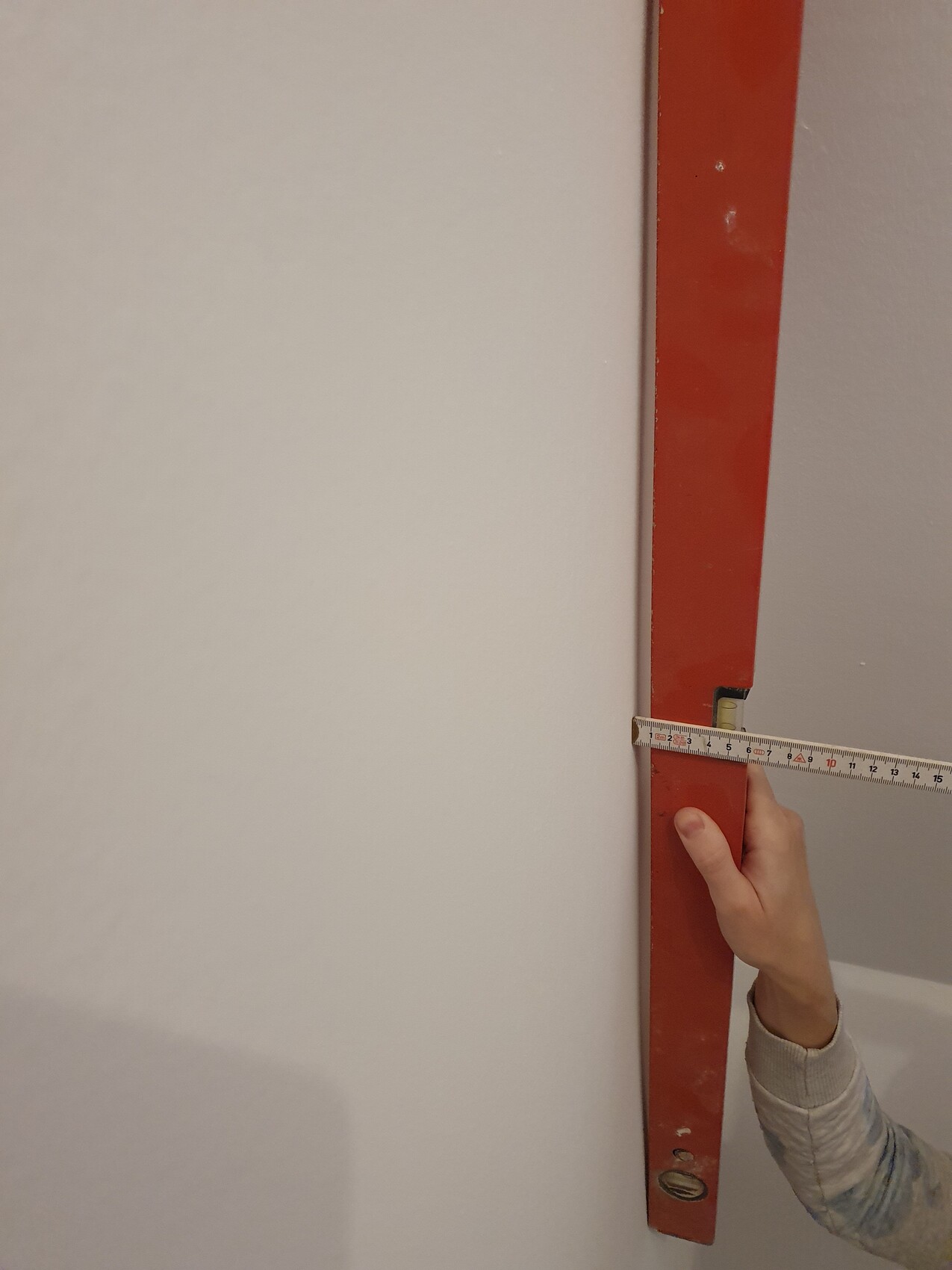

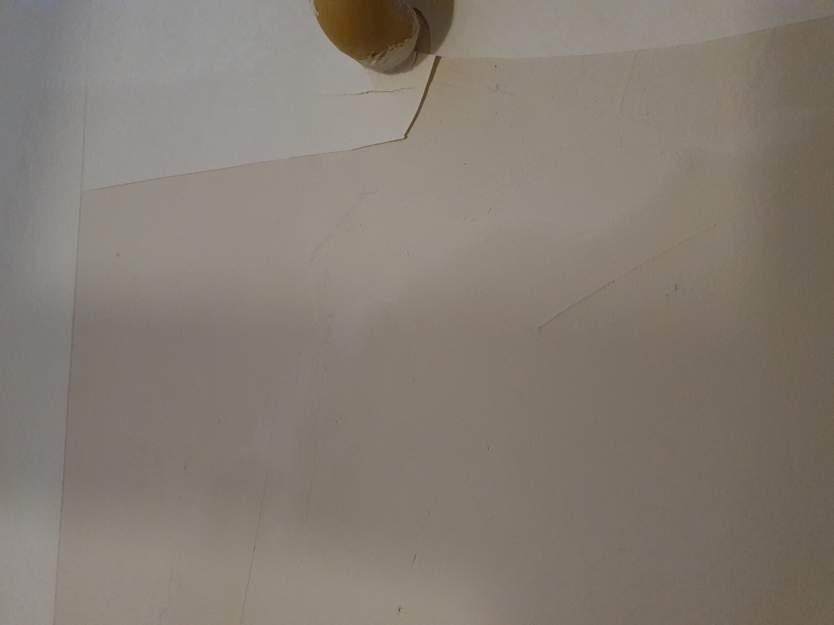

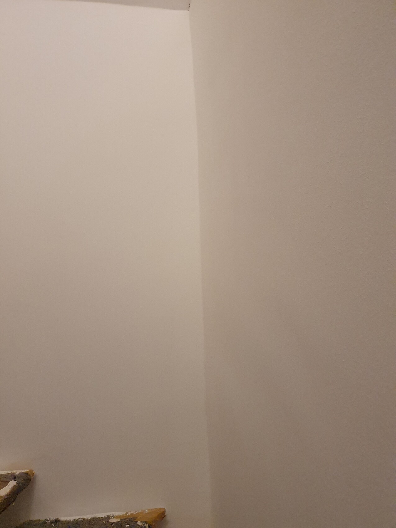

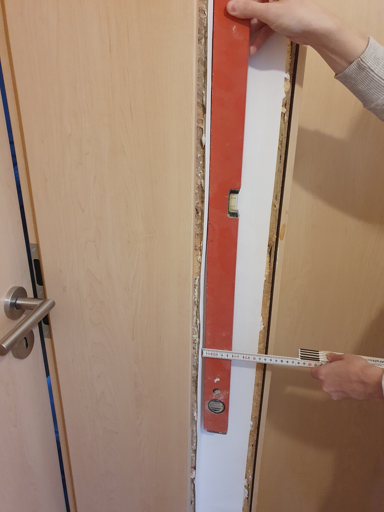

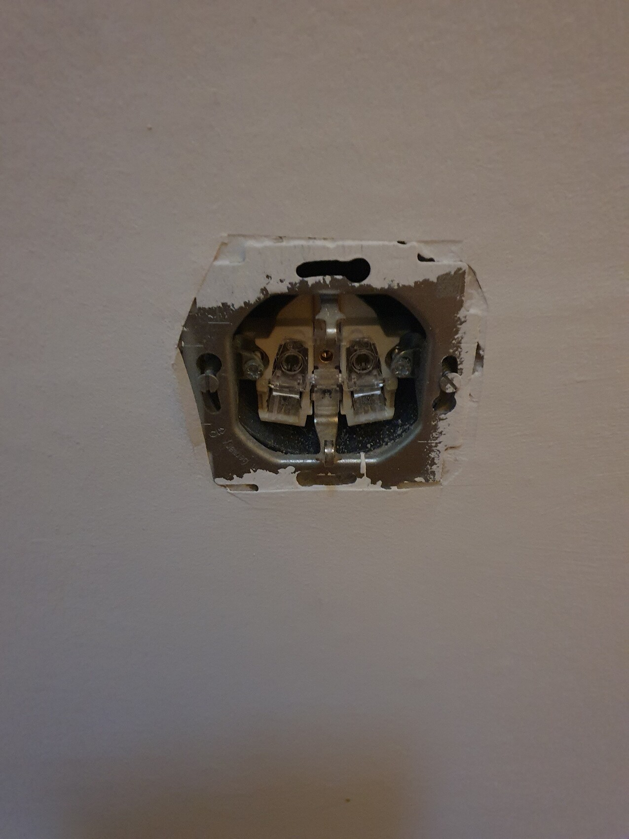

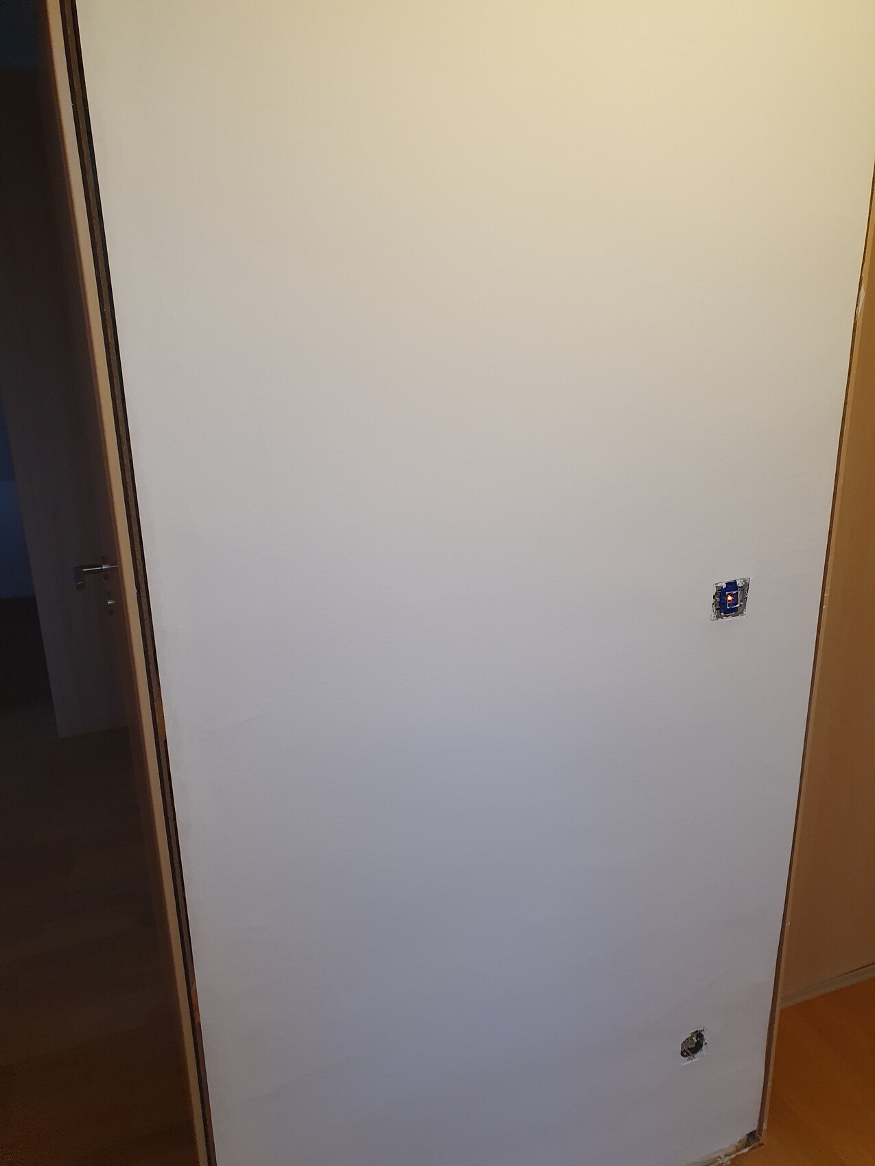

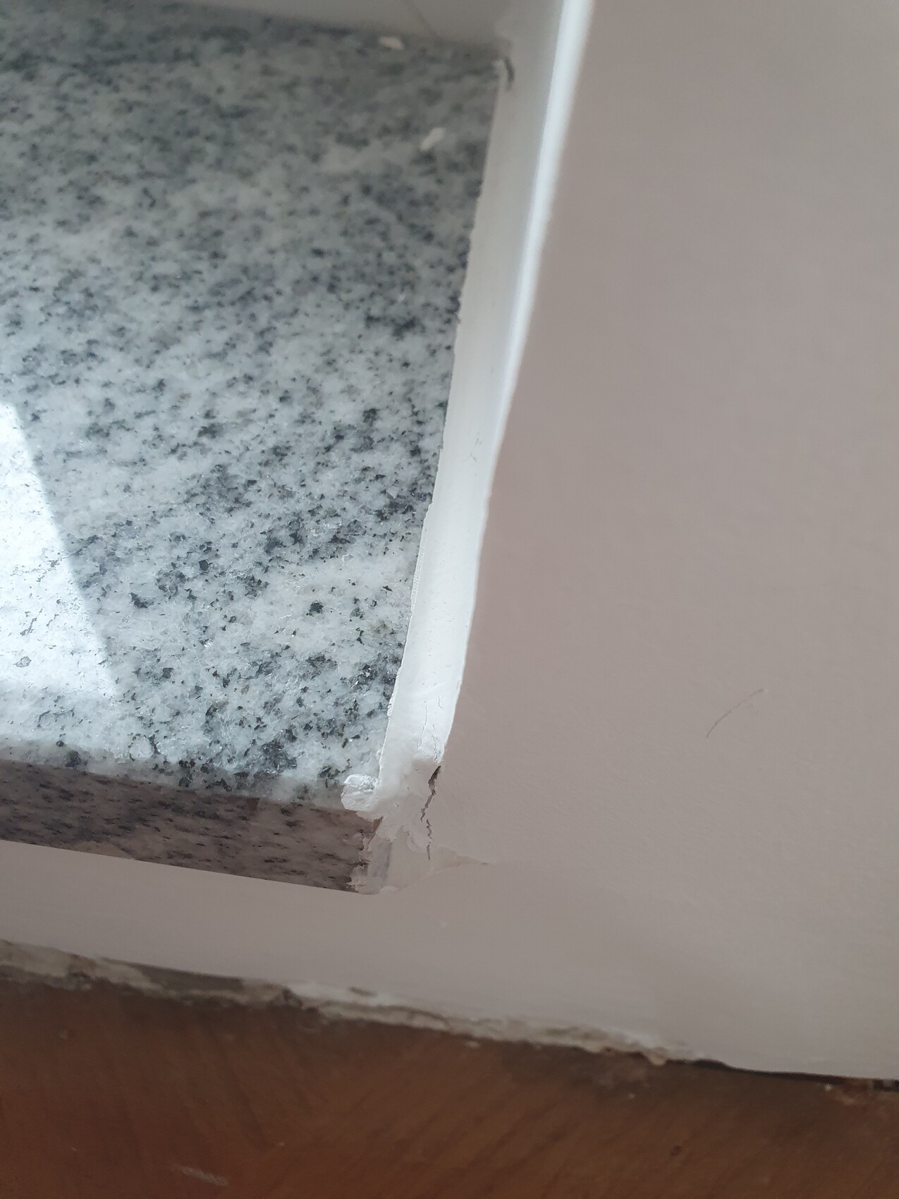

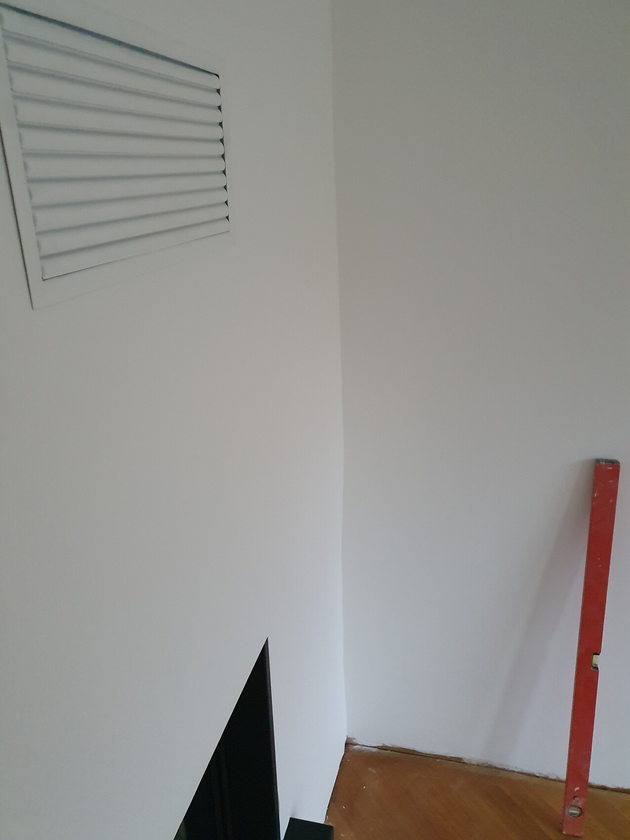

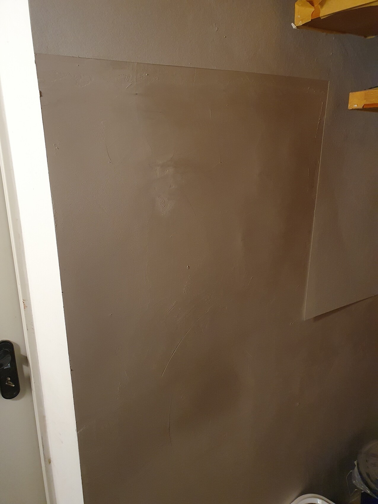

Here are a few pictures. I can send more if needed.
My intention is not to withhold payment or avoid paying invoices. I would like the defects to be corrected. Of course, the question is whether these are actually defects.
It looks okay overall, but there are many runs in the paint, some corners are poorly glued, and none of the corners were sanded. In some places, the fleece isn’t properly adhered to the wall, and on many walls you can see indentations because the walls were not sanded beforehand. He probably intended to even everything out with a thick 160g glass fleece, but he only managed to do so partially. It’s also clear that he didn’t sand at all. He barely taped anything off, and the new windows, doors, and radiators are all dirty and smeared with paint, plaster, and so on. We had a fireplace installed, which he also didn’t tape off—the paint or wallpaper adhesive has soaked into the new hearth in one corner. Looking at the inner corners, they appear quite uneven, as are parts of the walls.
So far, we have paid an advance of €9500.
It’s really a shame that he put in so little effort; everything feels rushed and done quickly. Being a one-man operation, he obviously has a lot on his plate. It was a mistake to hire him, but that’s the situation now. The site looked like it had been through a bombing raid again.

White interior wall with ventilation grille, red level on the wall, wooden floor visible.

Interior wall with brown plaster, filler marks, construction site inside.
Close-up of a granite kitchen countertop with damaged edge trim next to the wall
