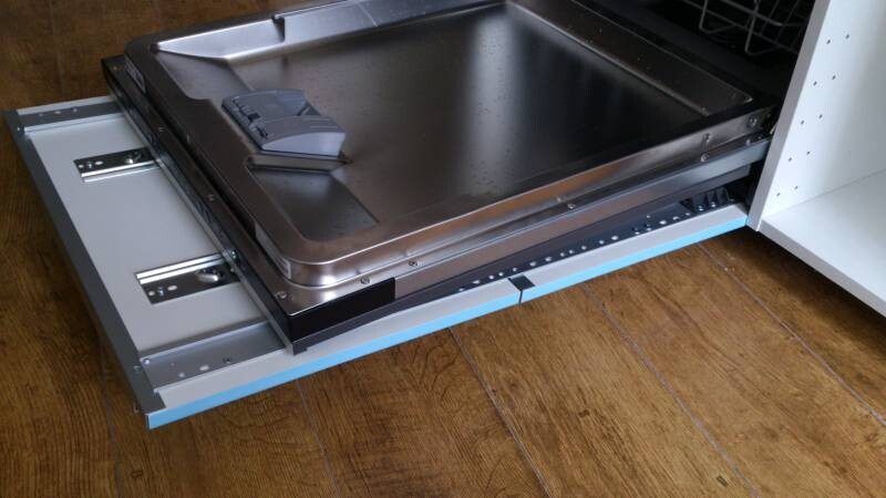

Additionally, I found out that Metod requires a special mechanism where the dishwasher fronts slide along rails attached to the dishwasher door. I think it works similarly to the sliding doors on refrigerators.
What isn’t clear to me yet is whether this special sliding mechanism is mandatory with Metod, or if you can still mount the front fixed directly to the dishwasher door as before. Does this have something to do with the different plinth height between Metod and Faktum?
If you want to attach multiple partial fronts to the dishwasher door, you need the Vaglig (20250663) product. This consists of two rails that hold the partial fronts together. But as far as I understand, this does not include the sliding mechanism itself.
For the sliding mechanism, you then need either Resonlig (50248348) or Behjälplig (50242426). The difference between these two seems to be that they fit different dishwasher models (Resonlig for Skinande, Rengöra, and LAGAN; Behjälplig for Hjälpsam). However, I have not yet figured out which one is needed for a non-IKEA dishwasher.

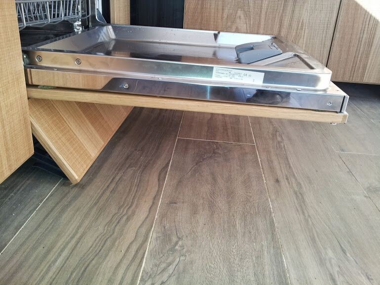

IKEA-Experte11 Feb 2015 18:46I assumed the old kitchen cabinet was 720mm (28 inches) high. If you now have 770mm (30 inches), you will need 30mm (1.2 inches) more space with METOD. Measure with the door open to see if there is still 30mm (1.2 inches) of space between the bottom edge of the door front and the plinth under the sink. If so, it should work; if not, it won’t.
bubbel_599411 Feb 2015 19:05Man, man, man, thanks a lot, Ikea expert 😊 Now I finally understand where the problem lies. The bottom edge of the front panel is touching the dishwasher housing when the dishwasher is fully open. Yeah, that’s going to be tight. My front panel is already almost flush. So, according to what you mentioned about the ERSÄTTARE, it should be possible to fix this. If I understand correctly, the front panel swings slightly underneath the dishwasher instead of directly against it.

bubbel_599411 Feb 2015 19:41What kind of strange patent is this? Am I supposed to cut up my beautiful Bodbyn fronts so I can fold them like this? That just won’t work. I’d rather lower the dishwasher so the bottom edge of the front lines up correctly. That would solve the problem, and there would only be a small gap at the top by the control panel that needs filling. I’d prefer a 1–2 cm (0.4–0.8 inch) gap at the top rather than cutting up my nice fronts. Also, lowering the 20 cm (8 inch) section at the bottom doesn’t work visually because the pull-out drawer below is 40 cm (16 inch), with two 20 cm (8 inch) sections above.

IKEA-Experte11 Feb 2015 19:51That would be the Stefan solution for a semi-integrated dishwasher.
