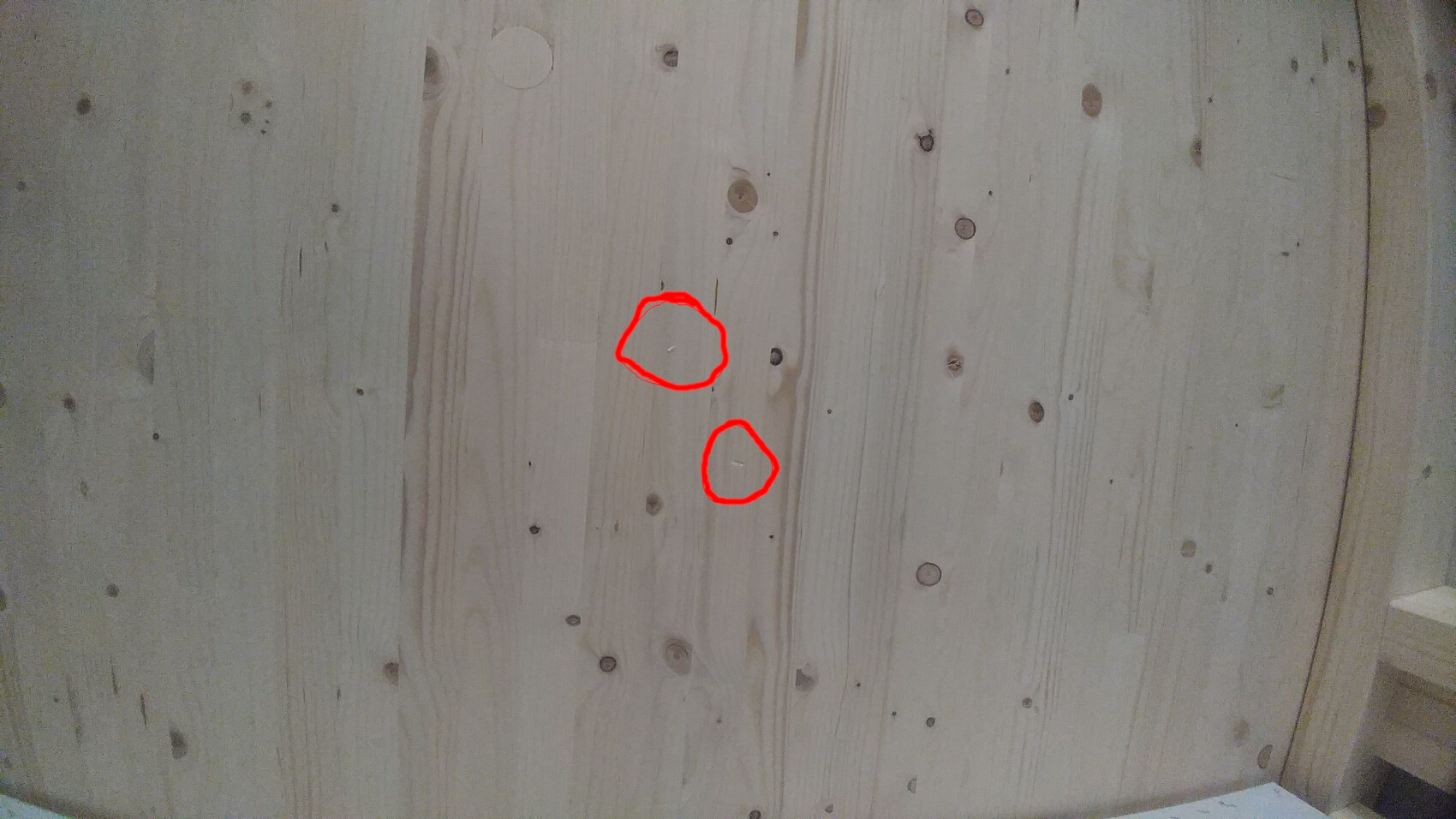

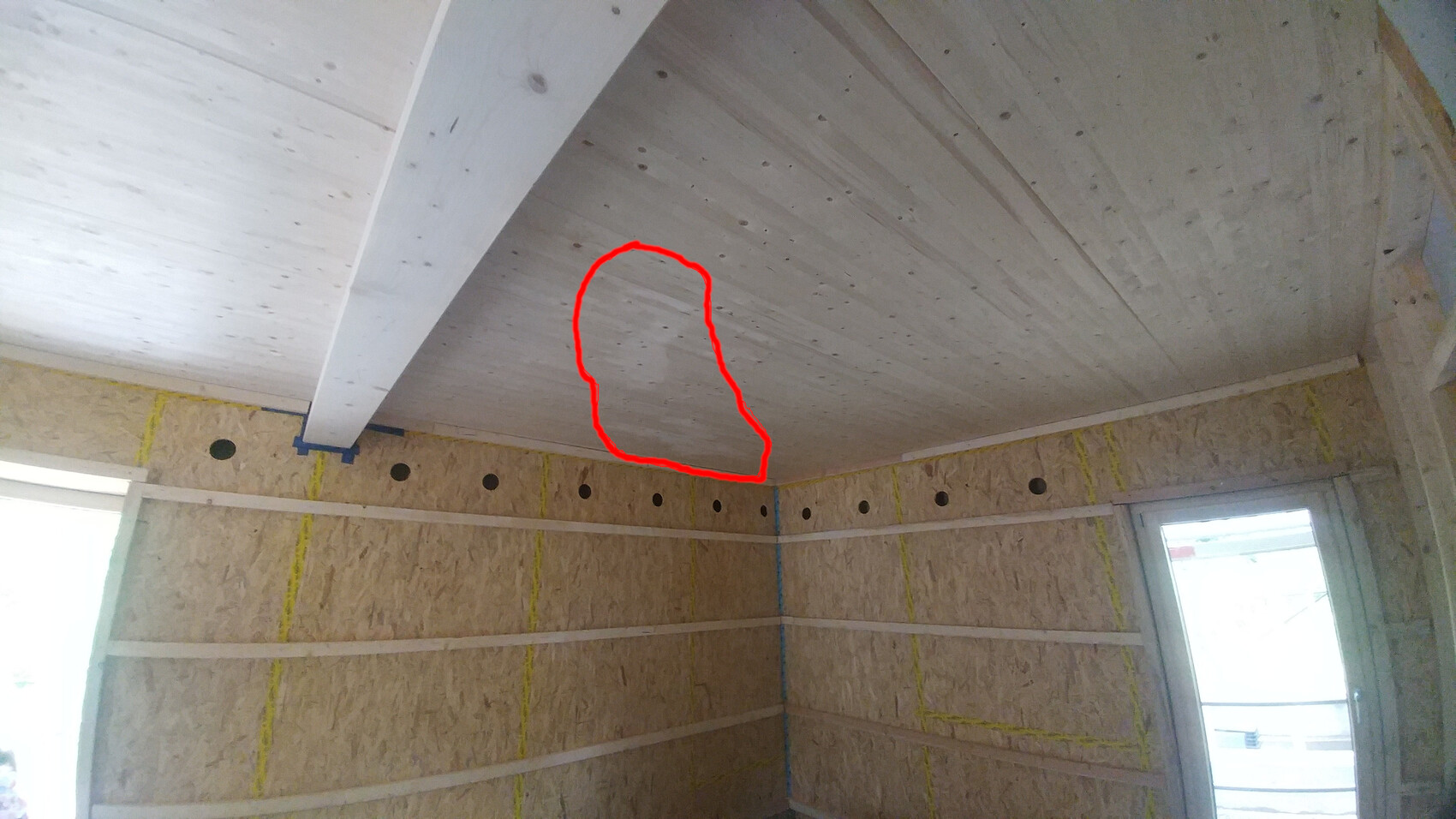

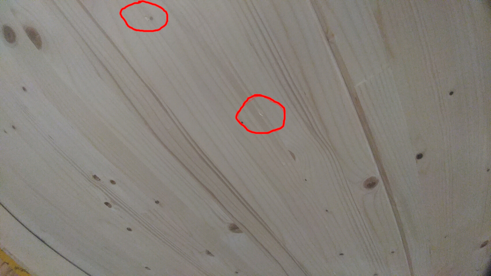

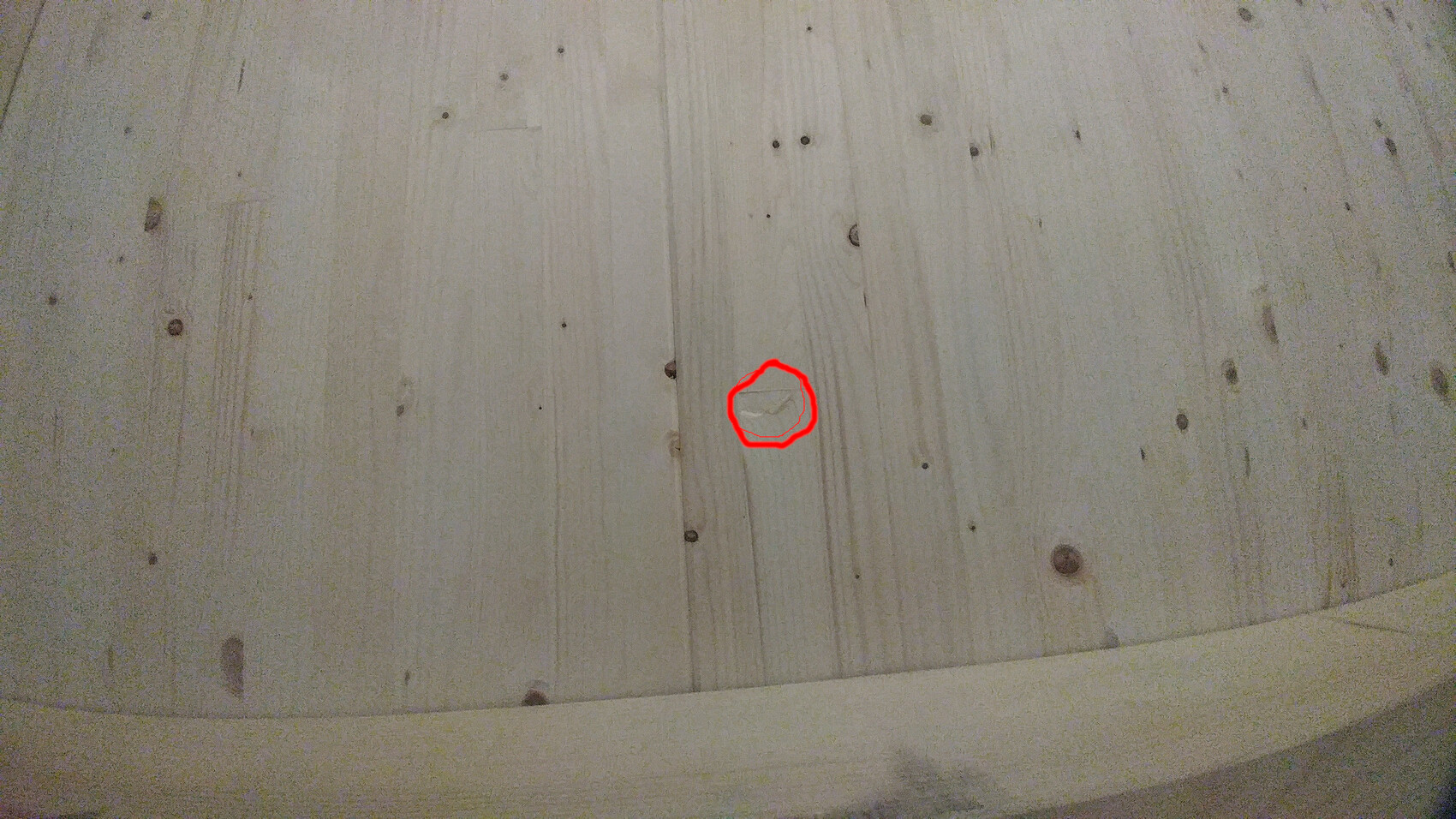

Throughout the house, we have visible whitewashed nail-laminated timber ceilings. Especially on the ground floor, there were unpleasant discolorations and scratches on the surface. The discolorations have now been sanded off, but the difference compared to the surrounding ceiling is very noticeable. The scratches are still there.
What do you think? Should we accept this or insist on having the entire ceiling on the ground floor sanded?
Here are some pictures to show what we are talking about...

knalltüte20 Jun 2020 21:10Hello,
are these really glued laminated timber (glulam) ceilings? The chamfers in the pictures suggest otherwise?!
I only know of elements up to 3 x 9 m (10 x 30 ft) in size. In that case, such chamfers wouldn’t be noticeable.
Did you definitely order visual grade?
How do you plan to sand out such grooves over a large area? I find that nearly impossible. Grooves in solid wood are moistened to raise the fibers again, then sanded. This may need to be repeated several times.
To me, this looks like standard “industrial grade” (which we also order, but plan to leave the ceilings exposed, without drywall, so they remain visible).

Wiesentalbau20 Jun 2020 21:27Glulam beam ceiling is included in our offer. Unfortunately, the term "visible grade" is not used, as we just realized, but rather "glulam beam ceiling visible." This could probably be interpreted more generously, and industrial grade might be used.
What do you think about the discolorations? Will they even out over time, or will there always be a visible difference?
So you are also currently building and ordering the ceiling in industrial grade and leaving it visible. OK. In that case, do you have to expect such marks?
