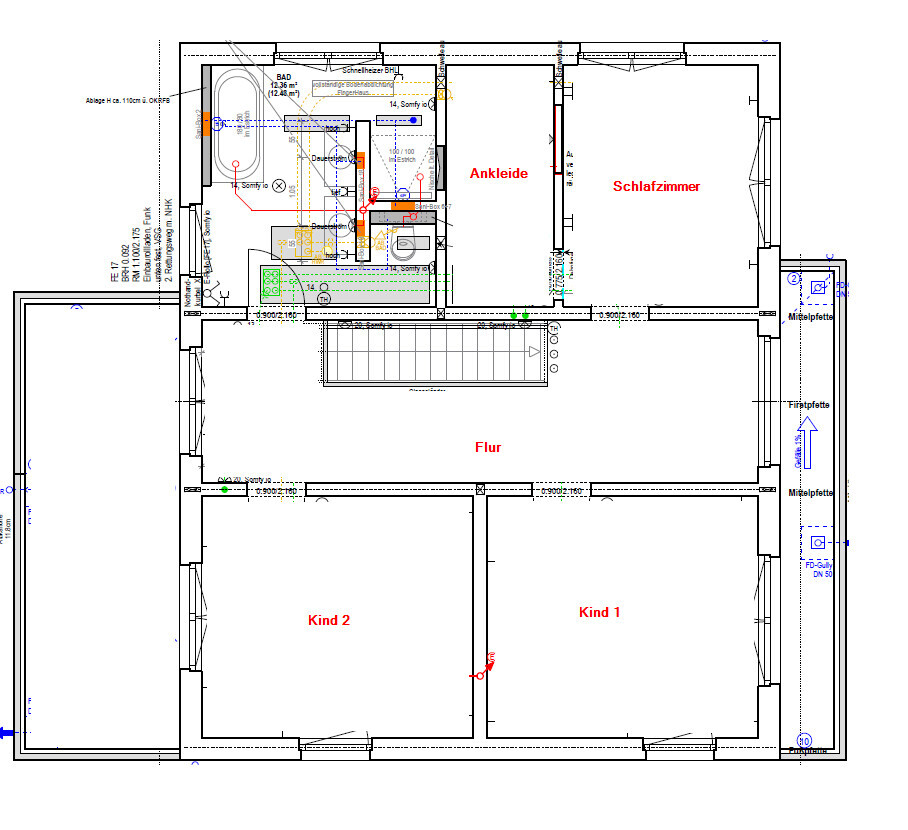

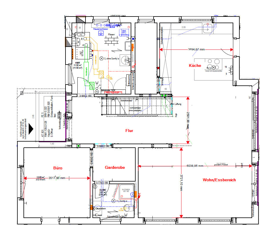

I’m facing the often-asked question myself now: in which direction should I lay my hardwood flooring?
On the ground floor, we have 20cm (8 inches) wide planks, ranging from 2 to partly 6 meters (6.5 to 20 feet) in length.
On the upper floor, the planks have the same lengths but are only 15cm (6 inches) wide.
We are gluing down the flooring ourselves, meaning we also run the planks continuously through the doorways without expansion gaps.
Only the bathrooms and the utility room are tiled; the rest of the rooms, including the kitchen area, will have wood flooring.
I lean towards laying the planks parallel to the hallway on both floors.
This goes against the “rule” that you should enter a room across the direction of the planks. The stair treads would also run perpendicular to the plank direction.
However, the natural light would fall parallel to the planks, which I have read is the preferred approach.
The photos are roughly oriented to the cardinal directions, so the top is north. This means the evening sun comes from the right side into our living room, and on the upper floor through the large window at the right of the hallway.
What do you think, how would you do it?

WilderSueden22 Feb 2024 22:08The parquet floor installer just has a cut piece in every row. Very labor-intensive.
Fuchur schrieb:
So a long, narrow hallway should be covered across the width, That's correct. However, there is no long, narrow hallway here. It is comfortably wide and opens up in width after the staircase.
So everything is fine. By the way, we also have flooring laid lengthwise in a hall with a width of 2 meters (6.5 feet), but not wooden planks—rectangular tiles instead. That works well.
But cutting across is not really a problem. Cutting lengthwise is more difficult. For professionals, it’s no issue, but for amateurs it’s tricky. If the wall is not perfectly straight, it gets even more complicated. So, for DIY work, this is actually an argument in favor of cutting across the corridor.
@ypg, yes, on the ground floor it opens into the room, but on the upper floor it is quite elongated.
