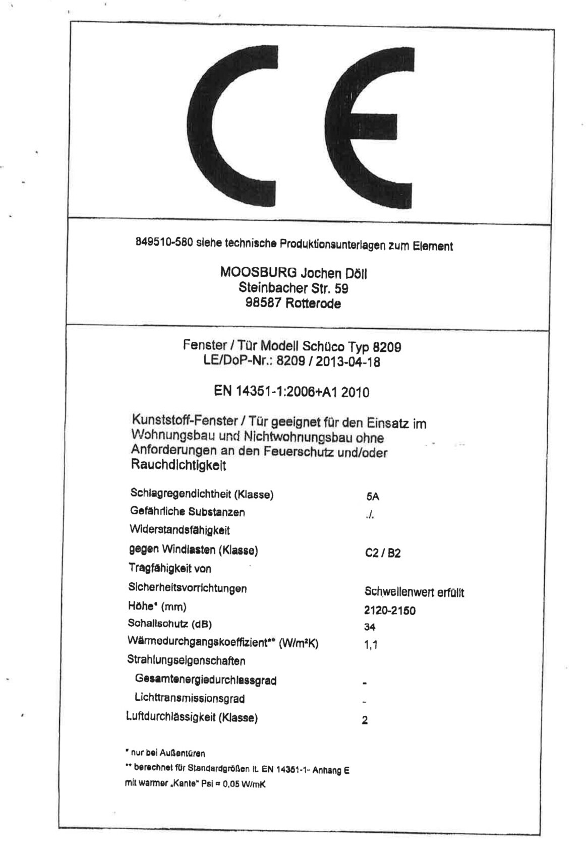

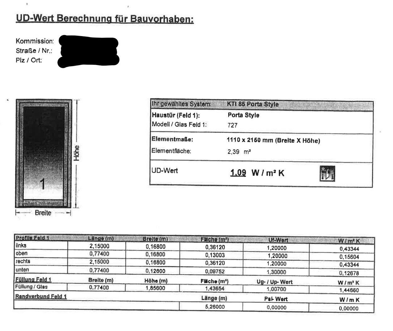

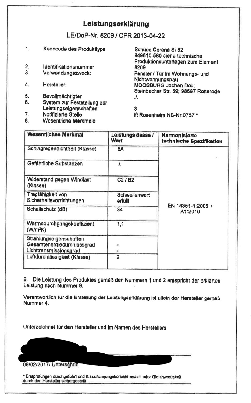

They sent documentation, which I have attached here. I am not sure if anything can be derived from it.

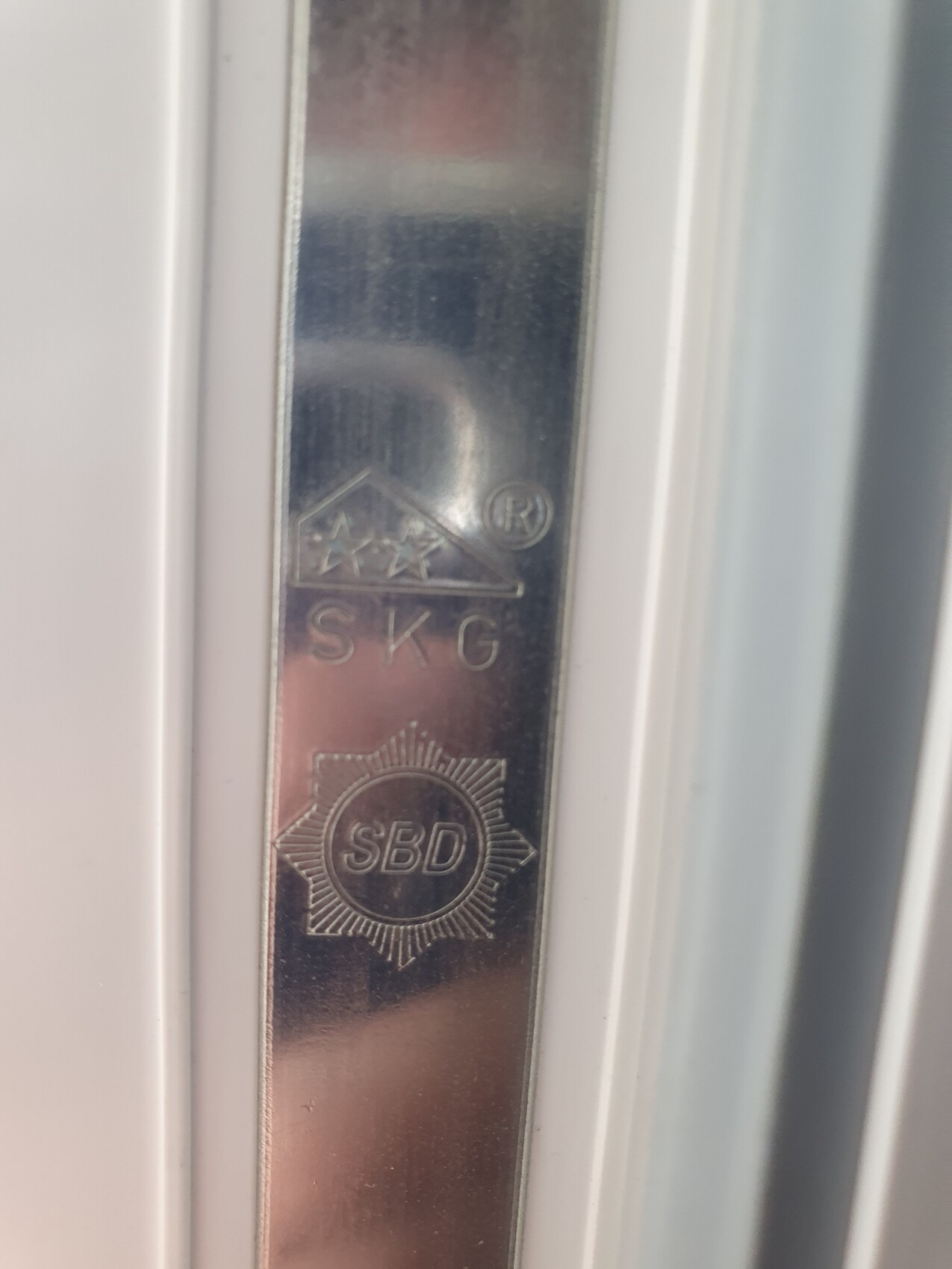

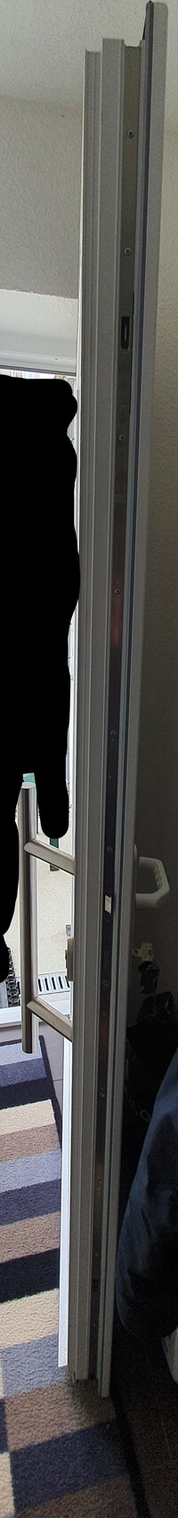

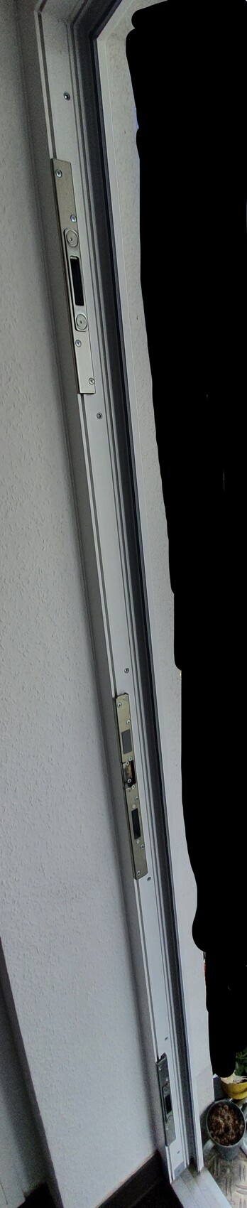

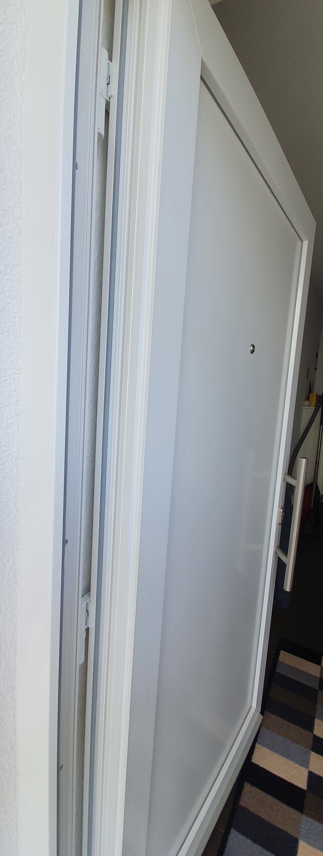

For the door, I cannot find any names or numbers. I am also attaching pictures of the door.
Since I have so far only seen this door on many garages of houses, I am unsure if this door is really suitable. Especially in the morning, when the sun shines directly on the door and it is dark inside, you can slightly see the sunlight shining through as a "horizontal stripe."

Your door has a sound insulation rating of 34 dB, as stated in the document. This means that if a noise of 60 dB is generated, your door will reduce it by 34 dB. Naturally, you can still hear people talking in the hallway, so it corresponds to sound insulation class 2. Unless you specifically ordered something else, you received the standard version—unfortunately.
Whether it was installed correctly is another matter because if it wasn’t, sound will pass through. This, however, can only be verified with a blower door test unless you already notice a draft.

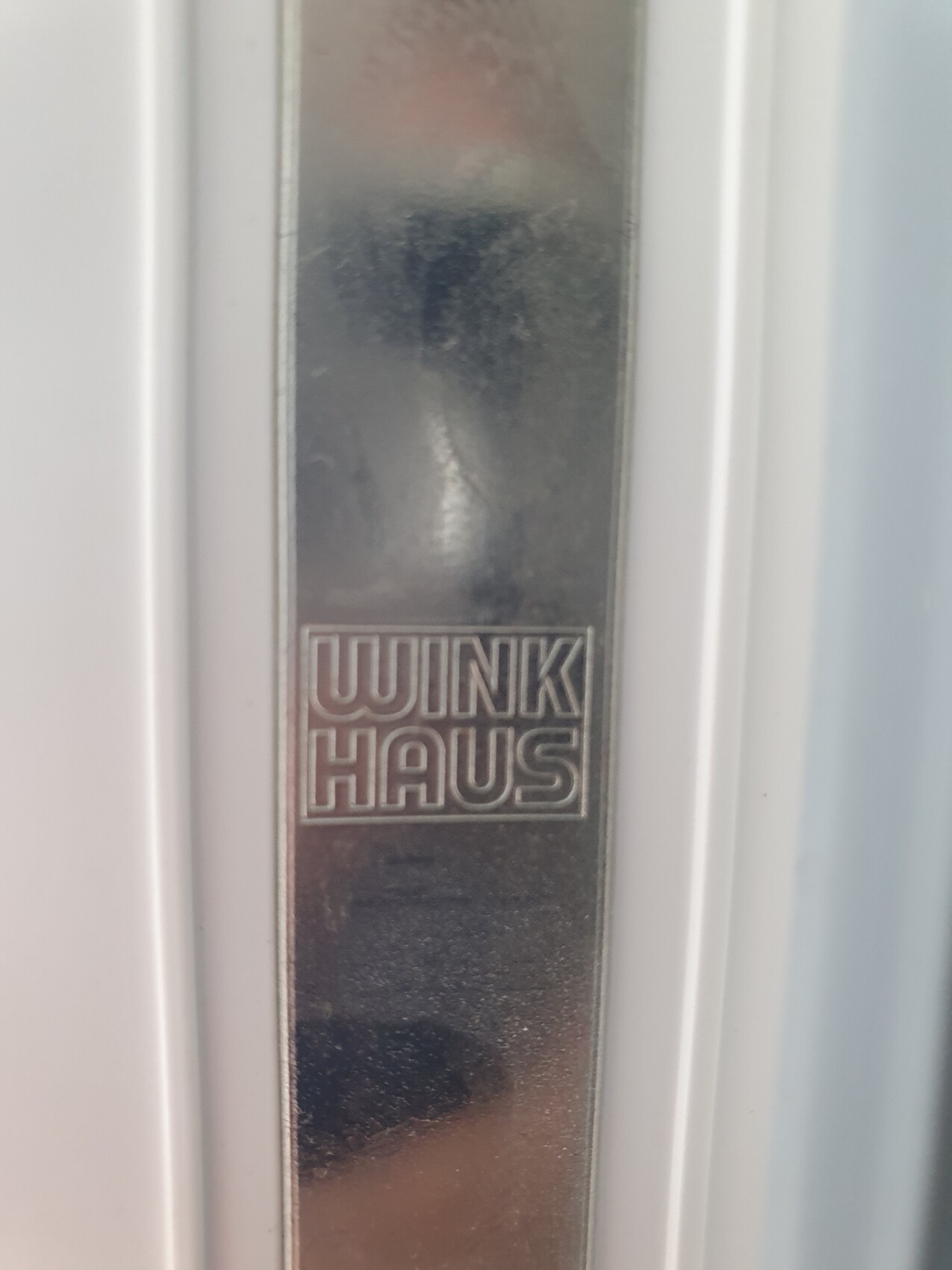

Generally, I assume that the door installed there is not the one specified, or isn’t it typical for manufacturers to print their company name and possibly some kind of serial number on regular doors?
