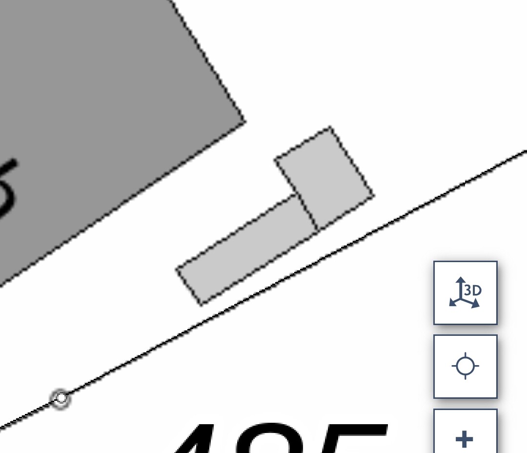

buttyhome17 Feb 2025 18:54Phew, I’m not sure right now either. Maybe drugs...? I hope the euphoria comes back once everything is finished. For now, it’s about holding on for two years.
What’s the best way to find out? Just ring the doorbell and ask? I think it belongs to the neighbor.
K a t j a schrieb:
The south wall – is that yours or the neighbor’s?
buttyhome schrieb:
How is the best way to find this out? Well, first of all, it’s best to look for the boundary stone or better yet, boundary stones, if there are any.
From my experience: They are usually marked as “present” on the cadastral map with a point at the corner. If they are shown on the map, there is almost always a boundary stone. In our case, they were all there, although finding them wasn’t always easy. (The surveyor located them).
The rest is simple. If the wall stands on your land, it’s assumed to be yours.

Just ring the doorbell and ask? I think it belongs to the neighbor. That’s always a good idea anyway. Even if the wall is on your property, there are often exceptions, especially with older plots. Plus, it’s a good opportunity to get to know the neighbors and to (carefully) introduce yourself and your plans, ideally with a small gift. You want to make a good impression. A bottle of wine is always appreciated.

buttyhome17 Feb 2025 19:34K a t j a schrieb:
As I understand it, they are usually marked as "existing" with a dot in the corner on the cadastral extract. The wall is clearly on our property. What a relief!
Of course, we will introduce ourselves politely before starting. This should last for many years, and construction next door can be quite disruptive. Without the wall, a lot will surely change visually on the neighboring property...

I roughly get 3.52 x 6.70 m (11.5 x 22 ft), That’s nothing, that can’t be right, can it? @ypg Yvonne, do you have measurements like that too?
buttyhome schrieb:
The wall definitely belongs to us. What luck! Well, that sounds good at first. But as I said, first make sure it really belongs to you. Also, you need to check what would happen if you removed it. I would probably only reduce the height enough so that it reaches fence height in the garden, if that’s possible. How deep is the thing? Is it right on the property line? What the excerpt shows looks more like a block than a wall? I’m confused.
