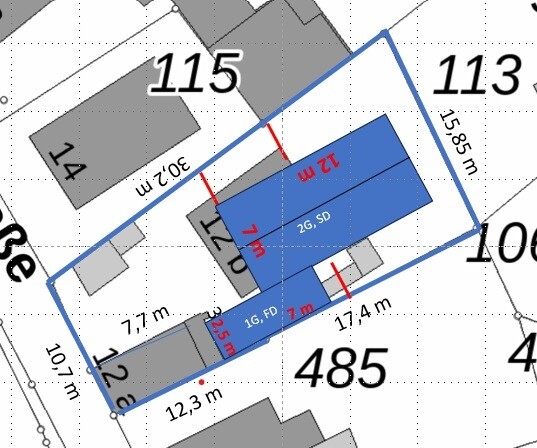

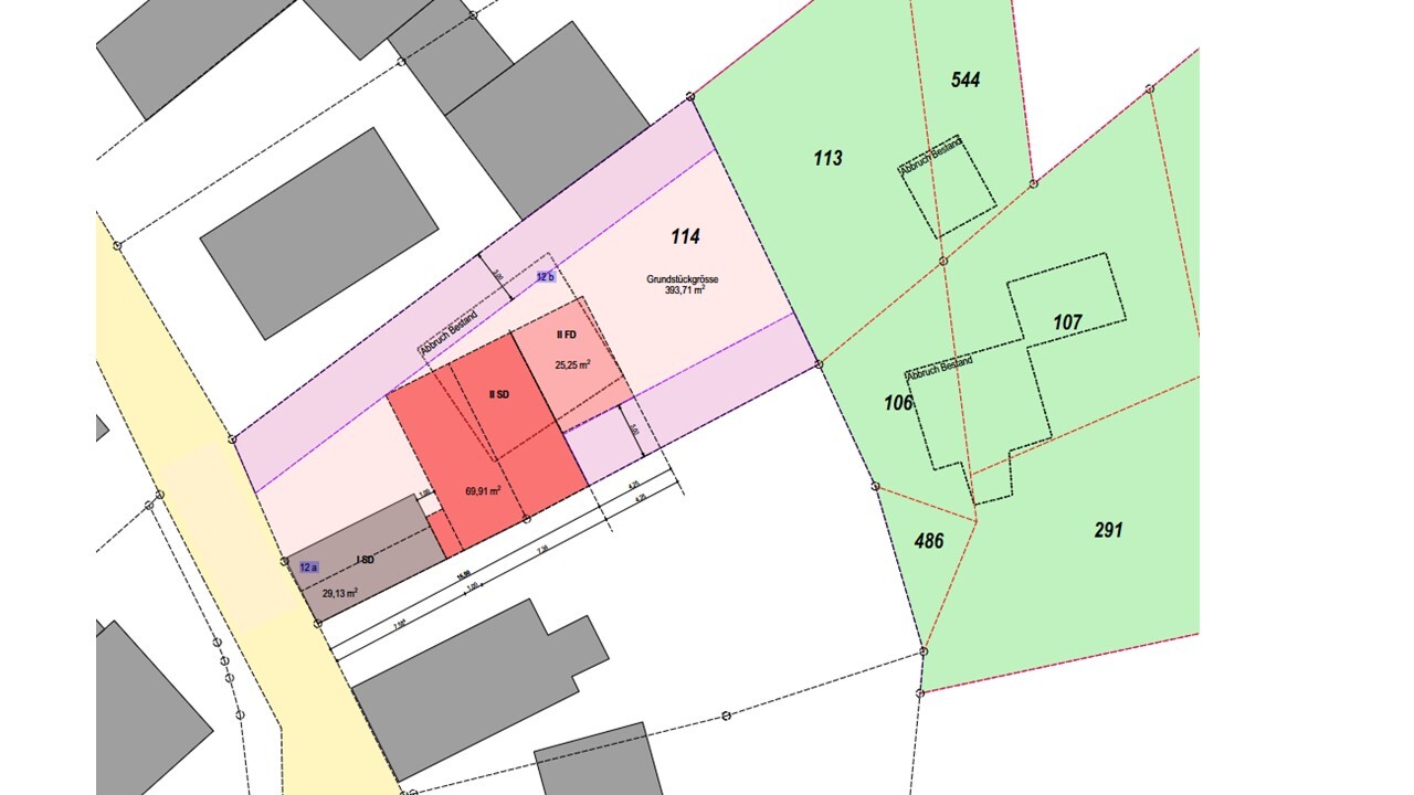

Here is the architect’s first concept. She assumes basic buildability including edge development and therefore wants to place the new build with the eaves side directly adjacent to the neighbor. I would prefer a longer joint/gap, but that would make the edge building length disproportionate. I find that unfortunate as I would like the new building positioned further back in the plot to create a larger front courtyard. This is the first idea currently being checked for feasibility by the building and monument authorities:
The extension toward the garden is optional and designed with a flat roof.
My idea would be to extend the building joint further, placing the entrance and cloakroom there, with the new building accessed above. This new building would be rotated to face with its gable. Because it would extend far into the slope, the ground floor would effectively become a basement, and the upper floor would have direct garden access at ground level. I would also need to encroach on the neighboring boundary, but I imagine this might be simpler as I am only planning a single story there. Would the house then have enough windows? You don’t want to orient large window fronts too much towards neighbors, but at least toward the garden I would like to have a large gable window area.
Thank you very much for your suggestions! What do you think is feasible? What are the pros and cons?

buttyhome16 Feb 2025 23:10K a t j a schrieb:
What are the exterior dimensions of the monument?I roughly calculate 3.52 x 6.70 m (11.5 x 22 ft), which fits quite well with the plans from @ypg . His site layout and building design match my idea very closely. However, a lot of earthwork would be required. But with the floor area, I think I could definitely accommodate all our requirements.Once we have more information about the possible development, the next step would be a soil survey, right? Just so I better understand how the architect approaches this.
buttyhome schrieb:

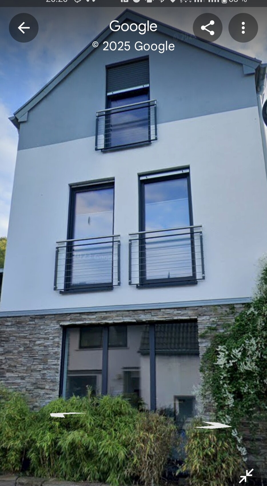

The closed building style in the neighborhood is always single-story, as far as I can see. So, building on the boundary might possibly mean a stepped upper floor. Freestanding, it could also mean two stories.

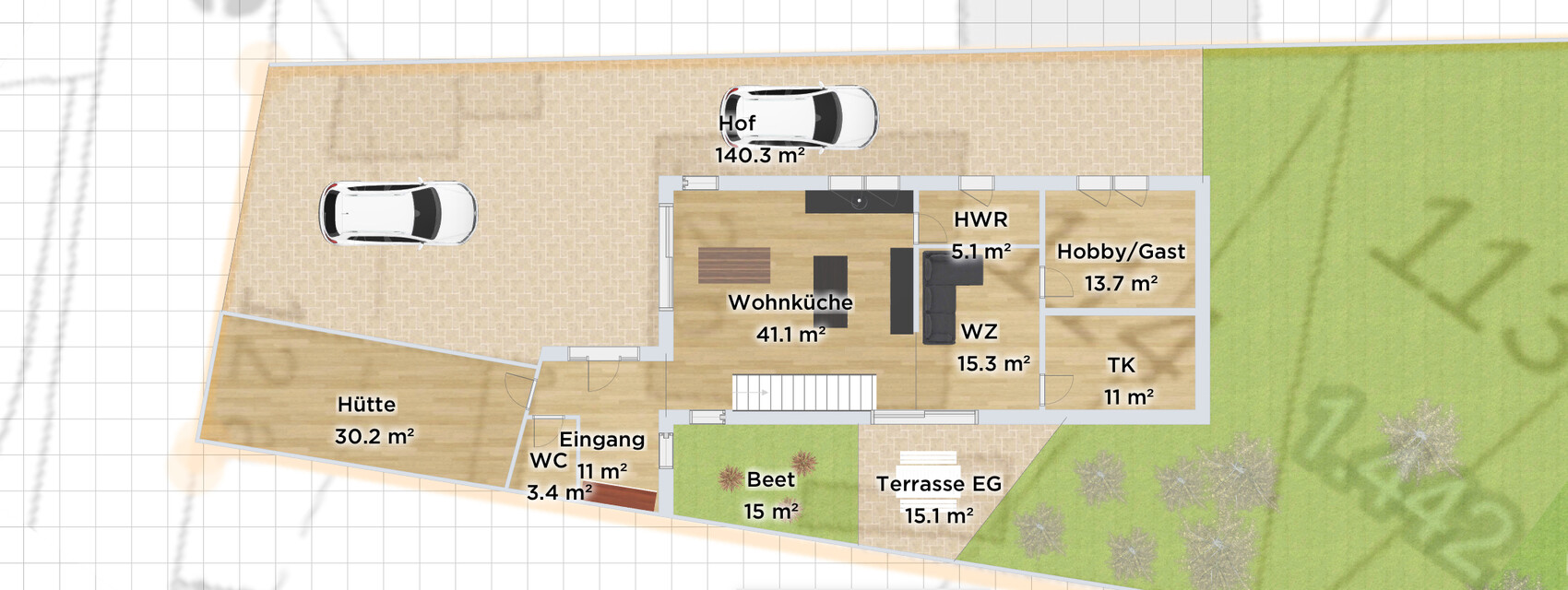

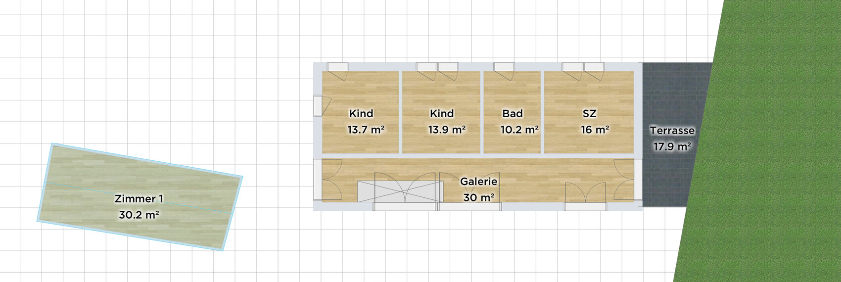

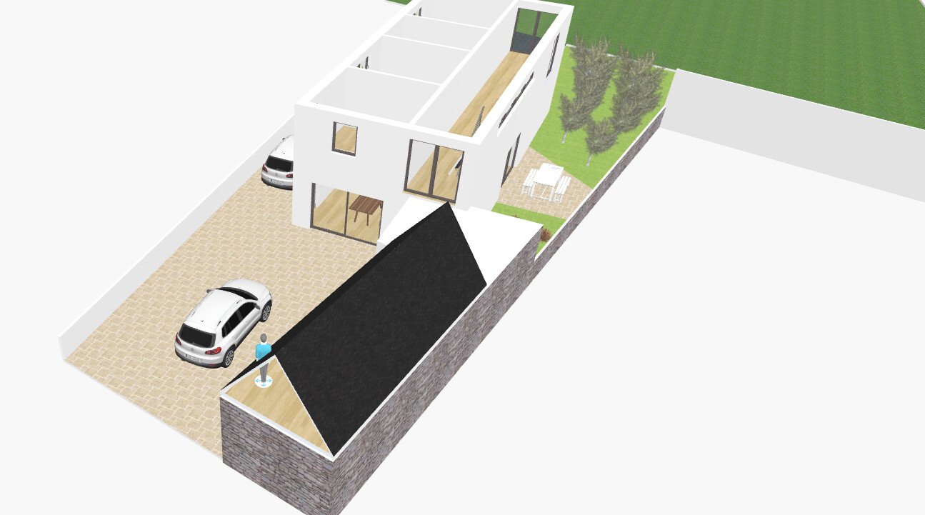

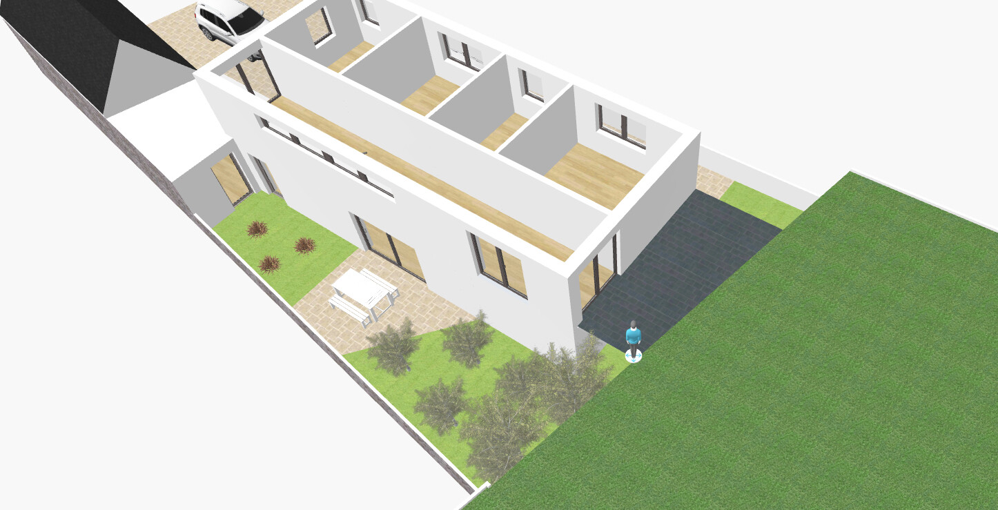

I quickly put this together with my software, which doesn’t handle slopes (so please disregard software errors):

With its floor plan By the way, this is Yvonne.

The first question would be: what remains after clearing everything? Or do you leave part of the structure as support? I wouldn’t be in favor of keeping old structures in this case. Too much old material.
I could imagine you might build again in a similar way to avoid moving so much earth. So, two stories at the front and only one story plus a roof at the back, but this time built as a single unit. That will be quite tall, but you did want the view. I do have some doubts about the rear building due to the distances to the neighboring property.

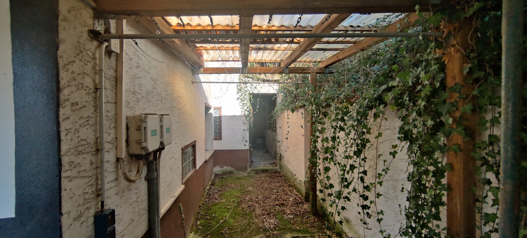

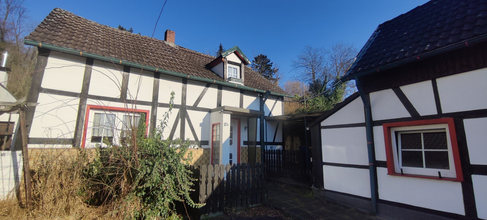

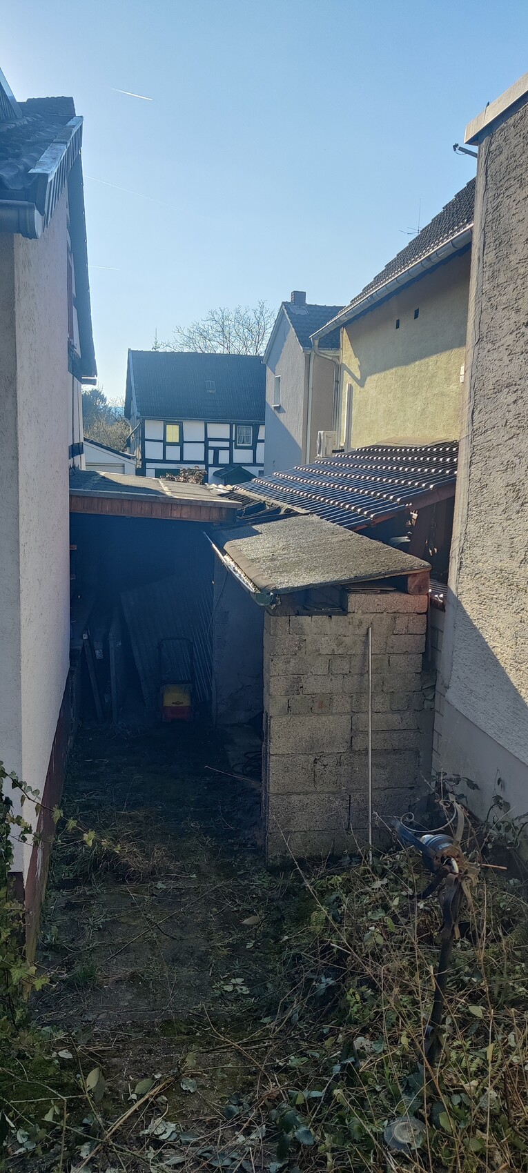

How large is the footprint of the house to be demolished?The footprint is almost exactly 60 sqm (645 sq ft).The sun was shining today, and I visited the site again. The photos were taken at 3:45 p.m. Actually, I was somewhat surprised at how much the house is built into the slope. I never noticed this at first. The plot especially seems to lie significantly lower compared to the southern neighbor. I think that’s a retaining wall, not just a boundary fence. Unfortunately, I can’t get a good view onto the neighboring property. @ypg At first, I found your small terrace on the south side very charming! But I can’t stand this prison-like wall right in front. I’m curious if it would be possible under building regulations (building permit / planning permission) to extend the connection between the listed building and the main house and thereby place your terrace one floor higher on the roof. Then it could be really nice. What do you think?
Now the views: just before 4 p.m., the sun reaches the courtyard facing the street. There isn’t much traffic, but you’re naturally very visible. If the courtyard is nicely designed, for example paved with large pots framing the seating area, it could be really attractive:

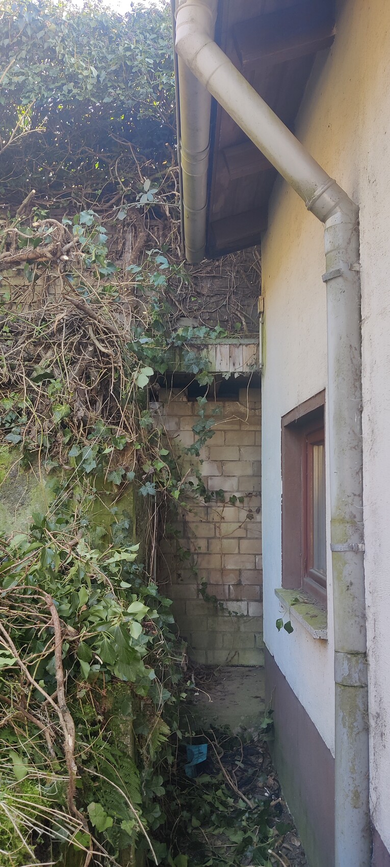

Now let’s go through the gate on the right. I think the wall on the right side (at least in the rear section) also supports part of the neighbor’s slope. The south terrace was planned here, but unfortunately, that won’t work.
Here’s the rear part of this suspicious wall facing the neighbor’s plot to the south (I’m standing behind the house looking directly at it):

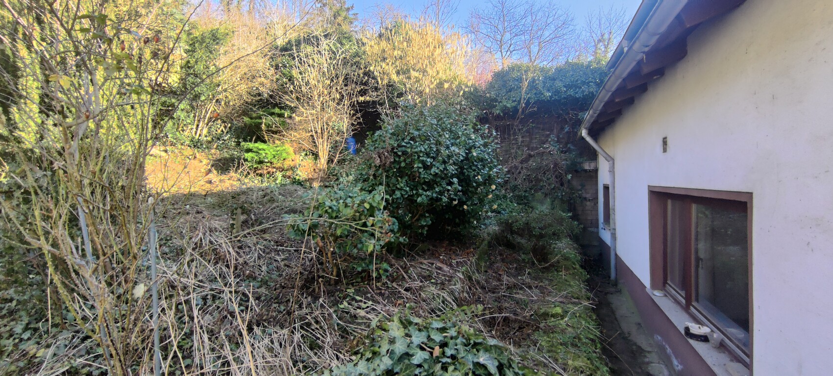

The view in the same direction behind the house. Obviously, the slope was excavated for this extension. A shame. But the “basement” could be placed here; the first floor would then end higher. This is also where the sun begins (well, a taller house means more shade):
At the back of the plot, the barrier to the neighbor is thankfully no longer so high (but still there, as seen from above):
