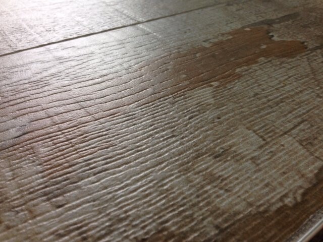

...No! That might be true for DIY store products and cheaper floorboards. The more expensive ones have a textured finish that imitates natural patterns.
If you call that a dirt collector, you probably don’t understand the concept of tactile feel.
Here is a tile that isn’t from a DIY store but is rather in the mid-price range for wood-look surfaces:
