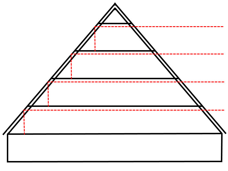

Where did you get the two-thirds from? The regulation refers to 3/4 of the respective floor’s footprint.
Section diagram of a stair floor plan in a pyramid-shaped house with multiple levels
This is also a single-story house in NRW.
The zoning plan can, of course, include many other requirements that may prohibit this, such as eave and ridge heights, floor area ratio, and roof pitch.
