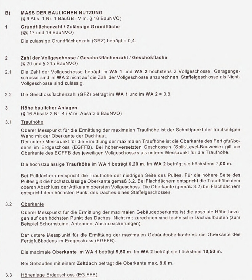

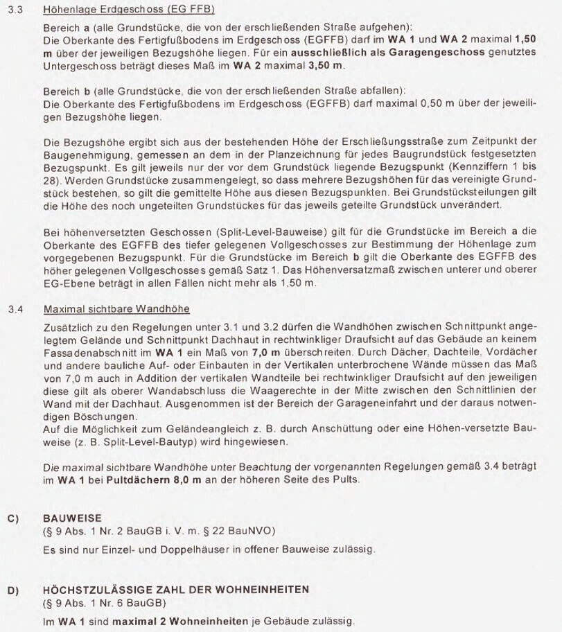

Good evening, we are planning to purchase a plot of land and since it is on a slope, we are considering a building with a basement, ground floor, and recessed top floor, so 3 levels in total—2 full floors and 1 recessed floor.
As we have not yet contacted an architect and unfortunately do not fully understand the zoning plan, it would be great if someone here could take a look at the excerpts from the plan to tell us if this would even be possible.
It is not clear to us whether the ground floor level would then be in the basement or at street level.
Thank you in advance.
We look forward to all replies.

Somatra schrieb:
For us, it is not clear whether the ground floor would then be in the basement or at street level. Not for us either without a complete development plan.
Somatra schrieb:
We have no contact with the architect and unfortunately do not fully understand the development plan, Somatra schrieb:
so area b To answer your question, a complete development plan is required, which a) includes the text (which you have provided) as well as images... and b) the site plan – which you have not provided.
Your question
Somatra schrieb:
whether this would even be possible. cannot simply be understood or answered without these.
hanghaus202314 Jun 2024 12:46Somatra schrieb:
Here is a quick sketch illustrating the issue.The site plan for the development plan answers exactly the questions shown in the sketch. Unfortunately, you don’t want to share it with us.Similar topics
