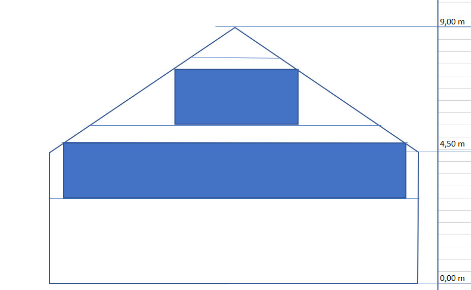

In my opinion, it is definitely possible to build as desired. For example, like this:
House sketch: large blue rectangle at the bottom, medium blue rectangle, pointed roof with dimension lines
Ground floor, for example, 9m * 13m (30ft * 43ft)
The blue boxes represent the 2m (6.5ft) usable height.

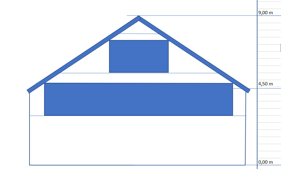

Correction:
Unfortunately, I forgot the roof.
Cross-section of a gable roof house with two blue rectangles (large at the bottom, small at the top).

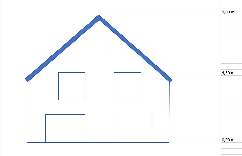

If you keep the study rooms modest, then 10 m (33 feet) and a slightly steeper roof will work as well.
Schematic house with a blue gable roof, several windows, and a door.
OK, the window corresponds to the 2 m (6.5 feet) line.
