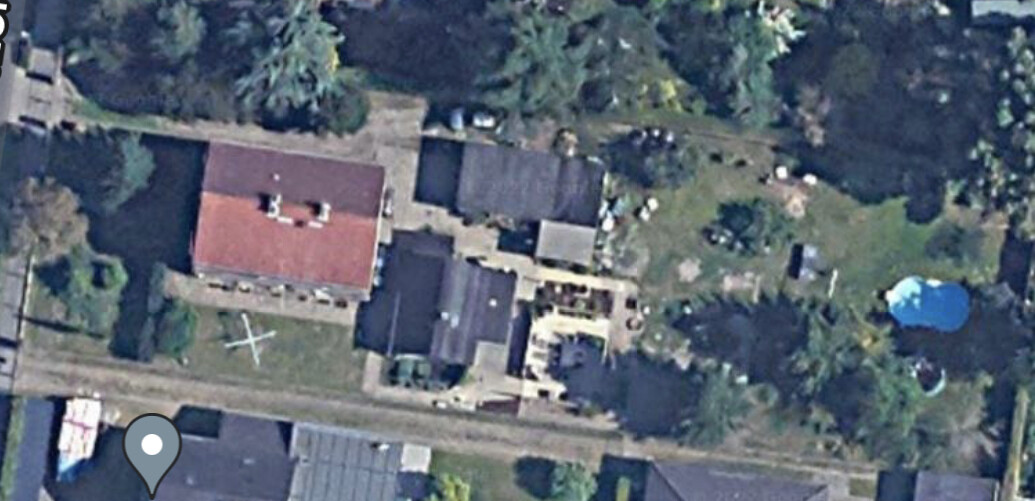

Buddy05051 Oct 2022 13:38Hello everyone,
we are planning a construction project on a second row plot.
What do you think the costs would be for about 35m (115 feet) of utility connections? That means expenses for water/sewage/electricity/internet including groundwork and the construction of an access road for vehicles and a crane setup area. (in Berlin)
I have a figure in mind and would like to check if it’s roughly accurate.
Buddy05051 Oct 2022 13:48Everything should be handled by the utility providers. Construction access road by an external company. Hopefully within 40,000 (currency not specified).
Buddy05051 Oct 2022 13:52I would estimate it like this:
Drinking water: according to the water utility rate sheet (roughly 1500€ + 160€/m = 8400€)
Wastewater: similarly, about 3500€ + 340€/m = 15400€
Electricity: about 1000€ + 100€/m = 4500€
Internet: lay conduit when installing electricity = 150€ + 800€ for telecom.
Construction road 25€/t including installation (?), I estimate 2t/m (?), plus parking space --> 2000-3000€ (highly dependent on the civil engineer).
So you could reach that.
If you can place the electrical pedestal and the wastewater and drinking water shafts at the property boundary by the street, you can probably save a lot.
Does the slope for the wastewater line fit?
