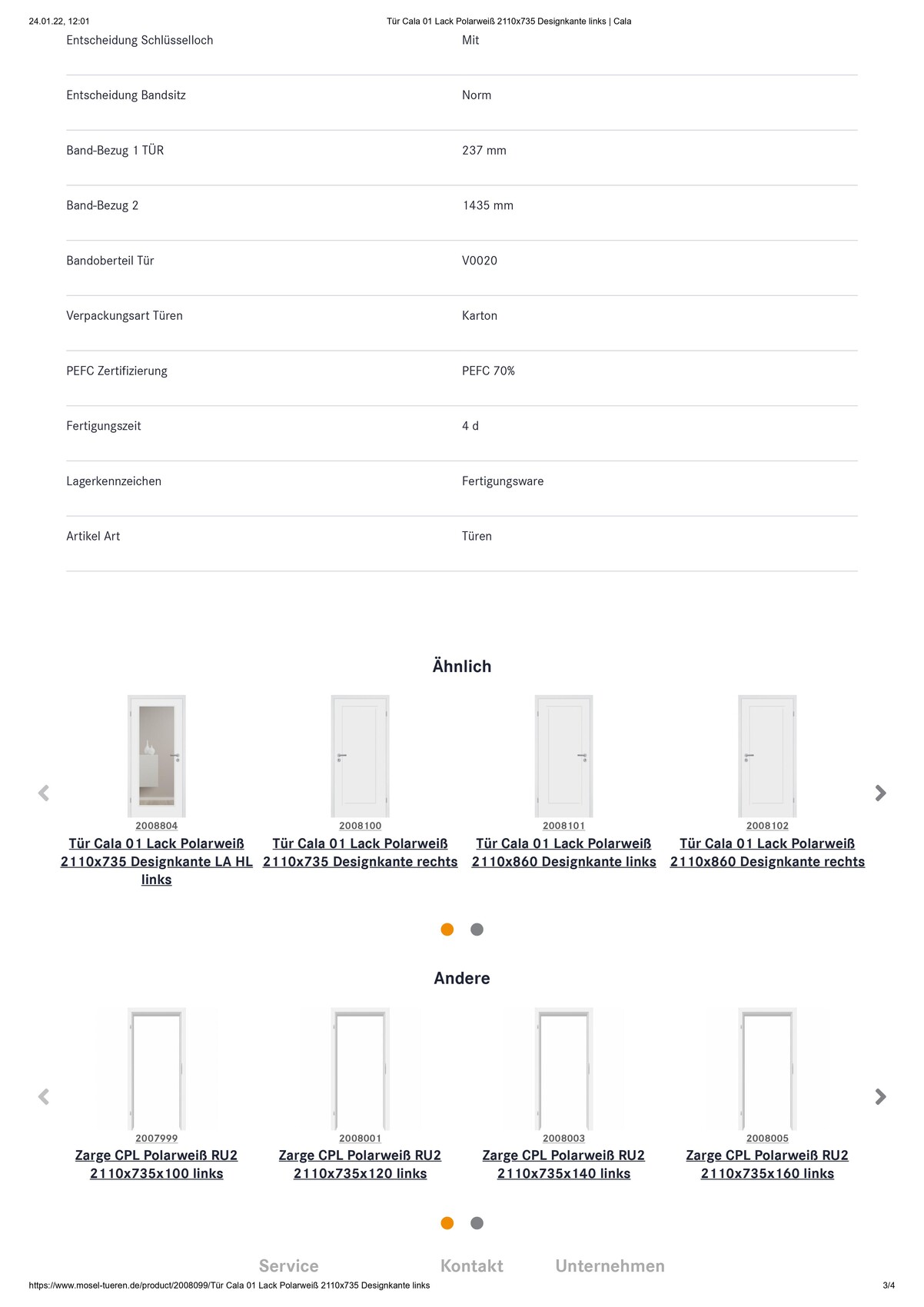

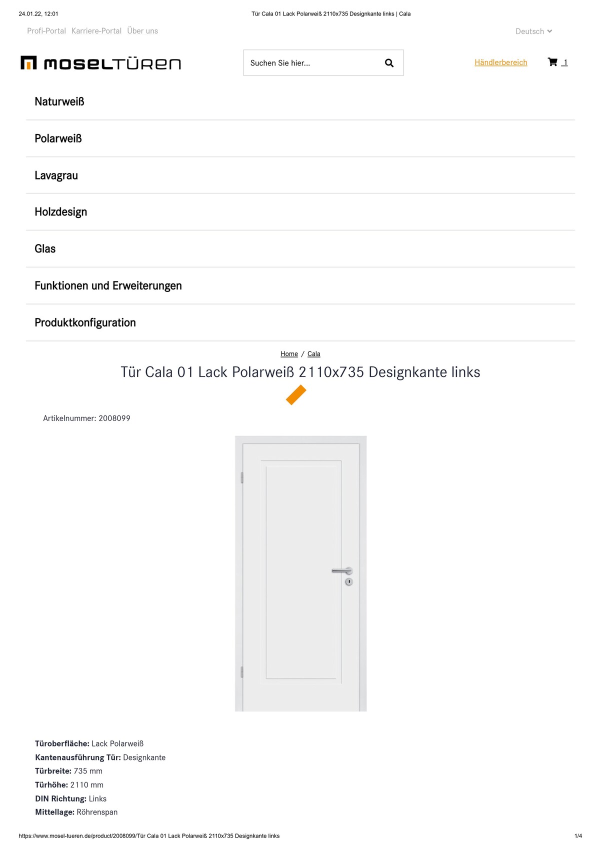

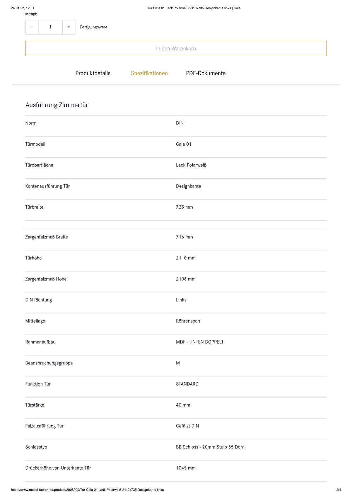

In the next few weeks, we plan to install the flooring and then fit the doors and door frames (in that order). The doors have been ordered but have not yet been delivered.
Now we are wondering at which point we should place the floor transition strip so that it will later be exactly under the door leaf.
Is it possible to calculate this based on the door and frame measurements? I would need to know how far the future center of the door leaf will be from the wall.
The door is the Mosel Cala 01.
Attached is the datasheet from the website.
Maybe someone is familiar with this.
Regards,
Simon
White interior door Cala 01 lacquer polar white with design edge left, door handle right.
Room door Cala 01, lacquer polar white, dimensions 735x2110 mm (29x83 inches), DIN left
Product page: door Cala 01 lacquer polar white with specifications and similar doors.

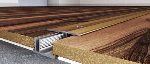

Something like this is, for example, (visually) not acceptable:
Cross section of a wooden floor with planks, underlay, and metal profile.

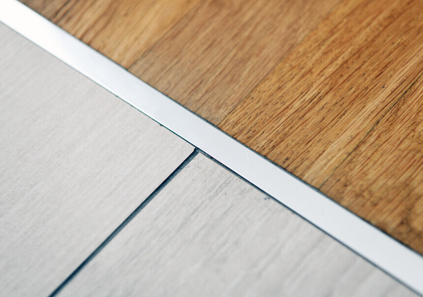

This would be better:
Transition between two floorings: light gray laminate next to brown wooden floor with silver metal strip

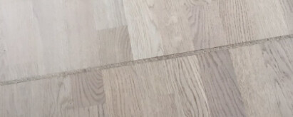

Or simply like this with cork:
Close-up of a light gray wooden plank floor with grain
