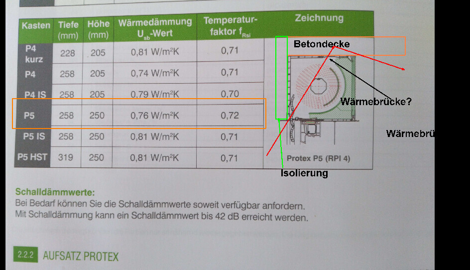

Thomas198013 Aug 2018 21:06Thank you for the responses. I have attached the external roller shutter box from the window manufacturer here. In your opinion, should I be concerned about the thermal bridge that theoretically forms between the shutter opening and the non-insulated upper part of the roller shutter box towards the ceiling?
