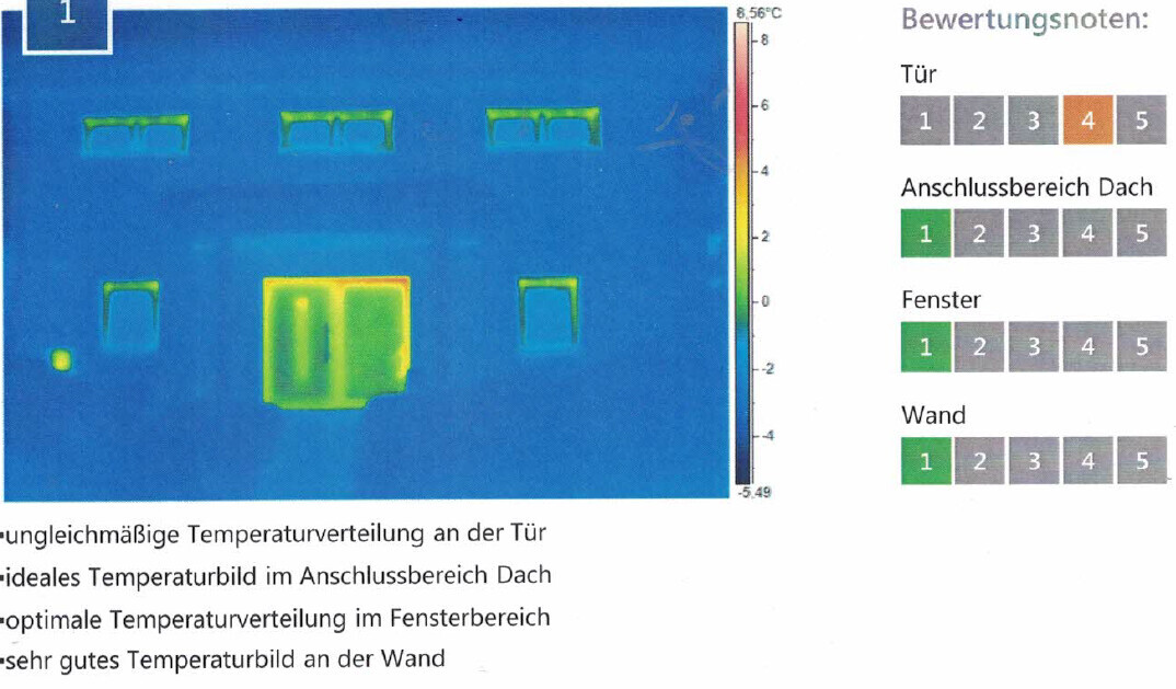

Hello everyone, here is an interesting example of a common weak point. It is highly recommended to check this.
Thermography of a building with color scale and temperature distribution on door, roof, window, and wall.

Wow, there isn’t any tape in there at all? It seems to be a significant leak that could have been detected right after installation.

Buy one. But it’s better to check the connections right after installation, otherwise those barn door-like gaps are noticeable.
