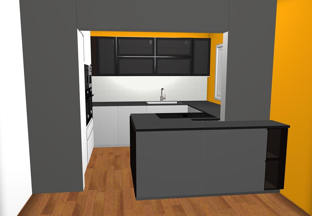

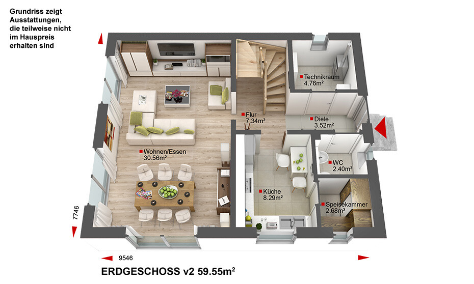

The kitchen is not open. A G-shaped kitchen is not open.
I’ve attached a kitchen design. For us, it would be open like that or at least have a nice connection to the dining area.
You would probably prefer a floor plan like the second standard layout of the model house (also attached).
Everyone has to walk through the quiet zone to get to the calcium silicate block wall. That’s disturbing with multiple people, for example in the evenings or when the kids’ friends are visiting. You will always be disturbed. Kids don’t stay small.
Once the kids are grown up, they go to work and are too tired for friends in the evening. Problem solved. 😎
Attach a separate wooden frame in front, with shelves and rods inside, and sliding PAX doors in front. I’m a woman, and if I have an idea, something like that can be done 😉
Sure, basically anything is possible. But since Danwood only builds cold roofs, I have the vapor barrier on the slopes, so I’m a bit unsure there. What would definitely work is building a self-supporting structure, perhaps as a custom closet or even better by modifying our PAX. We really like the idea and will probably go ahead with it.

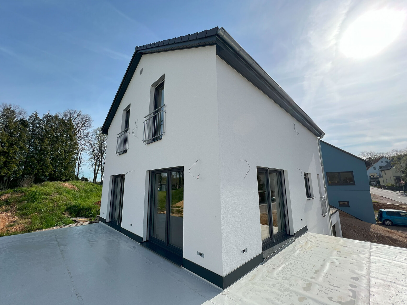

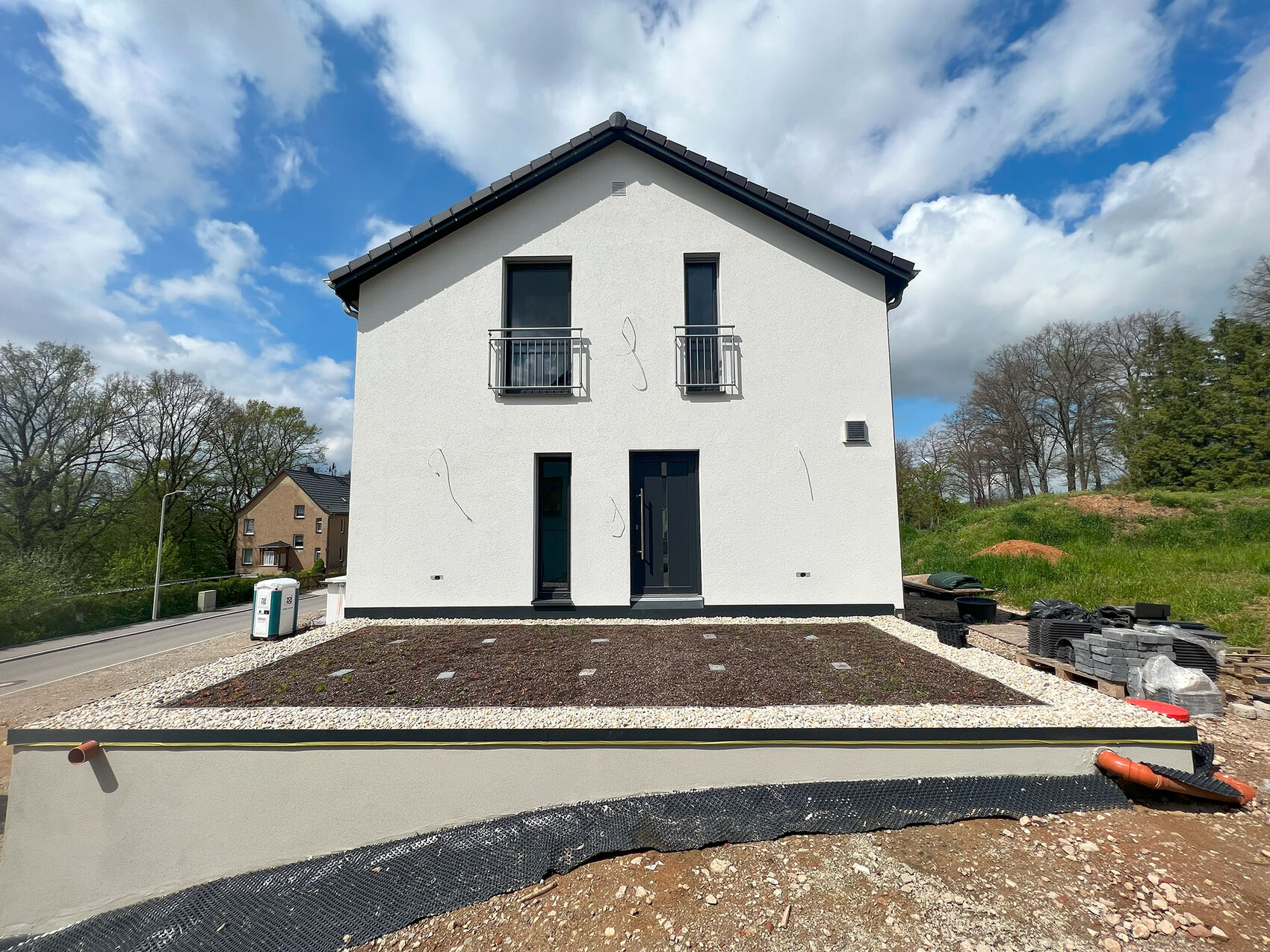

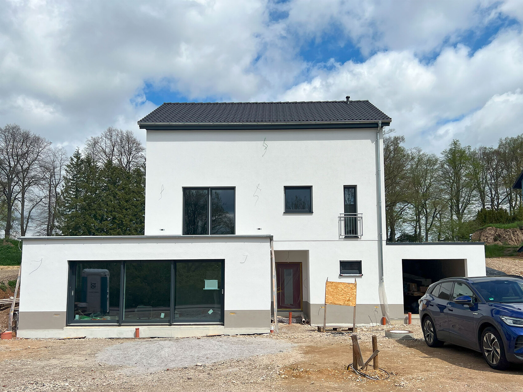

You’re right, I hadn’t gotten back to you. Here are some exterior views of the current status.
Once things are a bit more organized inside after the move, I will also upload some interior shots.
The separate apartment will remain unfinished inside for now – we’ll complete it gradually. In the end, we changed relatively little (or rather, could change). We left out the utility room in the separate apartment in favor of a spacious hallway/entrance area, where we hope the utility room functions can be integrated into the cupboards.
In the bathroom, we decided to skip the bathtub – but I don’t have an updated floor plan showing the new layout.
