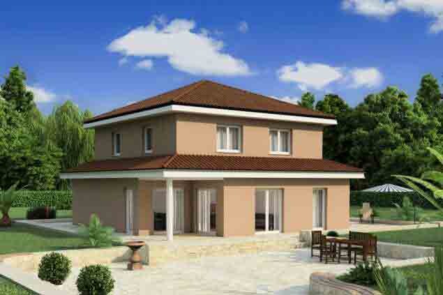

Bauexperte7 Apr 2016 11:05hb-julia schrieb:
Yes, the idea was a house with straight walls on the upper floor and as high ceilings as possible – and as a balance, to build a single-story extension on the side, ideally with an (unfinished) pitched roof used as attic space. Do you mean something like the attached example? Otherwise, please share a picture (with source) so it’s clear exactly what you have in mind.
Source: bbschenk
Regards, Bauexperte
Our house – see the picture – was originally planned as an urban villa with a pitched roof because we knew from the start that photovoltaic panels would be installed on it sooner or later. However, we absolutely wanted two full floors.
With some adjustments to the initial designs (for example, lengthening one side) and fitting it into a sloped site, the result was more of a traditional house – but still with two full floors. The back of the house, by the way, looks like a single-story building due to its position on the slope.
