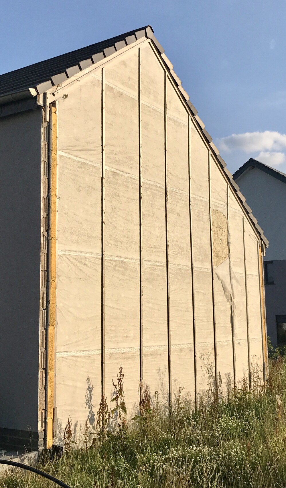

we own a detached semi-detached house that was completed two years ago. The neighboring house is still for sale and has not been built yet.
I am wondering if the party wall is properly compacted/sealed... Can anyone provide some information on this? See photo...
Thank you in advance.

Exterior wall insulation of a shell construction with insulation boards at the gable, roof visible

Alex85 schrieb:
Insulation absorbing water = bad, because wet insulation loses its insulating properties and can rot (depending on the material).
There should have been weather protection in place until the second half is constructed.

@11ant
Probably fleece-faced mineral wool, just a guess. On top of that, battens. Neither handle water well.
All one owner, but two years have already passed

11ant21 Jul 2017 23:00
Alex85 schrieb:
fleece-laminated stone wool, just a guess. Then battens on top. Neither of them are friendly to water.
Yes, it looks like that to me too. But also just a guess.

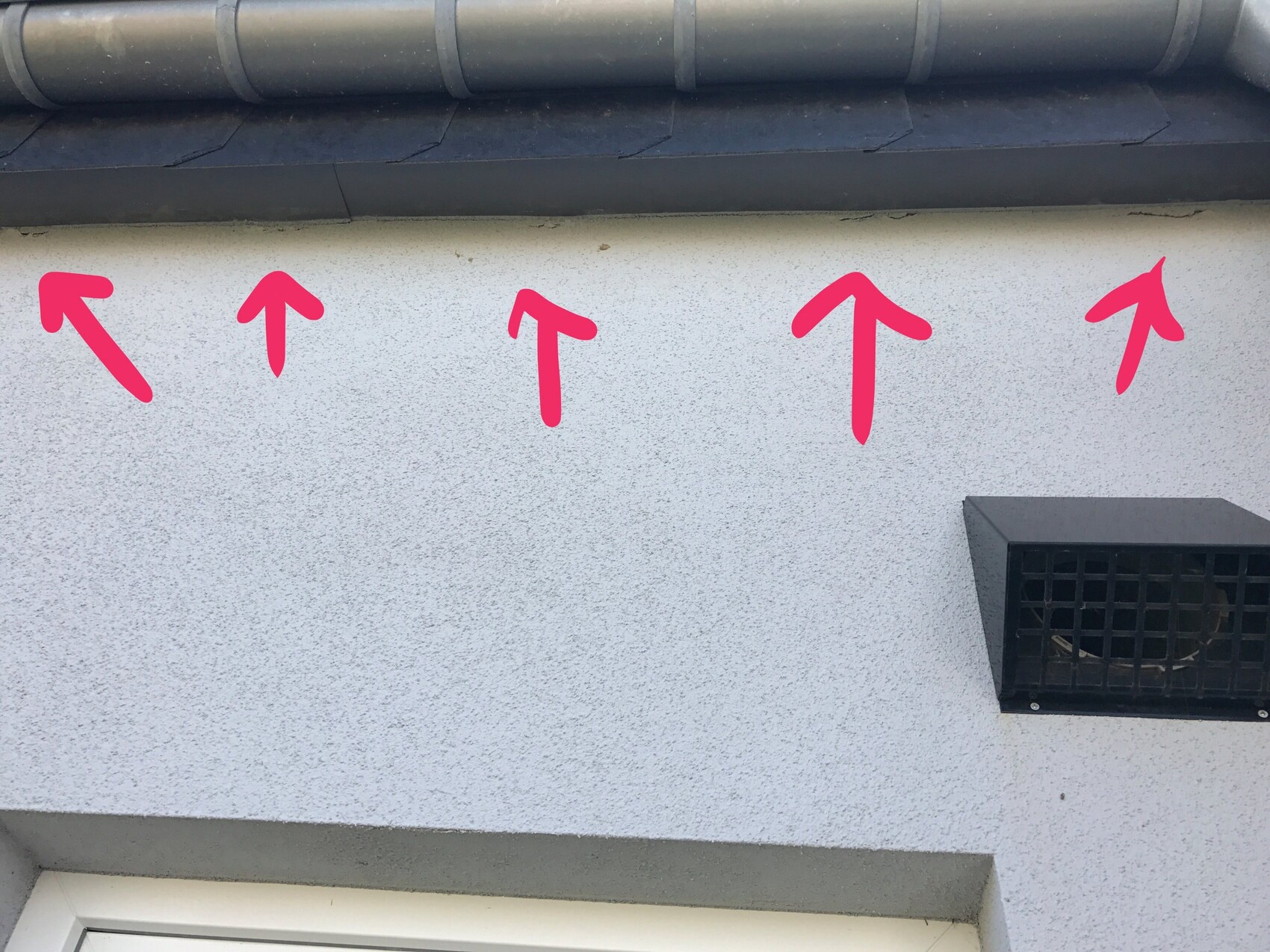

Thanks for the answers. I have now taken a closer look at the walls and noticed that in some areas, the paint is already peeling off on one side... Is this normal after 2 years?
Exterior wall with cracks under the gutter; facade damage.
