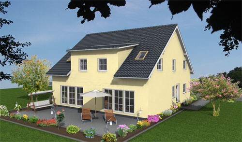

Again about the dormers. If I raise the knee wall, I either have the option to mount the dormer windows on the roof, which would result in smaller windows, or I can recess the windows into the roof, which would create longer window sills. I imagine it like in the picture:
Is there any objection to building the dormers this way?
That way I would be independent of the knee wall, right? Hmm, but then the front extension with the dining nook wouldn’t work anymore...
Sparfuchs_ schrieb:
Is there any reason not to build the dormers like this:
[ATTACH alt="efh-150qm-für-5-koepfe-336200-2.jpg"]36693[/ATTACH]
No, but that is the gable option, which is supposedly much more expensive.Sparfuchs_ schrieb:
