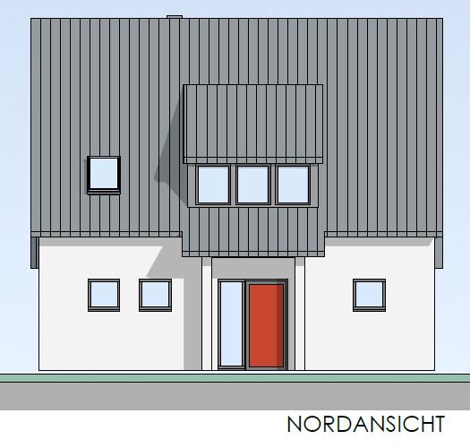

Zaba12 schrieb:
From my own experience, since we moved into 140sqm (living area excluding office and large hallways) + 70sqm cellar two weeks ago, you have too little usable space in the house for 5 people. We also have 4 bedrooms on the upper floor in case a third child arrives. The living area is also just about sufficient. For 5 people, if you subtract the utility room and office, you are left with 130sqm. At the moment, I find 140sqm quite comfortable for 2 children on the ground floor and upper floor, but with a third child it shouldn’t be any less. If a third child is really coming, I would recommend building a bit bigger. However, he is building with a fixed staircase to the attic. I think that will be enough.
But he is building a fixed staircase into the attic. I think that should be sufficient.Oh, I overlooked that! Where can I see it?S
Sparfuchs7723 Jul 2019 08:26Here are the views. I thought the dormers would be visible in the drawings, but looking at them again, they are actually easy to overlook. Sorry about that.
That’s how it was planned.
Bigger probably won’t fit the budget.
That’s right.
You can see it in the plans, and I already mentioned it. Does that change your statement, then?

Zaba12 schrieb:
Oh, missed that! Where can I see it?Mentioned several times in the initial thread and repeatedly in the discussion. Shown only once in the drawing. Sparfuchs_:P schrieb:
Here are the elevations. I thought the dormers would be clear from the plans, but looking at them again, they are actually easy to overlook. Then forget about the knee wall. There are also nice houses with a low knee wall, where the steep roof pitch and the dormers make up for it, like in this case.
Sparfuchs_ schrieb:
Here are the views. I thought the dormers would be clear in the drawings, but looking at them again, you can actually miss them very quickly. Sorry about that.
That’s how it was planned.The south dormers are huge. How much do they cost? Sparfuchs_ schrieb:
