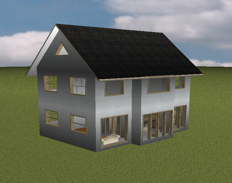

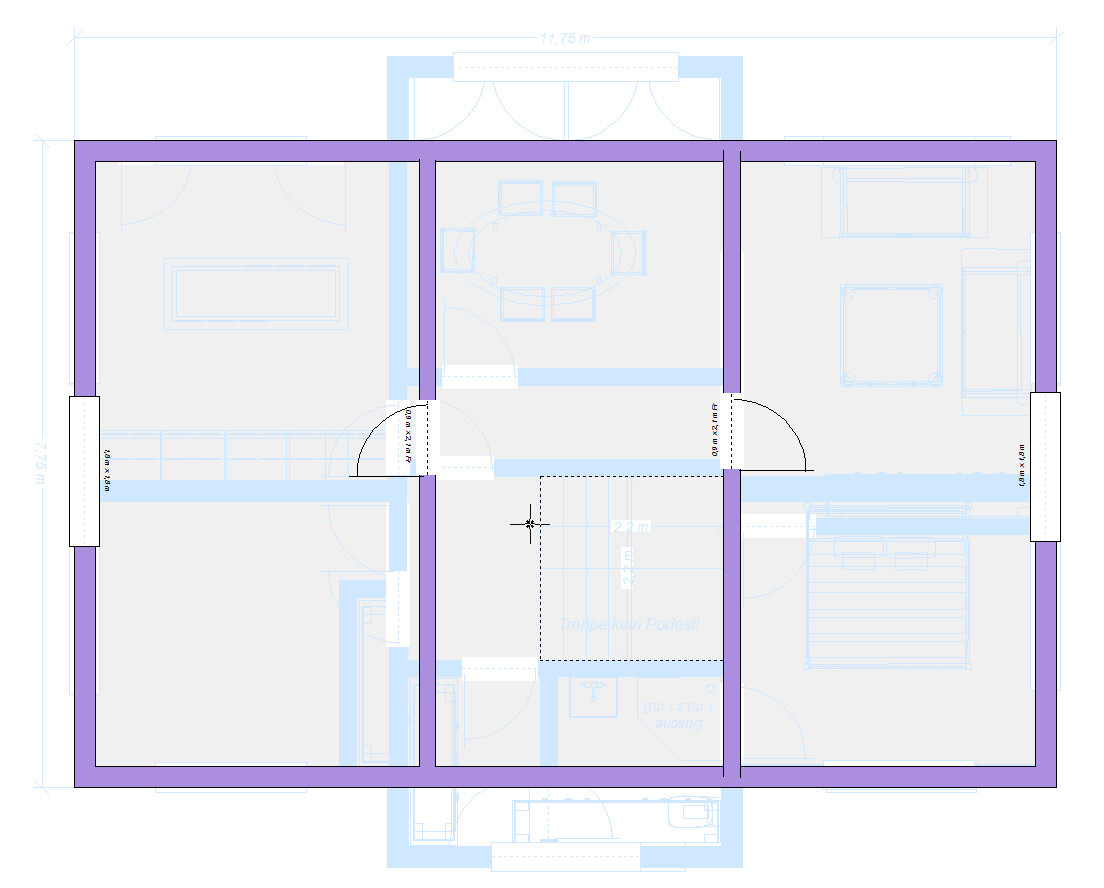

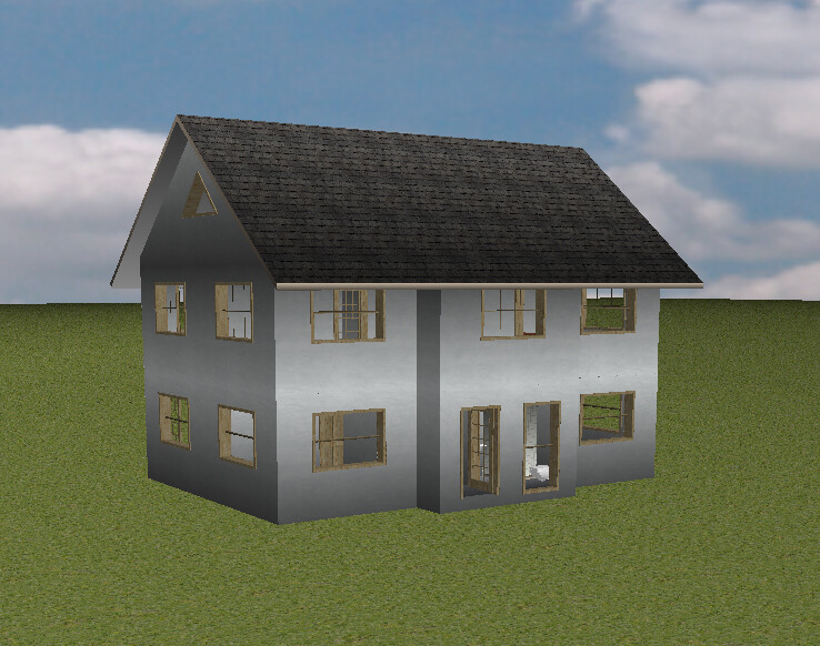

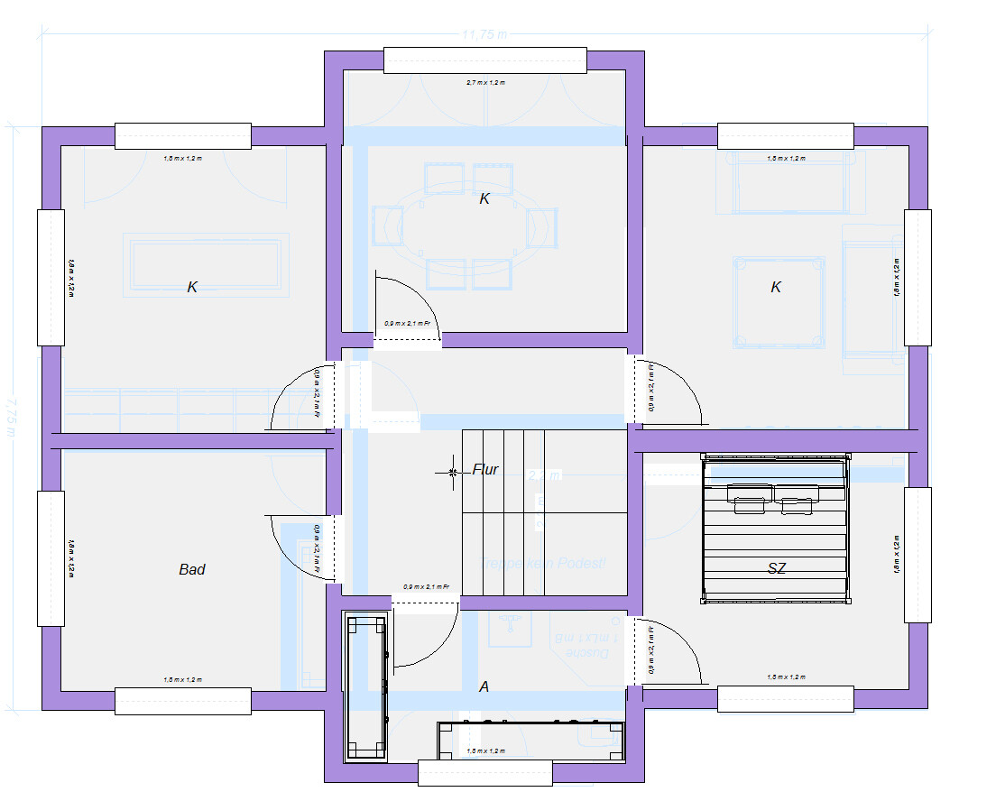

kaho674 schrieb:
I can’t happen to persuade you to build two stories? I have this kind of nice symmetrical design here. It would solve pretty much all problems, I believe. It’s a bit wider, but its footprint is just under your design. So far, it doesn’t include a chimney.
Cool, I’ll have a look at that right away!
Did my contribution #65 get overlooked by the OP? I would really be interested in the development plan and the architect’s explanations about the background of his unusual roof design.
Yes, that one slipped past me. Sorry! The development plan only allows gable roofs or hipped roofs, and a maximum of two full stories. As far as I saw yesterday, there are no further restrictions. I’d have to ask the architect what he intended with this. But dormers are off the table for now anyway.
Sparfuchs7725 Jul 2019 08:14@kaho674 could you estimate or read off the height and usability of the attic from your version with the two full stories?
I really like that version and will definitely show the design to my wife. It’s definitely quite a radical change ^^
I’ll give more feedback on this option later today once the boss has had a look :P

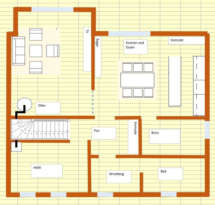

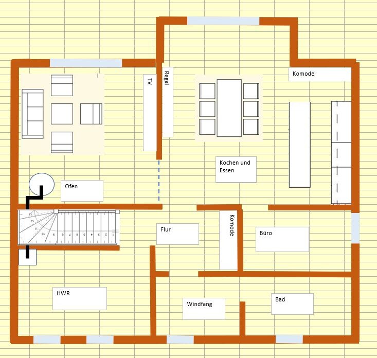

We really like your version that comes very close to ours. Especially that the staircase no longer intrudes into the rooms, making the upper floor more usable.
Regarding your second option, this is what we would like:
or like this:
We are currently torn between these three options.
or like this:
