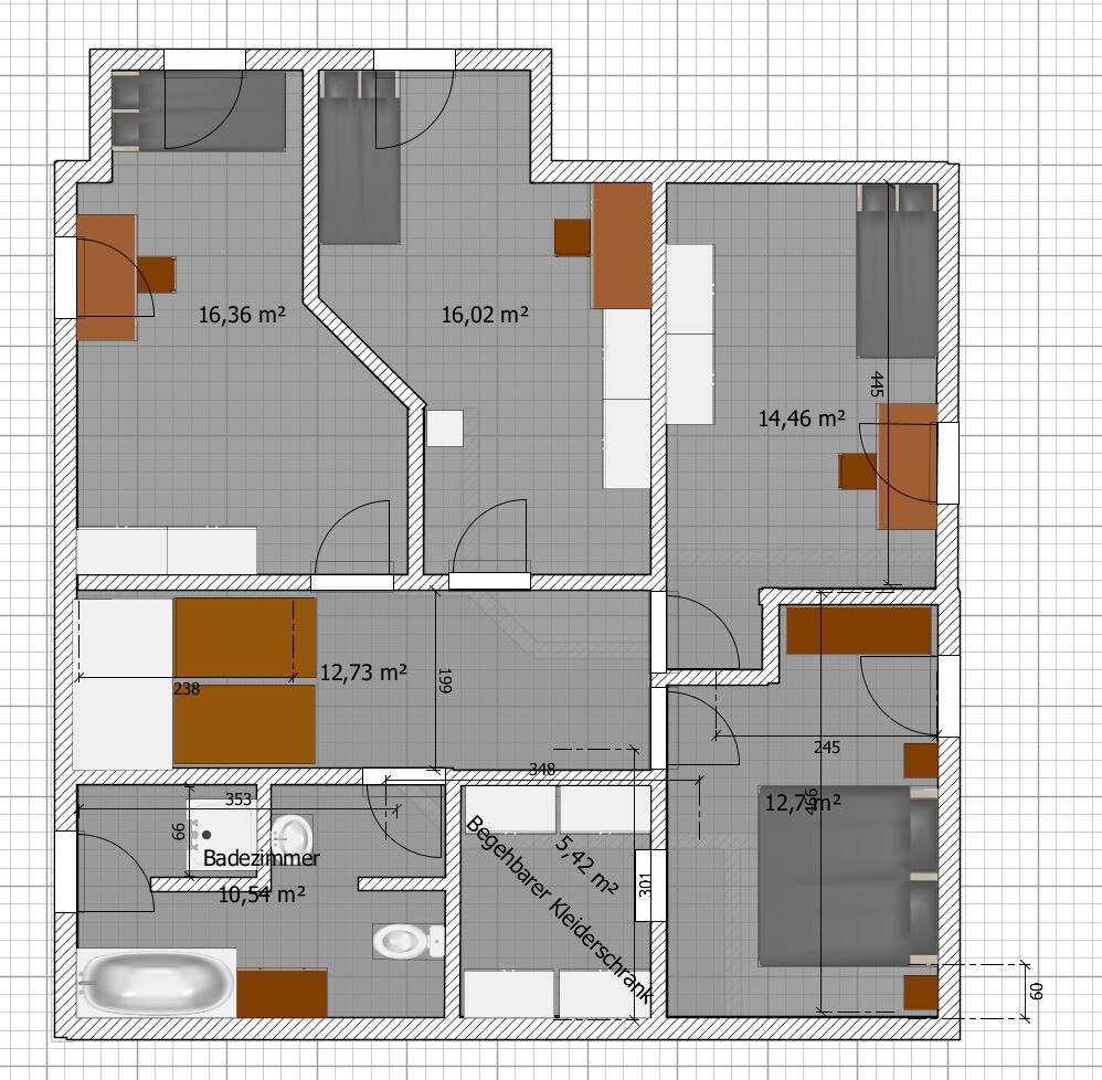

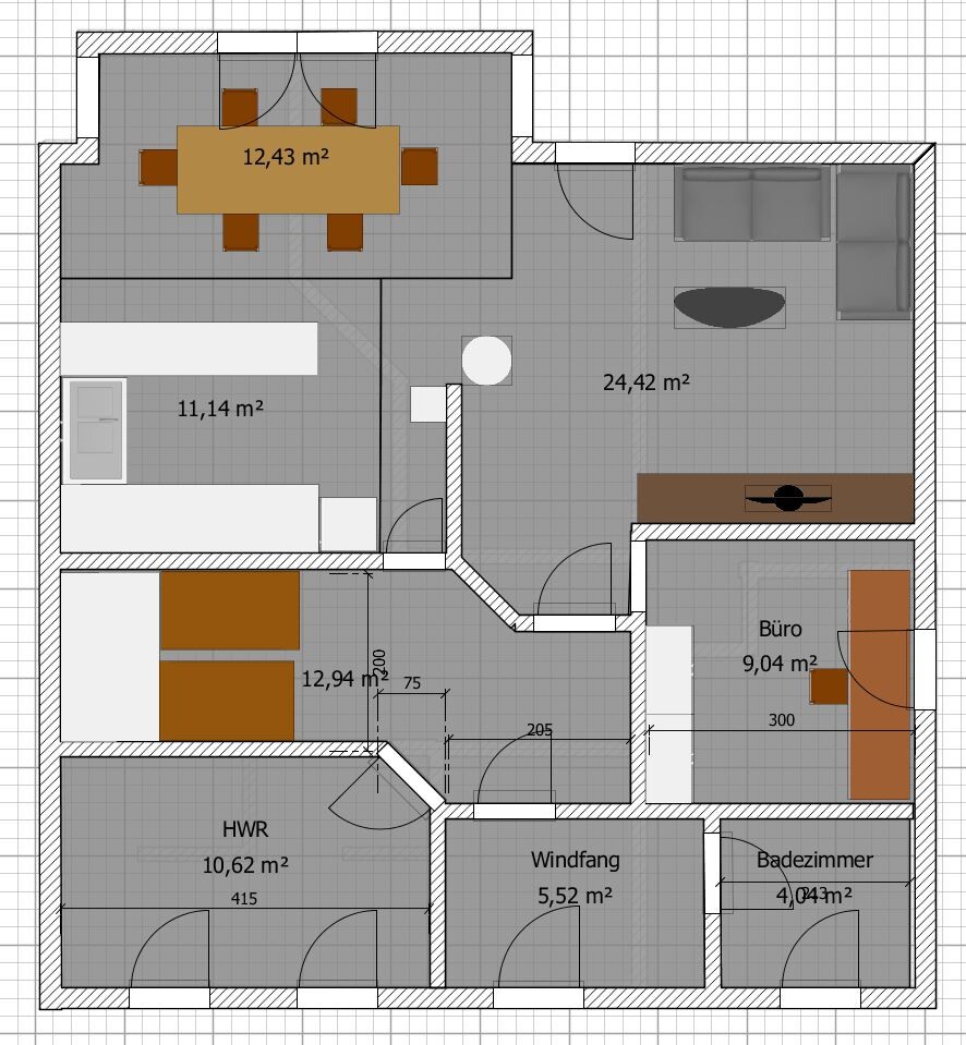

Sparfuchs7724 Jul 2019 00:08My wife and I have been working on this for a long time today. Of course, my original floor plan was changed too radically and was simply no longer "her floor plan." So we went back to our old layout. I hope it is at least somewhat better now ^^
I’ve spent quite some time tweaking it and still hope I managed to include most things. Feel free to give some feedback I make no claim to technical accuracy. Please consider it an amateur effort. The exterior dimensions have remained the same: 9.75m x 10m (32ft x 33ft) without the extension.
I mostly kept the old floor plan. I managed to move the stairs slightly upwards by adjusting them, which also allowed shifting the kitchen. The table no longer fits lengthwise, so the extension is a bit wider and the table is placed sideways. The table is 2.50m (8ft 2in) long. To solve the so-called “train station issue,” I made the kitchen a bit wider and narrowed the living room hallway to be able to fit a door leading to the kitchen. The utility room is 0.5 sqm (5.4 sq ft) smaller but no longer has the sloped ceiling from the stairs.
A lot has changed on the upper floor. Moving the stairs allowed me to completely rearrange.
- The children’s room is now on the south side
- The master bedroom has a walk-in closet with closets on one side measuring 1.3m (4ft 3in) and on the other side 2m (6ft 6in)
- The bathroom has become narrower and had to be somewhat rebuilt. I’m not sure yet if I like it that way
- I would like to raise the extension similar to the picture, but not centered—offset instead
- The walls for the children’s rooms are not final, I just tried to make them about the same size → that’s really the architect’s job
- I’m leaving out dormers because of the raised extension and the 1.30m (4ft 3in) knee wall
- Alternatively, you could skip adding a second story to the extension to save money; the higher knee wall should be enough to omit the dormers, right?

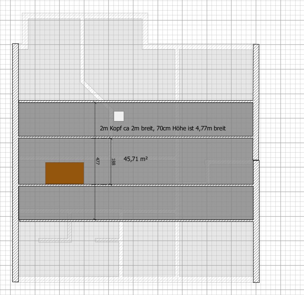

- The stairs to the attic are not directly under the ridge beam but still next to the 2m (6ft 6in) line (the two inner walls mark the area where the ceiling height is 2m, assuming Sweethome’s data is correct)
- The outer walls mark the area where the ceiling height is 70cm (28in), as was discussed earlier in this thread
I’m aware that there are probably still a few mistakes. I assume I have the wrong values for ceiling thicknesses and that the attic is probably not as spacious as it looks.
Good night all
Good night all
Sparfuchs7724 Jul 2019 06:14tomtom79 schrieb:
I haven’t read the last 13 pages, but you can just throw that floor plan in the trash. If you could also explain why it’s not usable, that would at least give me a starting point.
As I said, I’ve tried to salvage our initial floor plan as much as possible, mainly because my wife is very attached to it.
I’m aware that the layout of the rooms upstairs still has a lot of potential for improvement. But for creative input, we have an architect. My main goal was to find ideas and suggestions to address the previous points of criticism (most of which I also agreed with):
- Train station effect in the living room
- Staircase situation
- Dormers
- Raising the knee wall
- Closet arrangement in the master bedroom
The ground floor might still work, but you can’t walk around the table when someone is sitting there.
Please furnish the downstairs bathroom once.
Upstairs, these two sloped ceilings in the kid’s room add no real value.
The bathroom is too small, and the passageways are too narrow.
The bedroom bed is wider than it is long; if you include a headboard, there won't be enough space at the foot of the bed to walk around comfortably.
In the room above, the door opens against a wall.
If you have an architect, let them do the work and stay out of the way for now.
