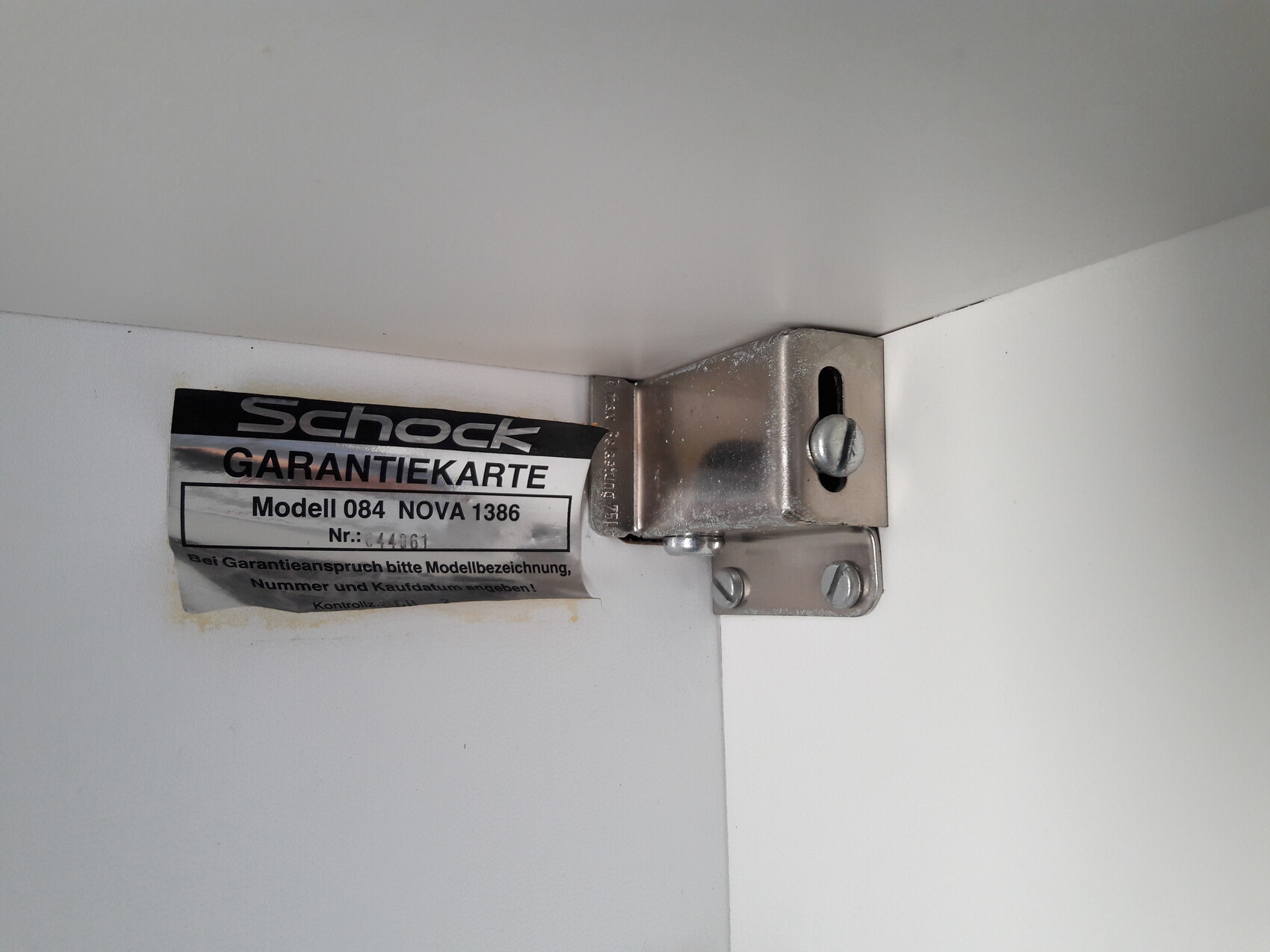

I want to remove the shock mirror cabinet. The older unit is firmly installed. Does anyone know how to unlock the fitting shown in the picture? I have two of these fittings, each located in the upper corners.
Which screw should I loosen first?

Unscrew the slotted screw at the front, then it will come loose from the wall.
It’s possible that the lower slotted screw locks the front one to prevent it from turning, so start with the lower one.
The front slotted screw secures the cabinet to a hook in the wall, which is why the cabinet is so firmly fixed. Nice concept.
tomtom7912 Sep 2021 19:53
That could also be the case. I thought it was for height adjustment.

tomtom79 schrieb:
That could be the case too. I thought it was for height adjustment.
I would also say: that is just for height compensation. I imagine it is hooked in, so you would try to push it straight up along the wall.
