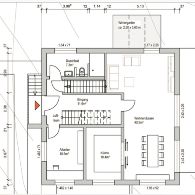

ᐅ Design for a Single-Family Home of 160-180 sqm – Suggestions for Improvement?
Created on: 19 Oct 2018 07:21
Duran
Plot size: 650 sqm (7000 sq ft)
Slope: 2 m (6.5 ft)
Floor area ratio: 0.25
Floor space index: 0.3
Number of floors: 2
Roof type: FD
Homeowners’ Requirements
Number of occupants: 2, mid-30s
Office: home office
Overnight guests per year: none so far
Open architecture
Modern construction style
Open kitchen with sliding door
Number of dining seats: 6
Garage: two parking spaces in the basement
Planner:
- Do-it-yourself; adapted by planner to the site
What do you particularly like? Basically everything needed is included; the sloping site makes it a bit more complex; driveway to garage is almost level as is the terrace; the view facing south is nice
What do you not like? Why? Upstairs bathroom is too small; would like walk-in shower and bathtub; widen the building by one meter (3 ft)?
Personal budget for the house, including fittings: 550,000
Preferred heating system: underfloor heating
We have a nice plot with a slight slope and want to build a new home. All rooms are basically included in the design, but we would appreciate other perspectives. The upstairs bathroom seems too small at the moment, and the layout feels unbalanced.
Slope: 2 m (6.5 ft)
Number of floors: 2
Roof type: FD
Office: home office
Open architecture
Planner:
I believe there is a fundamental flaw in the design. If I understand correctly, the upper part of the living room will be at garden level.
However, this seems rather impractical. The kitchen and dining area would be better placed there since that is where you would access the terrace for grilling or relaxing.
Therefore, questions about the layout or flow without furnishing plans are basically irrelevant.
Duran schrieb:
The bathroom shifts entirely to the left in its layout. This gives the living room a sort of reading nook (1.3m wide and 2m deep) Based on the measurements above, I don’t understand where 5x3 m (16x10 feet) come from? *thinking*
