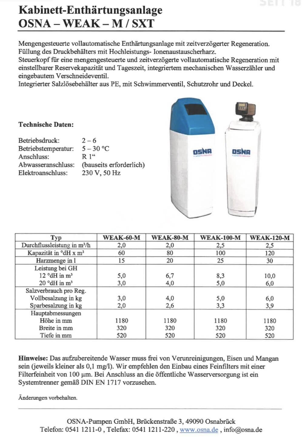

goalkeeper30 Oct 2020 11:15Golfi90 schrieb:
Ours regenerates once a week or after 4500 liters (1190 gallons) of usage, whichever comes first.
Of course, we also have a relatively large system. So I can put 100 kg (220 lbs) of salt into the tank...
Does that also make a difference?That sounds a bit oversized. My Grünbeck system holds 35 kg (77 lbs) and is designed for four people.
Golfi90 schrieb:
We installed the WEAK-80-M. This unit is designed for large apartment buildings. It is massively oversized for a single-family home, and the system’s capacity is nowhere near fully utilized. A 25kg (55 lb) bag of regenerating salt should last at least six months, more likely around nine months. In terms of operating costs, it might not really break the bank, but there are much more economical and efficient options. I would say that with a properly sized system, you could reduce your costs to about one-tenth of what you have now. You can calculate yourself when the investment pays off.
