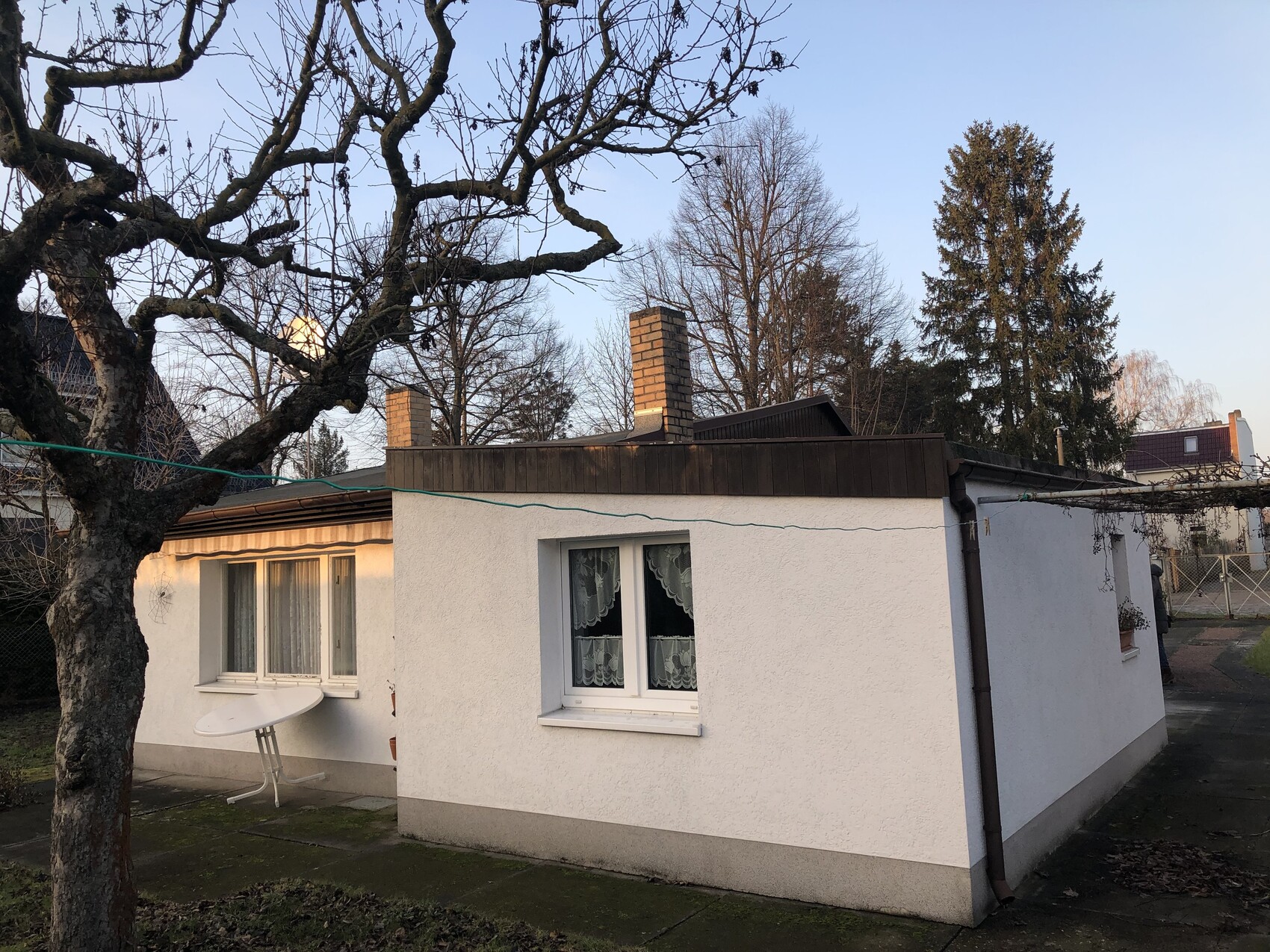

we have a DDR bungalow standing on our (recently surveyed) plot. We have already requested demolition quotes via MyHammer, but since we need the money elsewhere now, we want to demolish it ourselves. Do you have experience with demolition, especially regarding the following topics:
Thank you very much for your answers!
A picture of the house (approx. 8m x 8m (26ft x 26ft)):
- Preparation for disconnecting utilities,
- Planning for waste containers,
- What rental equipment is needed?
