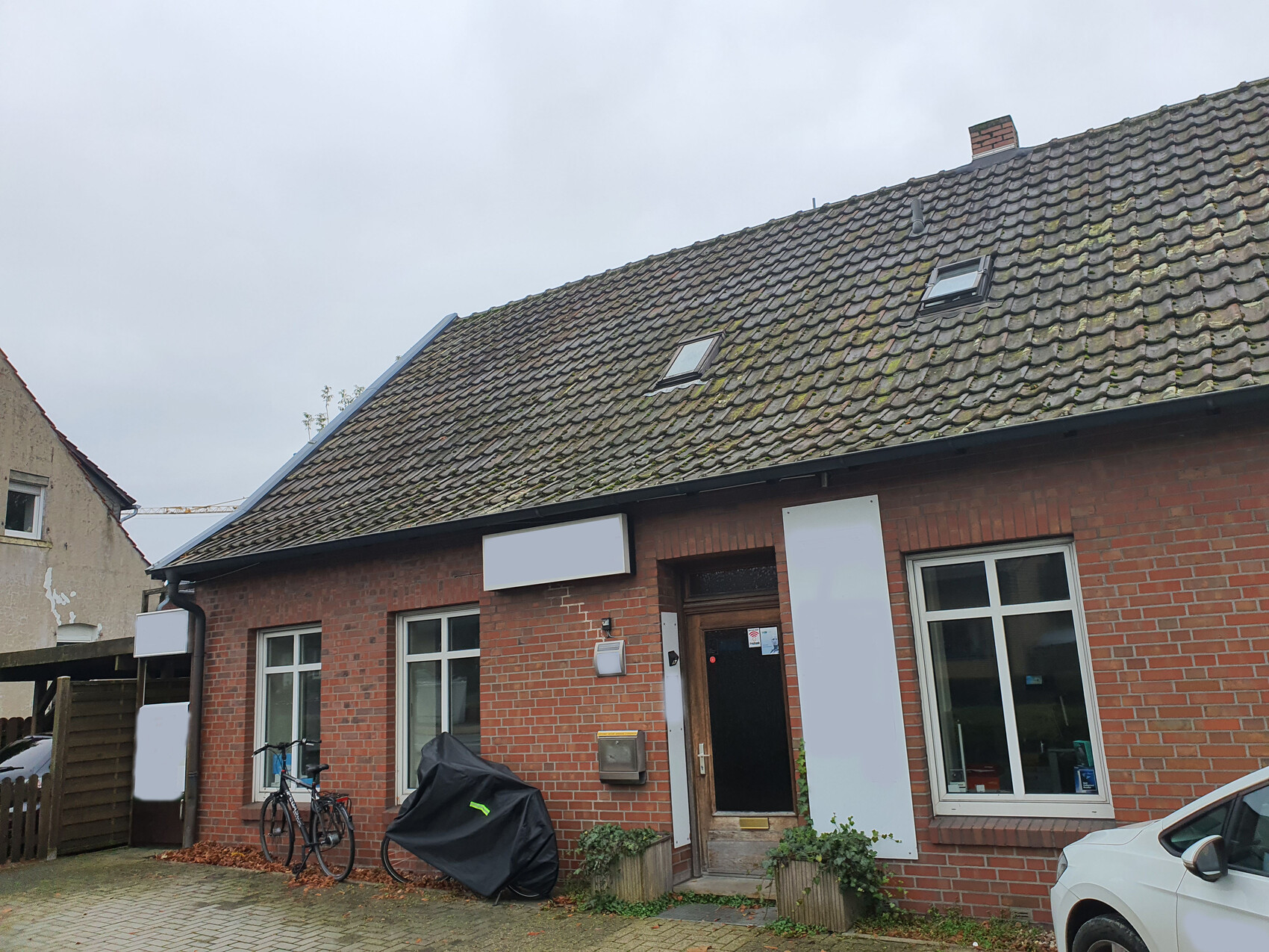

Here are my initial unstructured thoughts on my current construction project.
I am planning to demolish my old house 😱
The reason: We are desperately looking for office space nearby, which is simply not available. Further development areas in the vicinity are only expected in a few years, and the chance of getting anything there will be very low. Renovation is out of the question due to the building's structure. So demolition and new construction.
Thoughts...
Temporary relocation space needed for at least 1 year from the start of construction -> possible with many restrictions
No zoning plan -> so § 34 Building Code applies
Boundary construction (again) on three sides -> absolutely necessary again as the plot is only 298m² (3208 sq ft)!
If boundary construction is not possible -> sale of the property 🙄
Parking requirements not clear yet, but likely achievable (“basement” or underpassable ground floor)
Demolition costs about 25-30K including disposal of oil tanks (initial estimate from architect), we had expected 50K 😀
Plan budget with around 100K buffer 😡
Construction costs are obviously a concern, but it probably won’t get any cheaper.
Slope in the building area approximately 1.5m (5 ft) hence (again) something like a basement / semi-basement -> underpassable ground floor (from the “right”) with parking spaces for car, bike, and garbage bins, also serves as delivery entrance for goods
Extra access road (5-10K?) through existing small flower bed (belongs to municipality) so about 5m (16 ft) paved area + lowered curb etc.
Goal:
Modern multifunctional building with 2 full floors as office space
A recessed top floor as penthouse / apartment or additional office space (for rent)
Our company will move into the ground floor and part of the first floor as tenant; the rest will be rented out (currently and conservatively estimated at a minimum of €9 cold rent for office or apartment)
The building’s footprint will likely be around 13x13m (43x43 ft)
Only on the front side (office entrance) and right side can windows be installed on the ground floor, first floor, and attic.
“Back” and “left” sides of the ground floor probably difficult to impossible for windows due to boundary construction. With a 13x13m footprint that leaves a lot of space without natural light on the ground floor.
Initial discussion with the bank regarding financing went very well. It will probably work (the estimates from both the bank and the architect are around €2500 per m²). For your info: in North Rhine-Westphalia / rural Münsterland
A trusted architect will clarify some framework conditions by the weekend (what can / may be built regarding boundary and height)
Decision must be made by this Christmas... then, if approved, one year for planning & building permit application plus one year construction time...
Sketches coming next week
Alright, your turn 😉

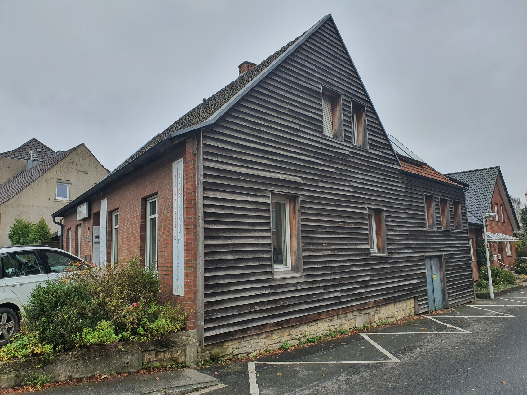

i_b_n_a_n schrieb:

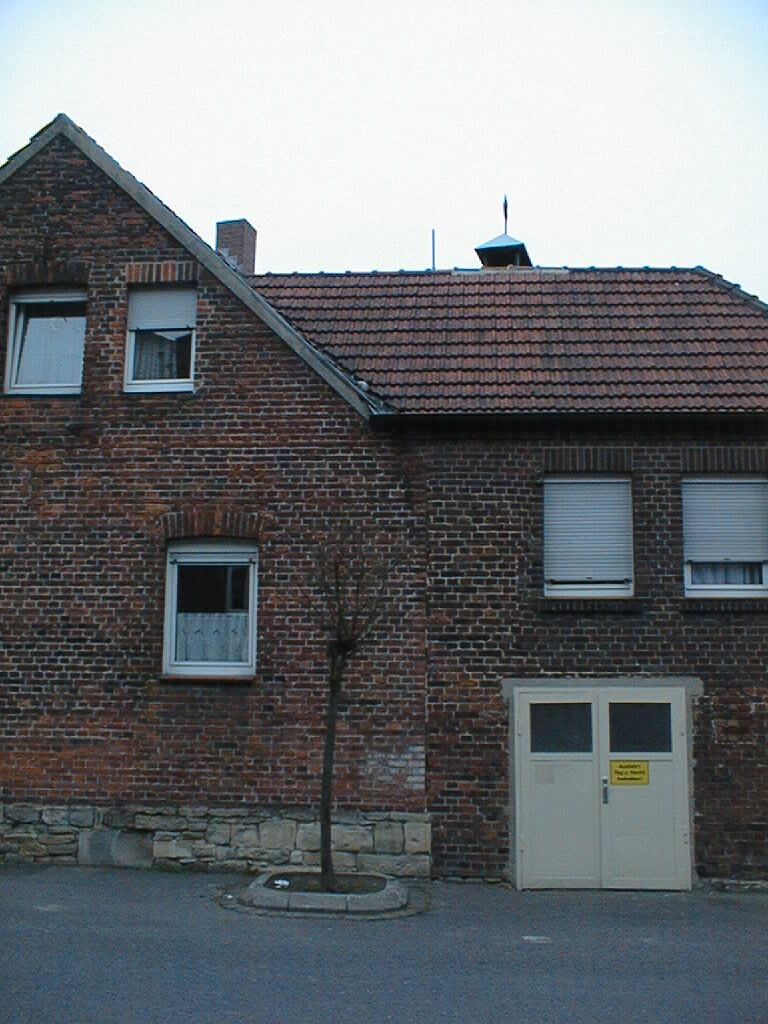

Hello, it breaks my heart as well. That’s why I found it so difficult and didn’t start the renovation 10 years ago. Especially since it has been family-owned since it was built. Is it possible to take a look at the old gem? Houses that old are quite rare to see.
Thank you.

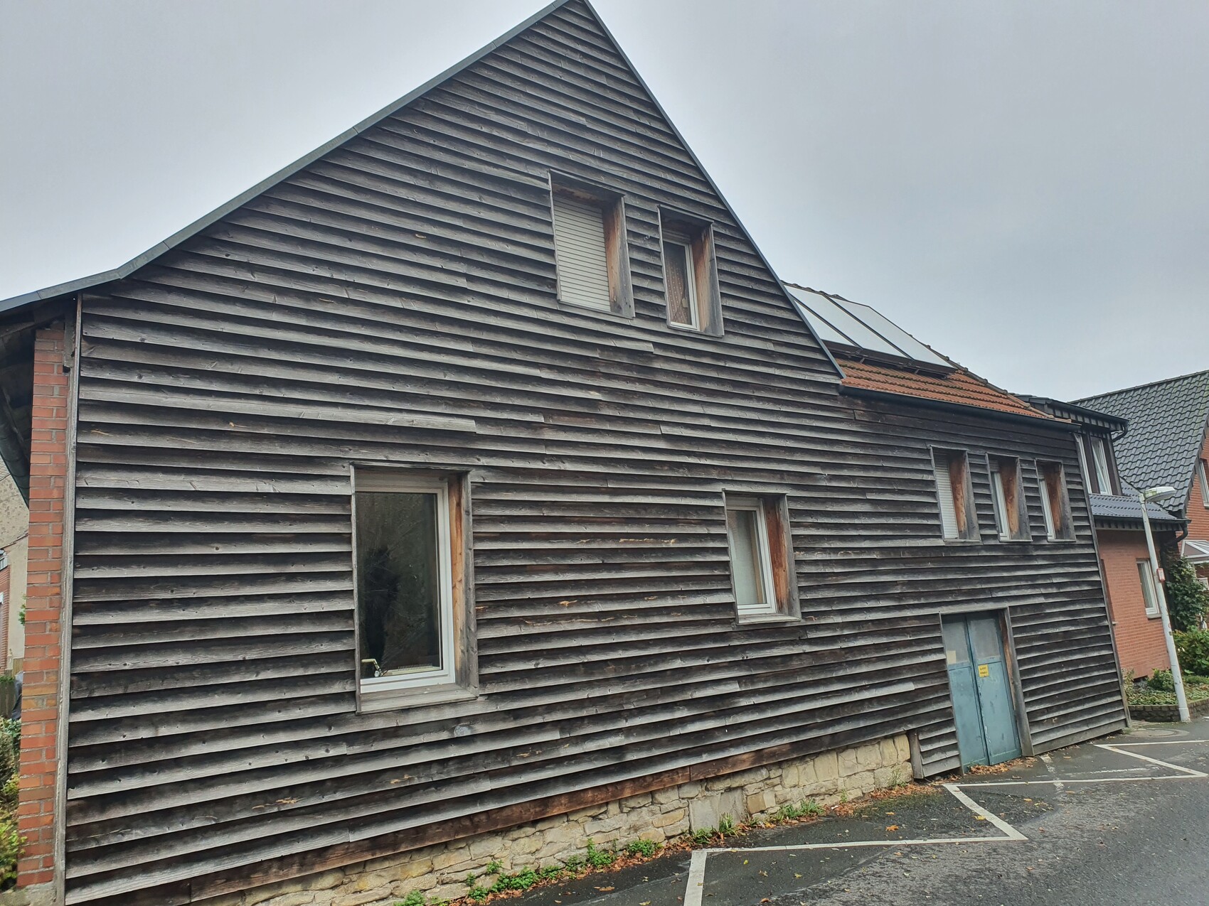

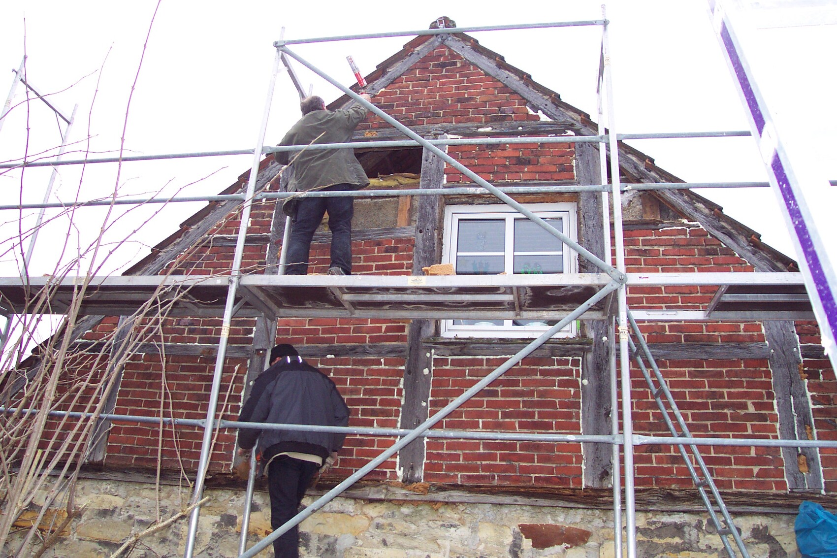

… as you can see, there is nothing worth preserving. Gable with scaffolding during renovation in 2008, now covered with floor/ceiling boarding made of larch. The “large” side was DIY with lapped cladding in larch about a year later.
At that time, a new oil condensing boiler was also installed. Last refuel was 3000 liters (about 793 gallons), which only lasts for approximately one year 😡

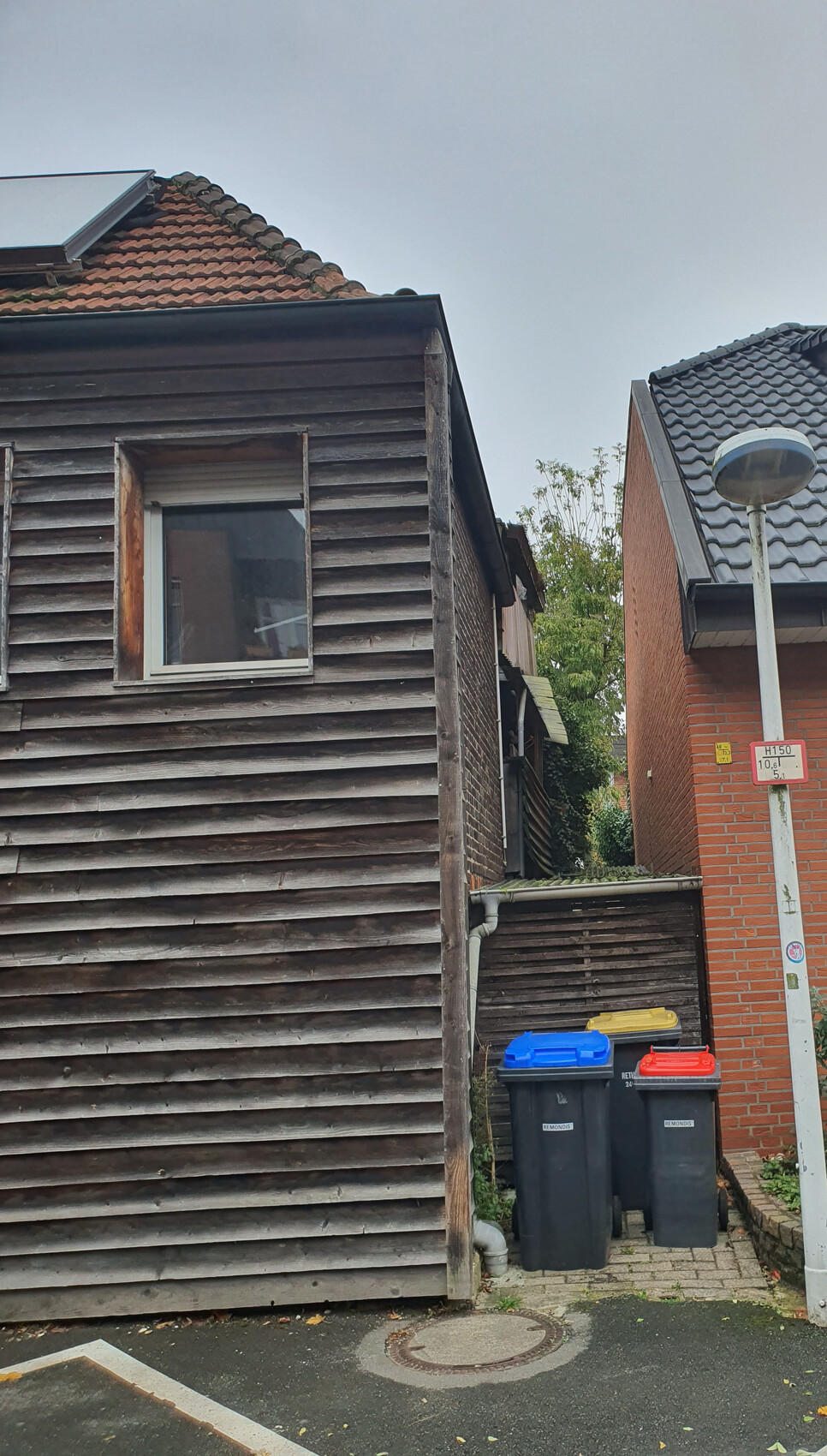

On the right side of the house (when standing in front, it’s the back) there is a one-meter (3.3 feet) narrow path that belongs to the neighbor on the left.
