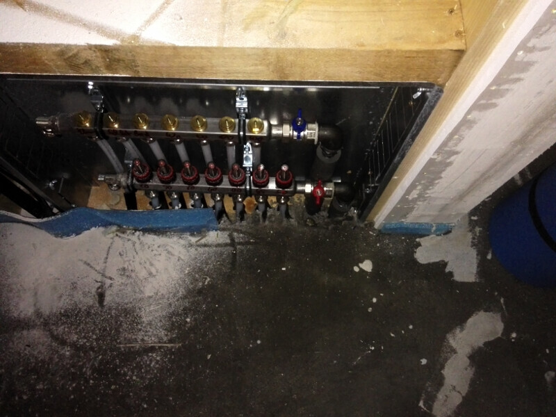

2) At one point, the edge insulation strip was missing. Now the screed has flowed into the manifold of the underfloor heating (see image).

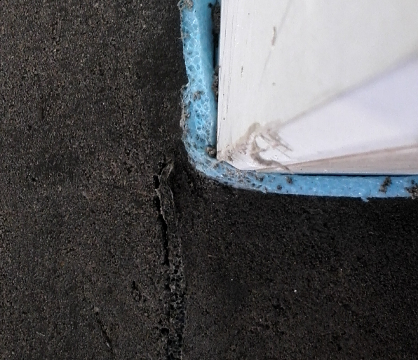

3) In many corners, the edge insulation strip was also installed poorly. There are gaps of several centimeters between the screed and the wall.

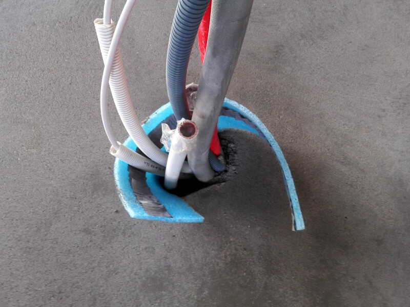

4) Inside the house itself, the insulation strip shifted around the connections for the kitchen island there, causing some pipes to now be embedded in the screed (see image).

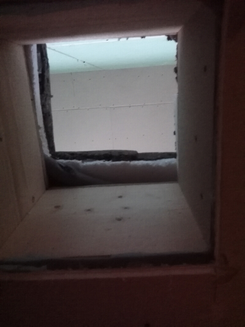

5) The opening for the laundry chute, which was supposed to be square (30x30 cm (12x12 inches)), was made approximately 25x35 cm (10x14 inches). They had just pushed in a cardboard box that was standing there, which was not square. This means the planned insert no longer fits unless part of the screed is removed and the other side filled in (see image).

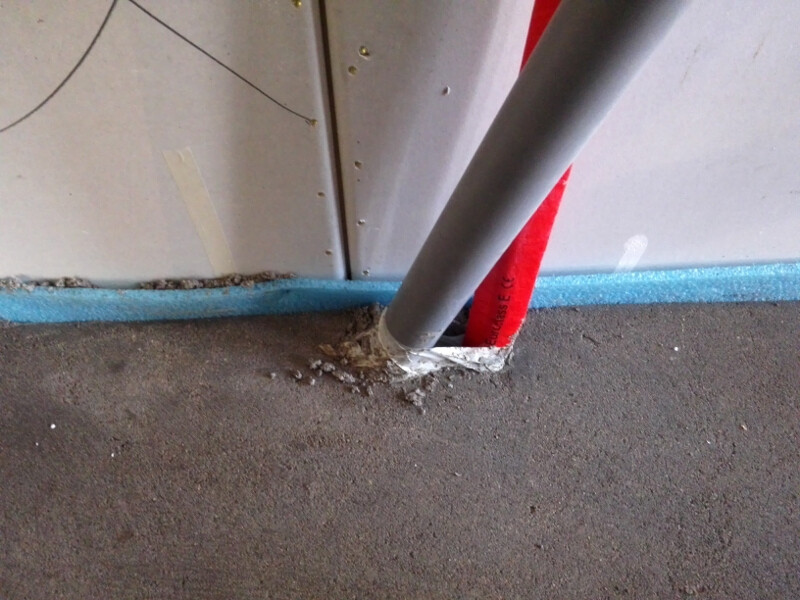

7) The installers left some pipes coming directly out of the walls. Some of these pipes are enclosed by the insulation strip, while in others, the strip runs between the pipe and the wall. This seems quite random. How should it be installed correctly?
