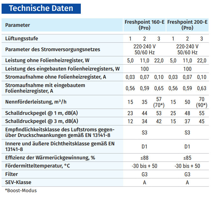

Good morning Nauer,
The air flow rates are shown below. For the 15sqm (161 sq ft) bathroom, I don’t see any issues with either unit. The electrical power is the same for both, with only the diameter being larger in one model.
Noise levels are also not a problem, since they won’t run continuously and a schedule can be set.
And if the humidity is too high, it’s allowed and even recommended to run it at level 1 or 2.
Technical data of a ventilation system showing values for ventilation level, performance, and filters

1. When it comes to two pendulum fans, as you mentioned as possible devices, it doesn’t really matter (there is an endless variety of devices available); besides that, almost all devices can be paired together appropriately.
2. If you want to install even a minimal ventilation system and are allowed to use two devices, then I would (but my opinion doesn’t count) recommend devices with crossflow or counterflow heat exchangers. These are quieter (so they can be used 24/7 without any issues), offer higher performance, and it doesn’t matter how many devices you install or how you arrange them. They operate completely independently of each other – supply and exhaust air simultaneously and alternately. However, for really good devices, you should expect costs around 4,000 (currency not specified).
