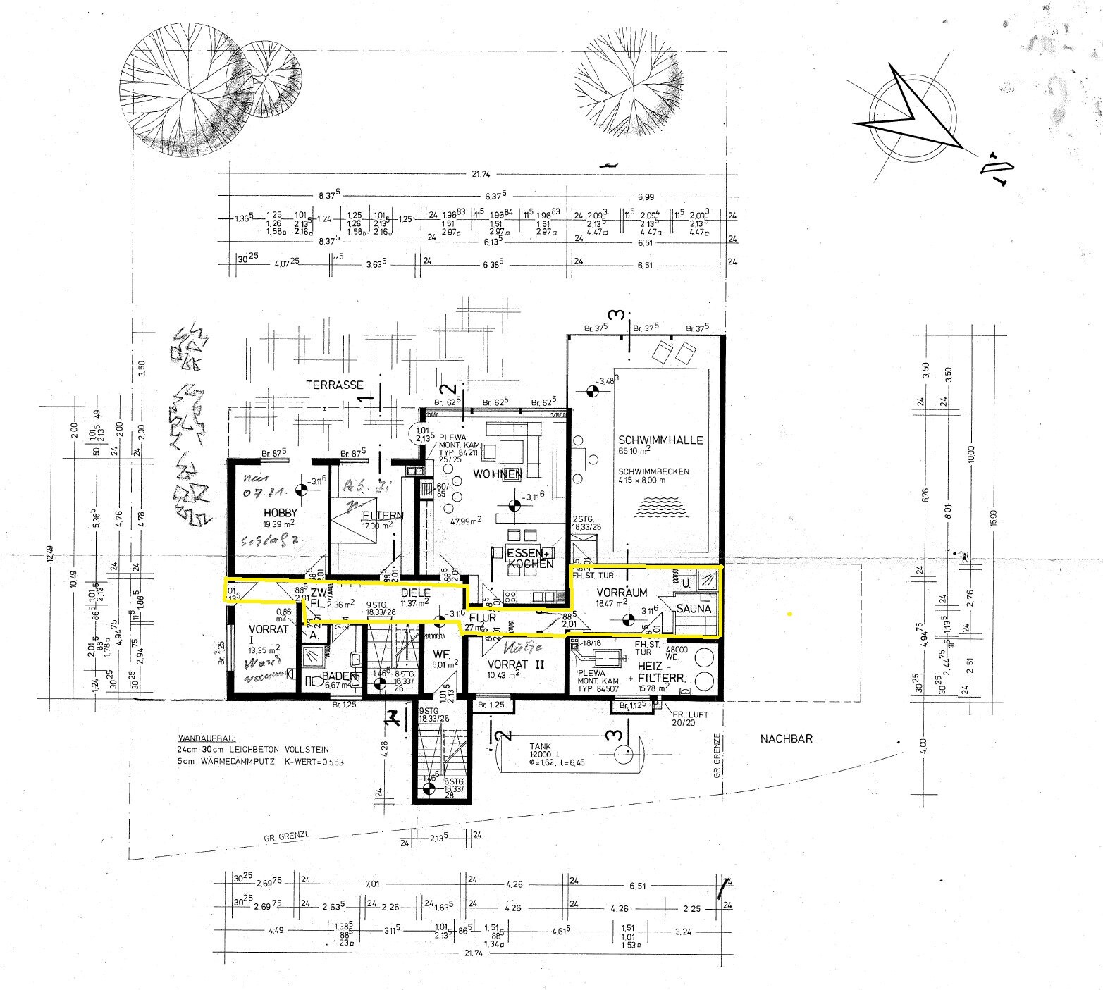

Something different: In the area highlighted in yellow, I have a suspended ceiling grid that basically allows me to access every room from above the ceiling.
Right now, I'm focusing on the ventilation for the living room and the "swimming pool" because new windows are supposed to be installed there first.
The swimming pool was never realized and is now a normal room (extension).
In the room "Storage1," I could reach the outside and also install a central unit there.
Would that be an alternative?
How much does something like that cost compared to decentralized options?
Architectural floor plan of a house with terrace and garden, clearly drawn.
nordanney
5 Oct 2025 21:53
RealUnreal schrieb:
Would this be an alternative?
Only if you can install the appropriate ducts in both rooms. Supply and exhaust air are applied at different points on the ceiling when done correctly.
RealUnreal schrieb:
How much does this cost compared to decentralized options?
Many times more. Depending on the equipment, maybe around 5 times as much (?). Much cheaper if you do it yourself.
And the question is how and where supply and exhaust air can be positioned in the rooms. It might even be a factor of 10 if it gets especially complex.

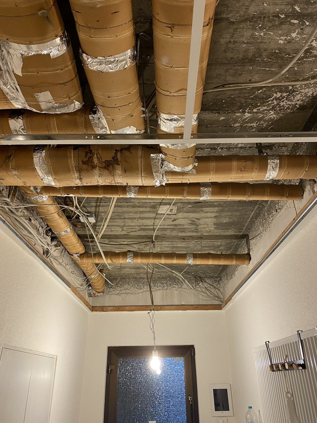

Does the position of the supply and exhaust air have to comply with specific regulations?
I would say this: In principle, it should be possible for me since the ceiling is dropped everywhere (suspended ceiling). It’s a bit tight in places, but if flexible ducts can generally be used and the openings to the rooms don’t need to be very large in diameter, it should work.
Technically, it’s basically like the installation of a decentralized unit, right? Except there’s a distribution box in between that distributes the air to the rooms. So, you would only need one central location for the main unit and from there to the distributor, then into the individual rooms?
Open pipes and cable trays hanging from the ceiling in a renovated interior
