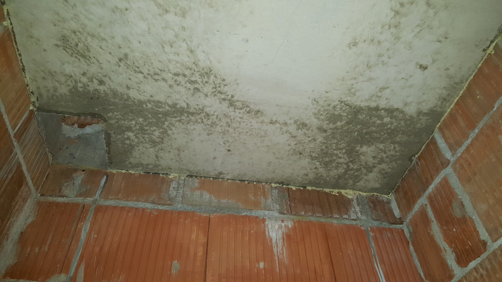

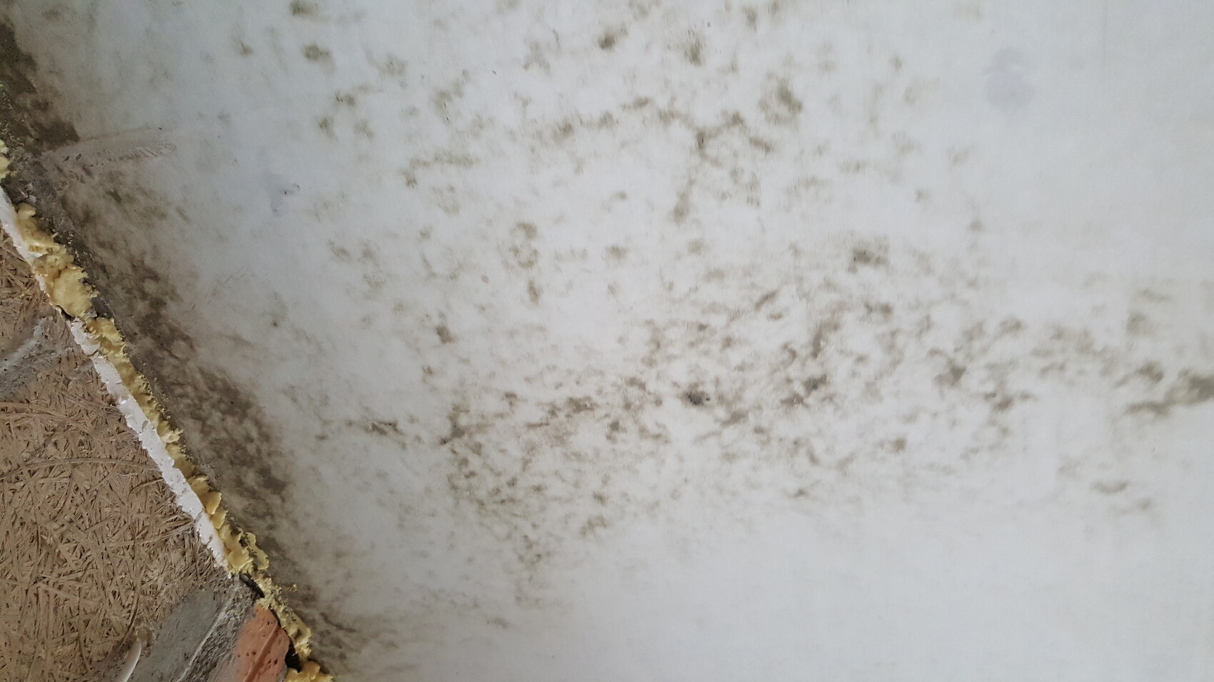

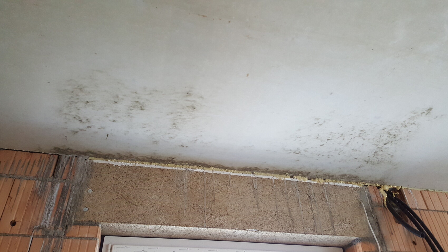

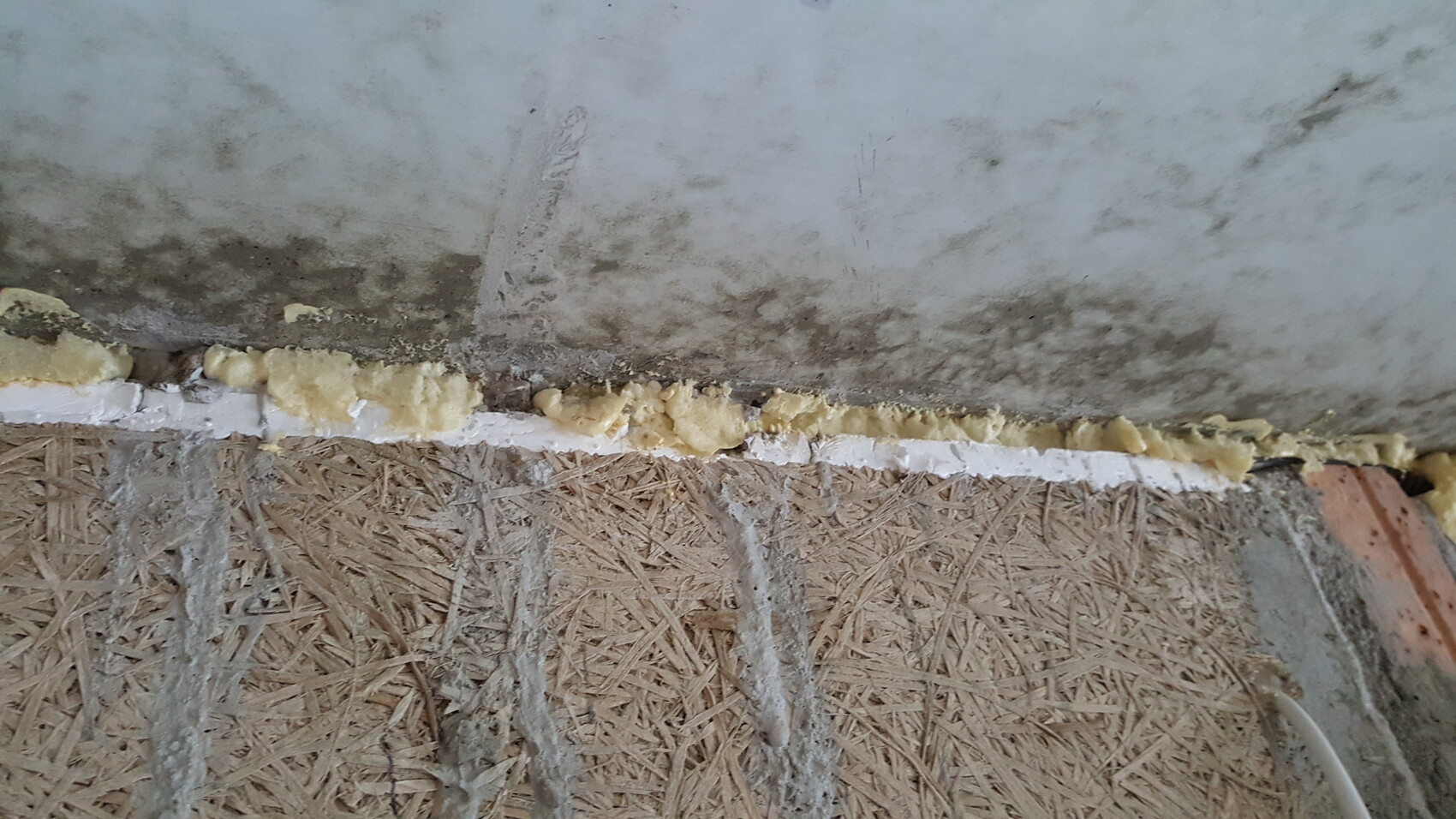

Hey everyone
I was at the construction site again today. I noticed some strange dark spots on the concrete ceilings. At first, I thought it might be mold, so I tried to wipe the spots off. However, they won’t come off. Even scrubbing doesn’t help much.
Maybe someone has an idea what this could be. What’s odd is that the spots are mostly above the windows.

Mycraft12 Jan 2017 18:59
That is moisture, and damp concrete naturally darkens... absolutely nothing to worry about.
1
19Chris84
12 Jan 2017 19:19
First of all, thanks for the response.
But why is there still moisture? The building has been closed up for over 6 weeks (1.5 months).
I think the last picture looks strange.
Best regards, Chris
Mycraft12 Jan 2017 19:26
Many concrete structures have still not fully dried out, and some have been standing for several decades... 6 weeks in winter... return after 6 months
Basti270913 Jan 2017 12:00
When our drying program was running, it looked quite similar. Actual droplets formed on the ceiling. After wiping them off, it eventually dried out again…
