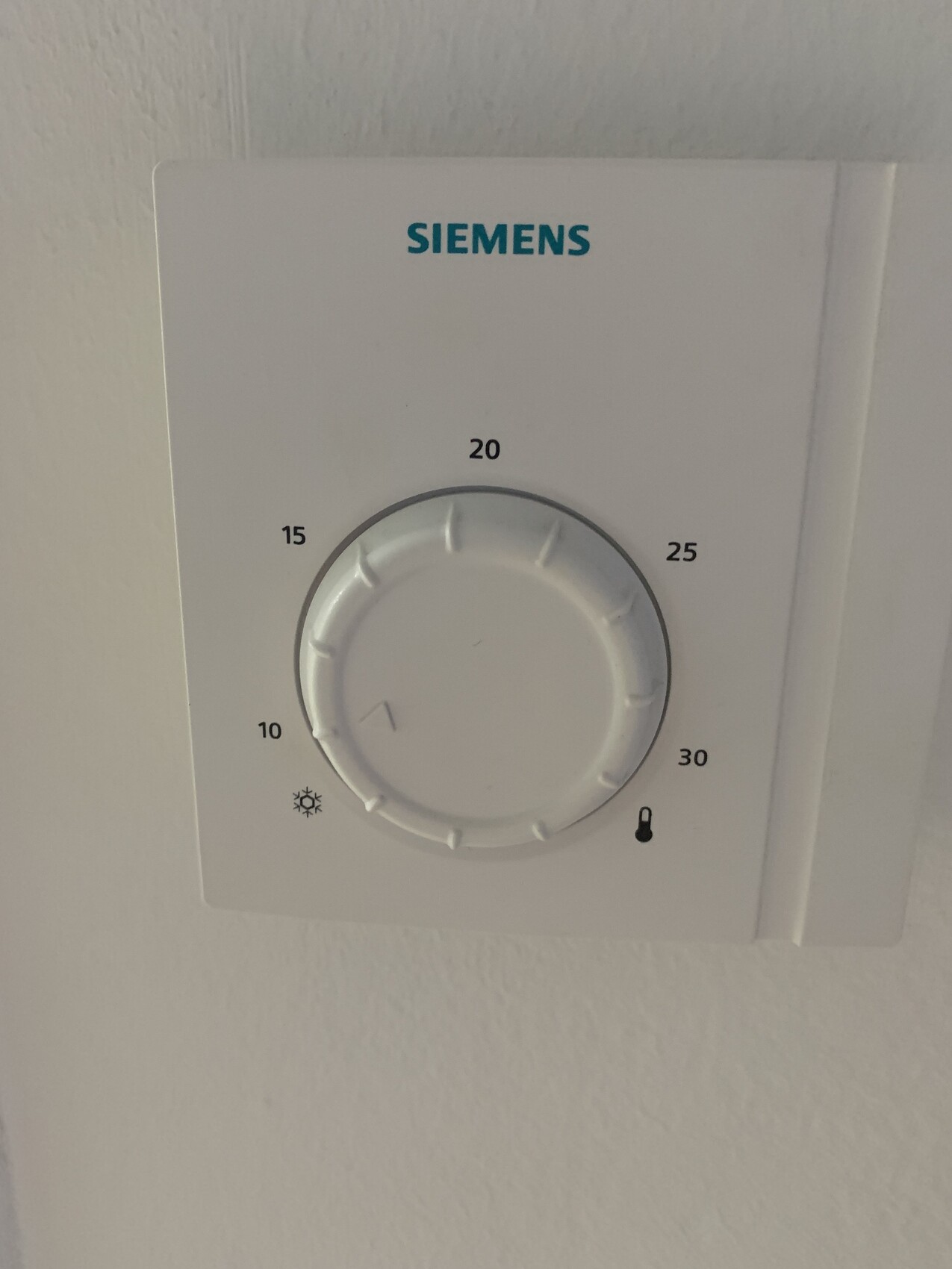

In my apartment, the room temperature is not right at all.
Although the thermostat is set to 22 degrees, the room temperature sometimes reaches 25 degrees.
I have done some research and read that it might help to reduce the flow temperature. Does the return temperature also need to be reduced?
Could someone please tell me, based on my photo, where I can adjust the flow temperature and where I can adjust the return temperature? Maybe also a tip on what values I should set?
Thank you very much

tomtom79 schrieb:
What happens if you just set the dial to 20 degrees? I guess it will just act as an on/off switch.
Show me a picture I’ve even set the dial below 20 degrees at times, but the temperature doesn’t change much.
