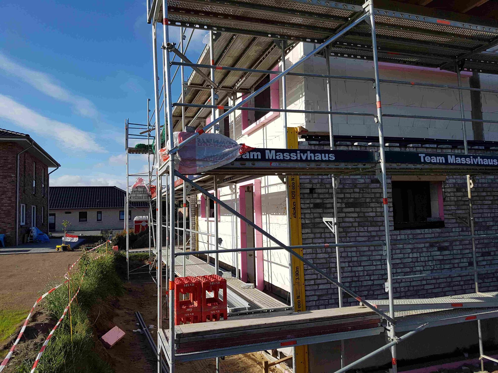

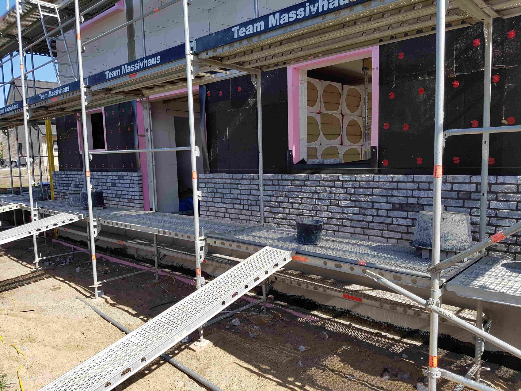

A brick veneer facade is ventilated from behind, so something like that usually has no effect. It could be that something has fallen off and the ventilation is no longer functioning. But all of this is just speculation. The only option might be to use a borescope camera to look through the gaps.

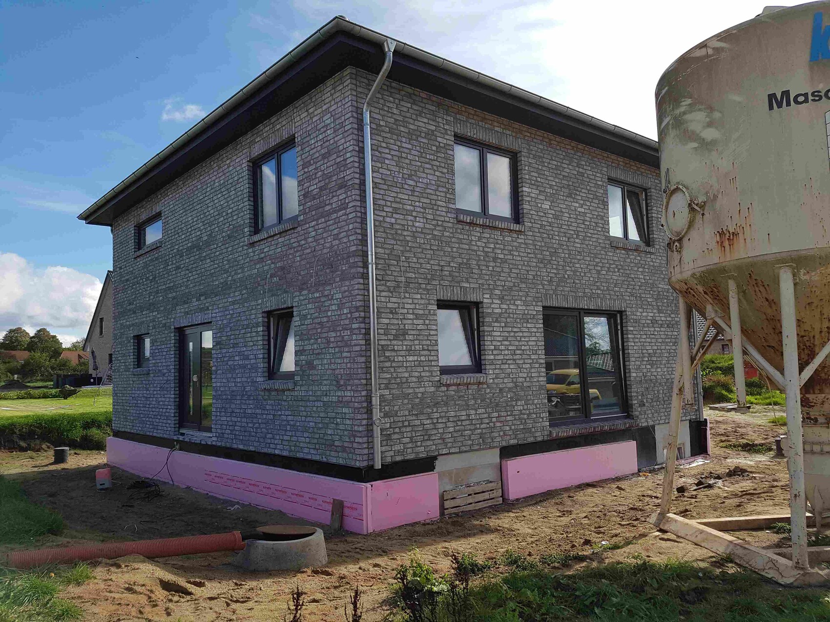

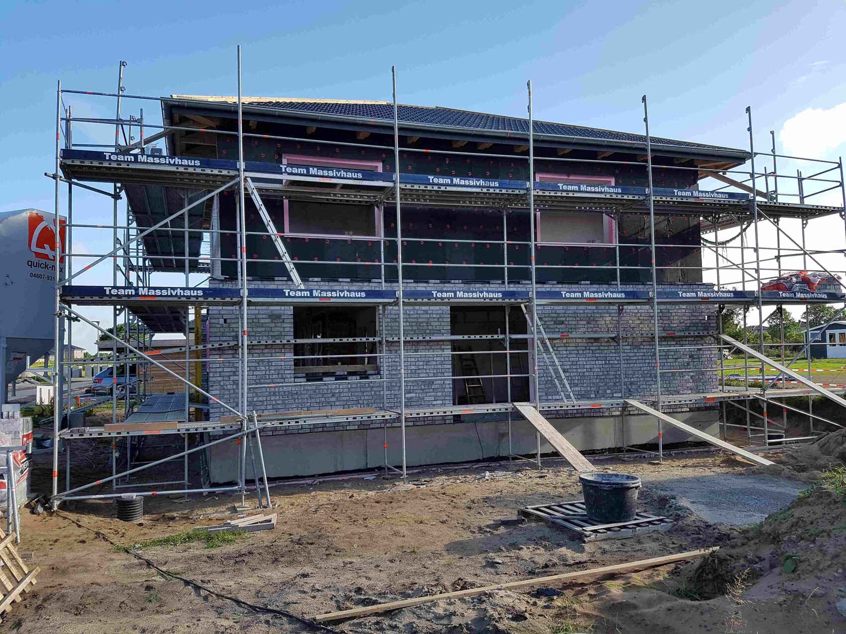

So, I found a few pictures – I hope they provide enough detail to see what’s going on.

Maybe the construction manager is not entirely wrong, and it was indeed a pallet of facing bricks that was "somewhat different" ... composition, color, firing time ...
Were moisture measurements taken?

I can only assume that it is due to the brickwork. I mean, a lot of water evaporates at the level of the concrete ceiling. Construction today is quite fast, so the ceiling, which may have been poured conventionally (?), probably wasn’t left exposed for a very long time. The water soaks into the brick and then evaporates from there into the surrounding environment.
