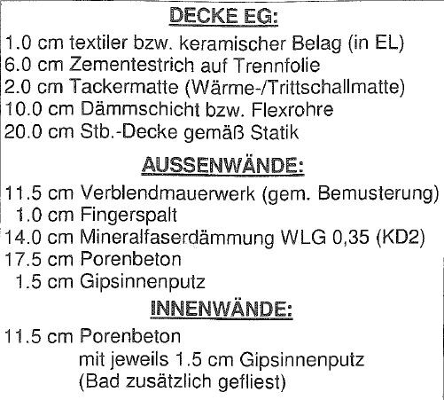

readytorumble14 Mar 2019 14:20What kind of ceiling is this? Cast-in-place concrete?
What is the wall construction? Masonry, insulation...?
How was the ceiling insulated?
Does the strip disappear after several dry days?

readytorumble14 Mar 2019 16:26Could it be that the beam (meaning the ceiling) is less well insulated than the rest of the wall?
We have also noticed that the beam dries a bit more slowly after heavy rain during the cold season. However, we have a solid wall construction and a plastered facade in that area. After a few hours, the moisture issue resolves itself and everything is dry.
