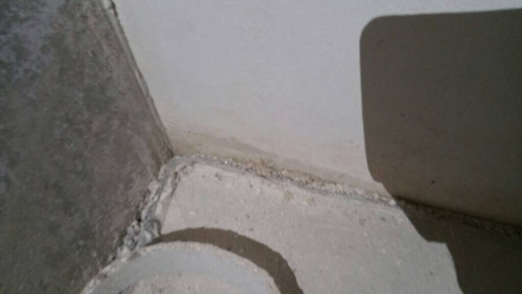

After the screed was applied in the basement, the calcium silicate brick interior wall near the entrance bay, at the junction with the waterproofed (WU) exterior wall, was extremely damp and dried only slowly (over nearly 6 weeks). In the end, only a narrow damp strip close to the floor remained visible. However, our heat pump has now been running in heating mode for a little over a week, and the moisture is still visibly and noticeably present. Is this a defect, or can moisture remain in certain areas for such a long time?

Knallkörper31 Aug 2017 23:27It can last this long if the area is poorly ventilated.
