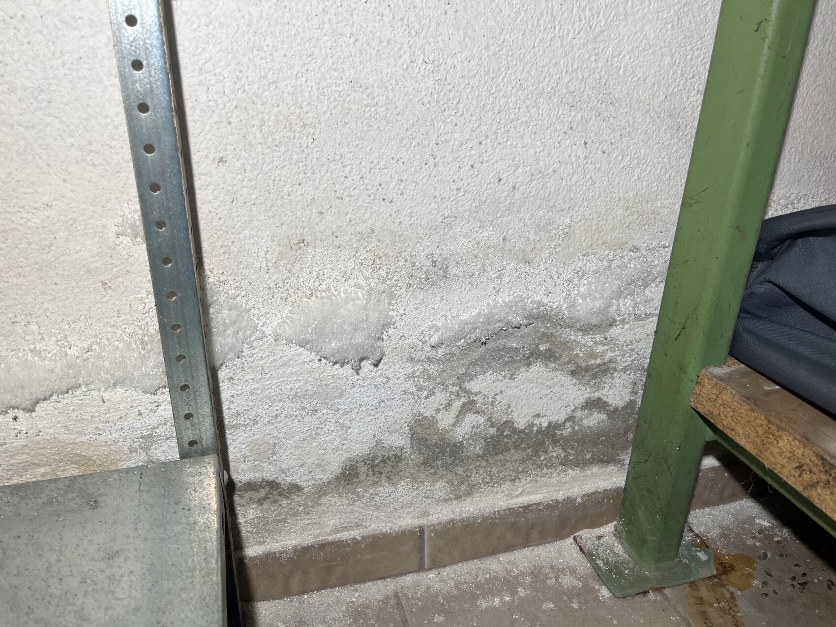

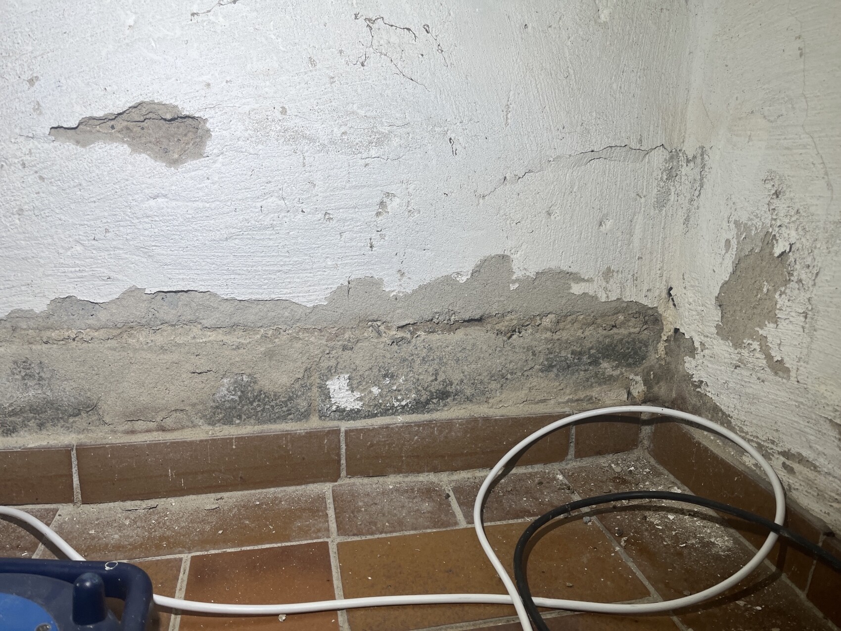

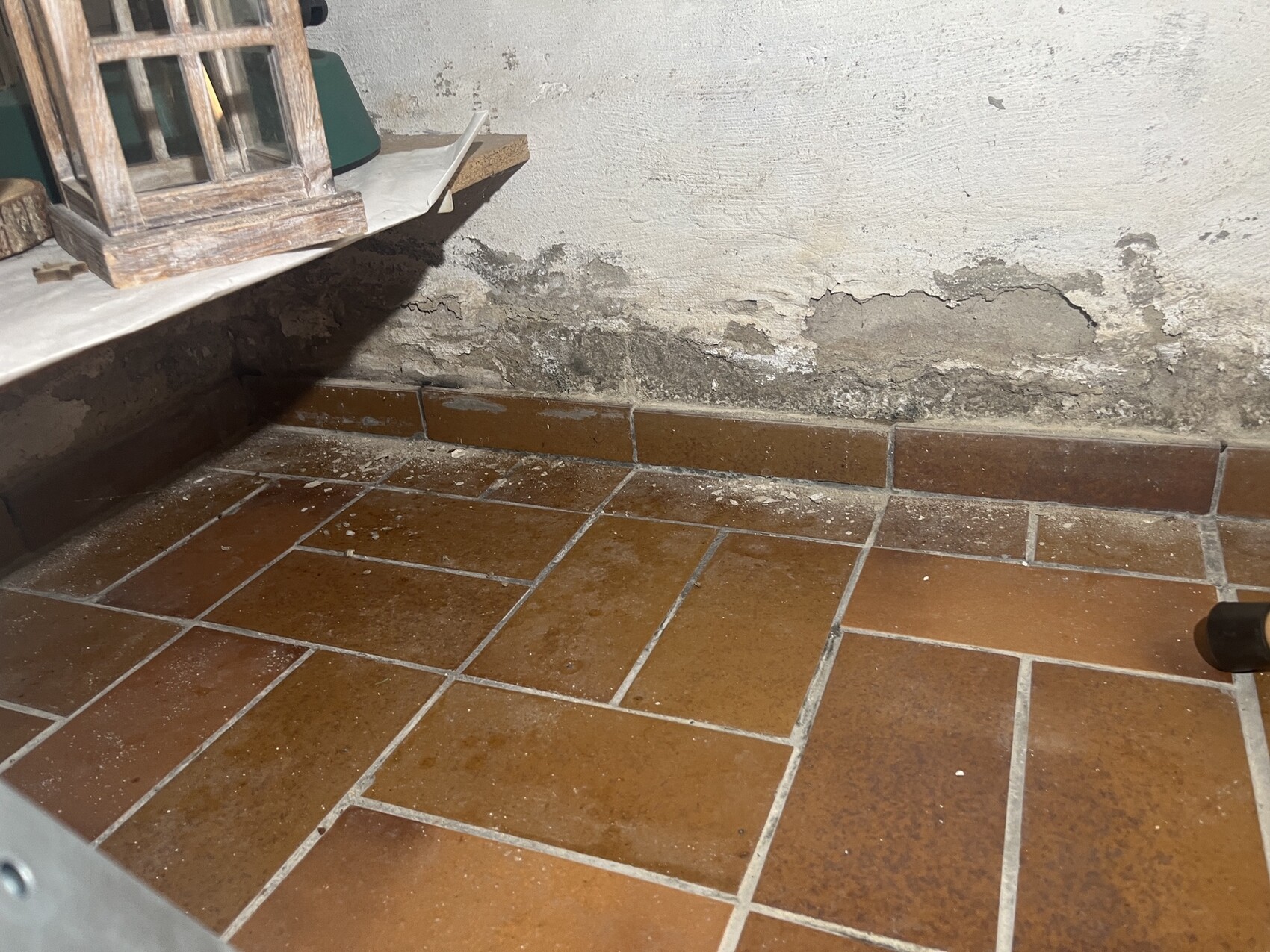

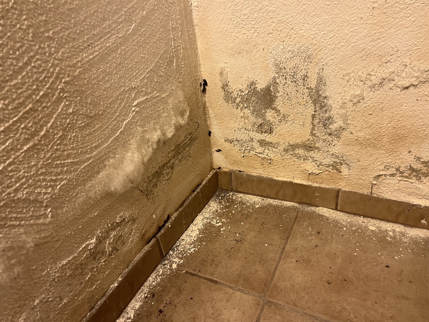

we are undertaking a full renovation of a house built in 1962. One concern is the moisture in the unfamiliar basement.
Based on the following pictures, can it be estimated what needs to be done to control the moisture? With the current high temperatures, I usually have 75-80% relative humidity. Should the exterior be waterproofed? Additional drainage? Other options?
Thank you very much in advance for your help and advice.
Benny
Benny
nordanney16 Aug 2024 16:08Hard to say. Excavate and waterproof from the outside? Are all of these exterior walls? Do interior walls also have that kind of fuzz?
My basement is currently damp as well. Like in your case, it’s due to humidity. But otherwise, my basement is completely sealed from the outside.
In any case, I would get a professional to take a look.
