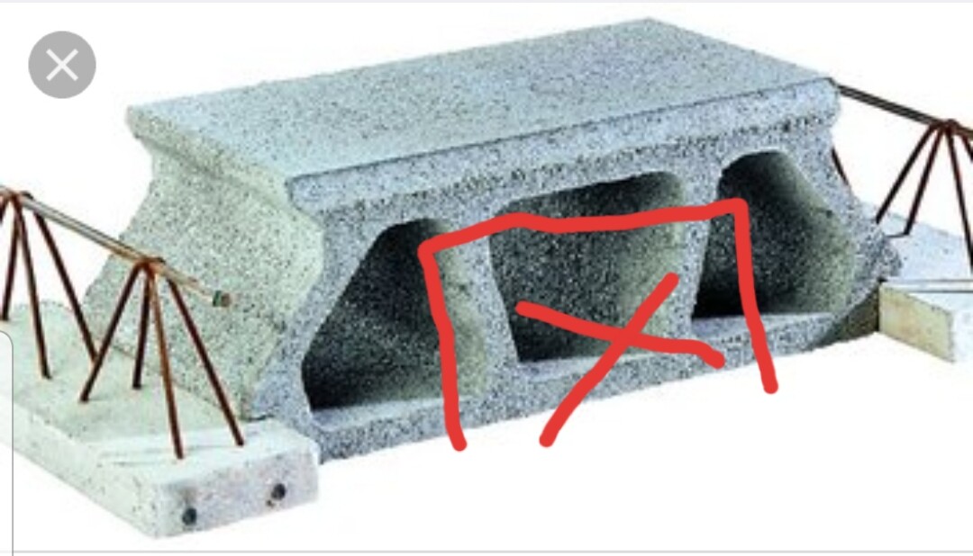

I have a precast concrete beam ceiling (see attachment)… I want to install a recessed light fixture measuring 18 x 18 cm (7 x 7 inches) and 10 cm (4 inches) deep in the bathroom. Is it safe to cut a 18 x 18 cm (7 x 7 inches) opening in the ceiling? Will this cause any structural issues? I want to avoid installing a suspended ceiling. Thanks

beckl19884 Jan 2022 08:57I have a ceiling structure that is 50cm (20 inches) thick, with 26cm (10 inches) of insulation. I want to avoid installing a suspended ceiling because it would require redoing the exhaust ventilation and would reduce the room height to only 2.15m (7 feet). However, if there is a risk of compromising the ceiling’s load-bearing capacity, I have no other choice.

but if there is a risk of compromising the load-bearing capacity of the ceilingAs shown in the picture with the red X, that would probably be the case – but those are holes for spotlights the size of subwoofers, and the picture again shows a ceiling made of lightweight concrete panels, whereas you were talking about bricks.https://www.instagram.com/11antgmxde/
