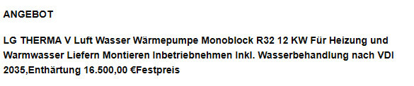

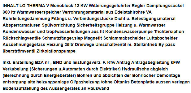

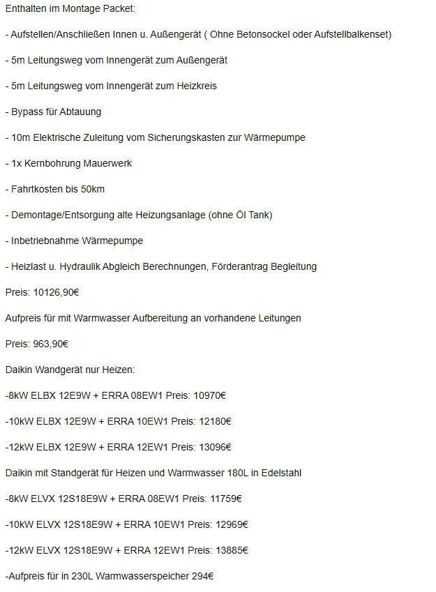

Alessandro18 Oct 2024 09:35nordanney schrieb:
No, you just look for suitable offers on the relevant platforms.
For example, the following offer BEFORE subsidies
or from Daikin BEFORE subsidies
Interesting. Could you please provide the sources? Thanks.
nordanney18 Oct 2024 09:48Alessandro schrieb:
Interesting. Could you please provide some sources? Thanks.You can use all the usual platforms. The examples were taken from classified ads, formerly eBay.A

You can also go to the major providers. Thermondo offers similar prices.
