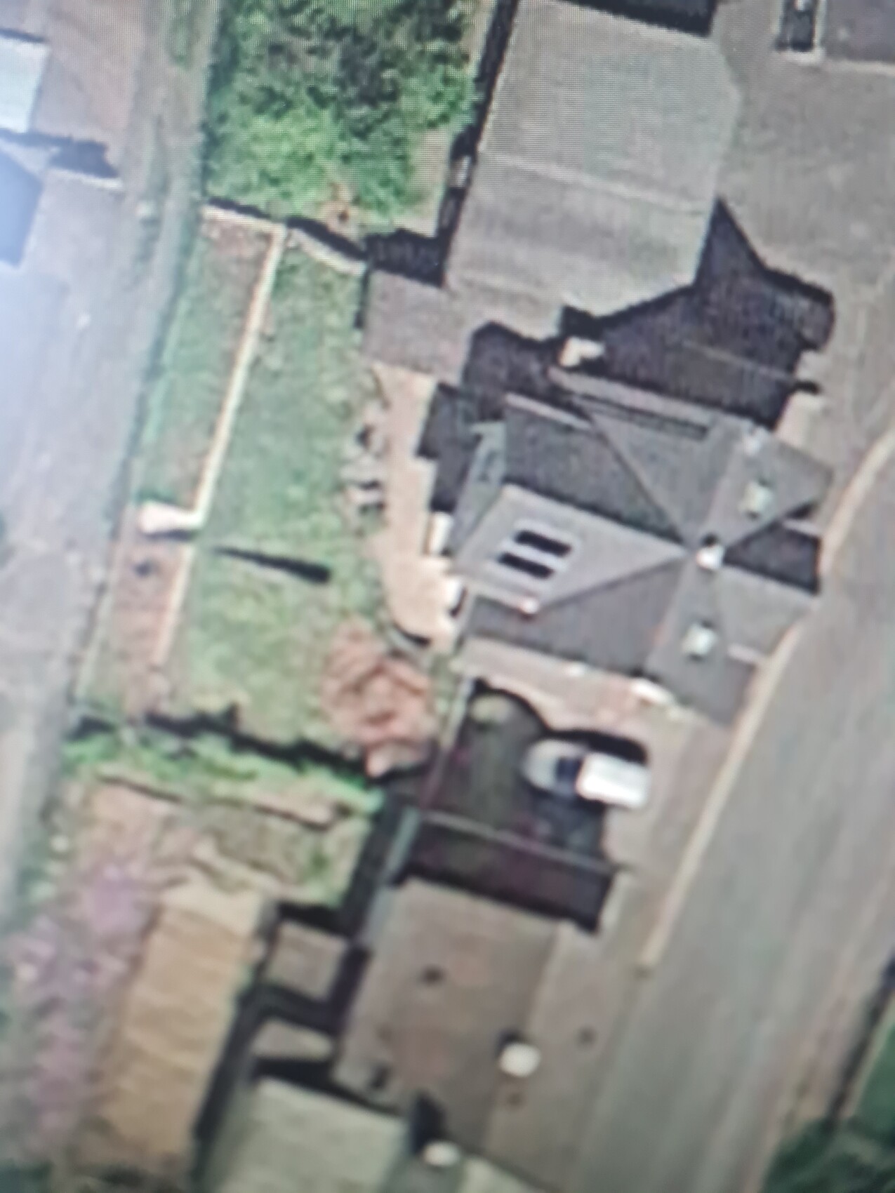

Show us the roof surfaces.

Here is a picture from above (the house with the solar modules is oriented north)
Aerial photo: row houses with gardens, street alongside, white delivery van in driveway.
