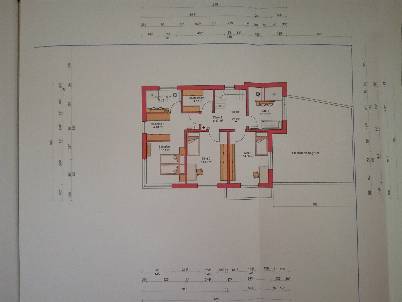

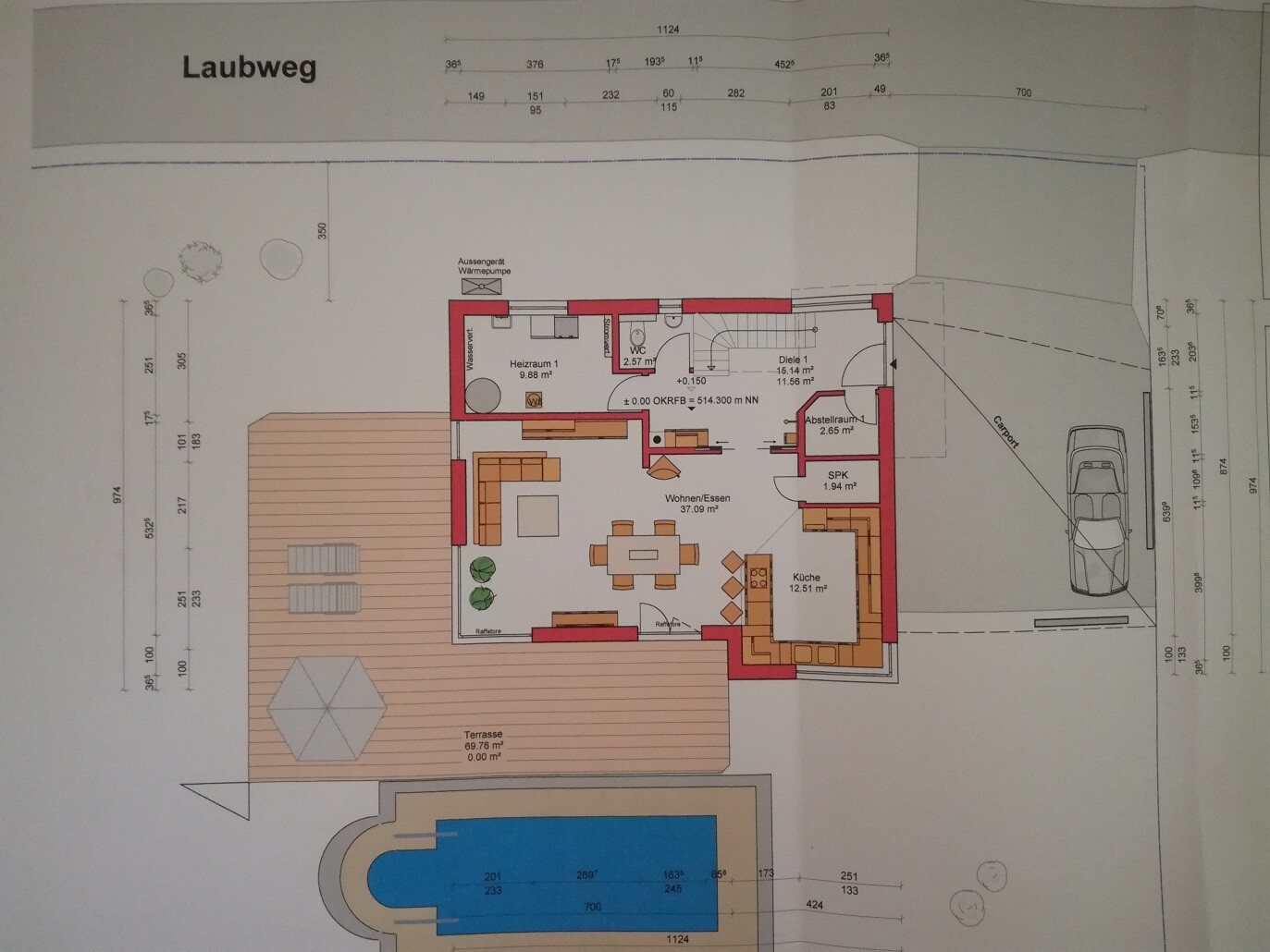

Now about us: we live in a town of 3,000 inhabitants between Stuttgart and Lake Constance at the edge of the Black Forest, and this is exactly where we want and will build our house. We are 35 and 27 years old, without children, which will not change for at least another 2-3 years...
As the thread title suggests, we are already quite far along with the floor plan and hope to get some final suggestions or maybe warnings from you about things we might have overlooked or could improve.

Changeling20 Aug 2017 12:36My comments:
I would reconsider the breakfast bar in the kitchen. Do people really sit there, or is it more of a trend? I would rather leave it out and move the dining table closer instead.
The boiler room seems a bit large to me. Why is that? Does it also serve as extra storage space?
A mirror cannot be hung above the sink in the guest bathroom as shown.
I would remove the short wall next to the fireplace so it can be positioned centrally in front of the chimney. Otherwise, you might need to install an awkwardly curved flue pipe to connect it. Also, this way the fireplace is more visible from the couch, which makes it cozier.
The living room layout feels a bit odd. Maybe the sofa should be moved slightly down, and the TV placed on the lower wall? This part of the room is just too square.
Three bathrooms for four people seems excessive to me. It can also lead to unnecessary expenses (and more time spent cleaning later).

According to her, she wants to install shelves all around in the pantry.And what does she want to put in there? That seems a bit excessive.
I expect a nice coat storage solution, not a staircase that behaves unpredictably.The bigger the house, the larger the rooms, kitchen, and... staircase become.
I believe a staircase should play a central and furnishing role. Here, it somehow hides "space-saving" like in a terraced house against the side.
Since I don’t see a coat storage area (I assume shoes are not meant to be stored in the carport), the space under the stairs will more likely have to serve that purpose (and probably get cluttered).
Due to the unnecessary split of the storage room, the missing staircase, and the square but awkward living room, plus only about 3.60m (12 feet) of wardrobe space in the dressing room, I would make the house about one meter (3 feet) longer but half a meter (1.5 feet) narrower on the lower side of the plan.
This improves the exterior appearance. The living room becomes easier to furnish. I would eliminate the pantry and the storage closet and instead install a large built-in wardrobe wall along the entire hallway for clothing, brooms, and pantry substitutes. This way, the intermediate rooms (pantry, storage) can be omitted. In the kitchen, you could then plan a proper kitchen with sufficient tall cabinets. If you don’t want to give up the storage room, it should be moved closer to the pantry area.

2 full floors at 2.75m (9 feet)It won’t be enough. I count 15 steps. We use that for 30 cm (1 foot) less ceiling height.
If you make it longer, you’ll hit your head on the ceiling at the top, and the staircase entrance would be in front of the main entrance. You would almost be thrown upwards.
Personally, I would always want to avoid having the staircase entry right at the front door if you have the option. And with the house size you have, you do.
