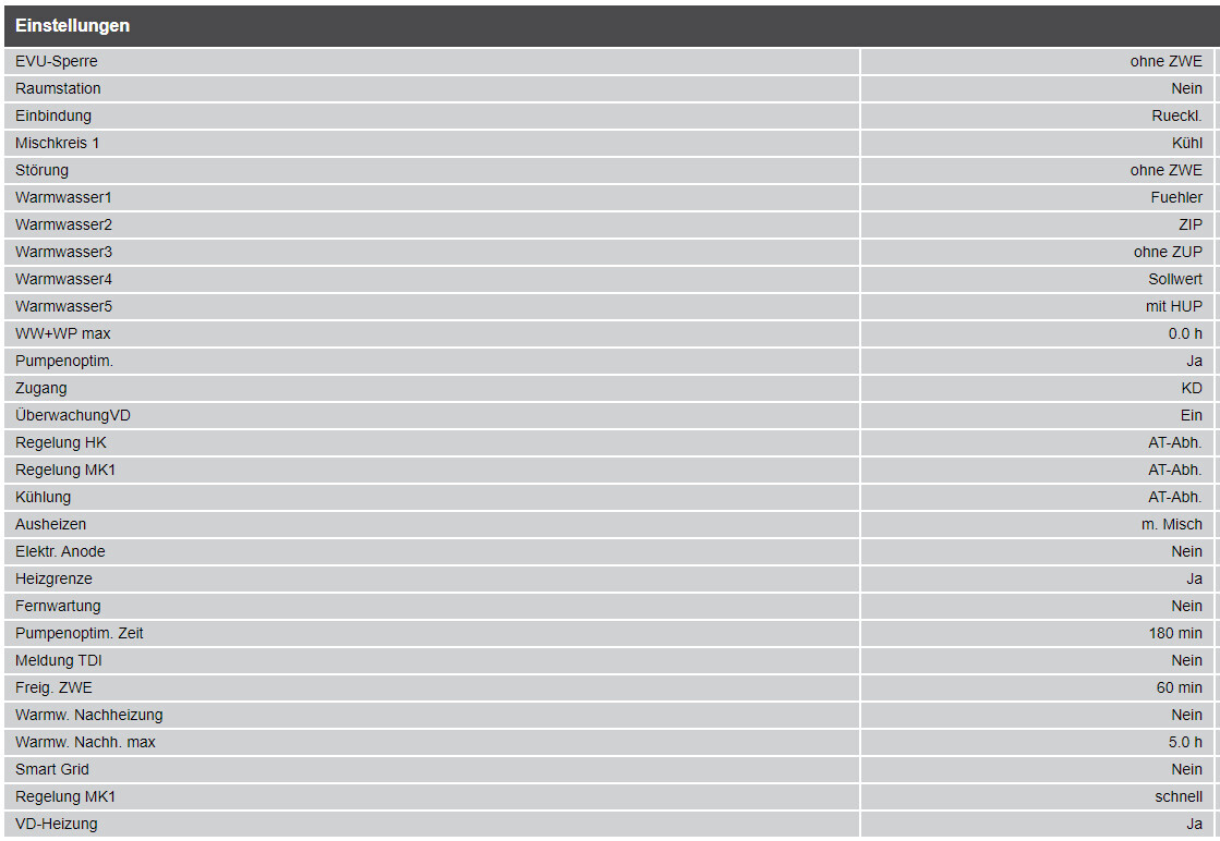

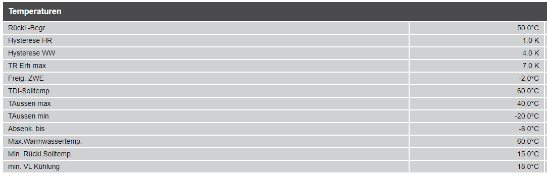

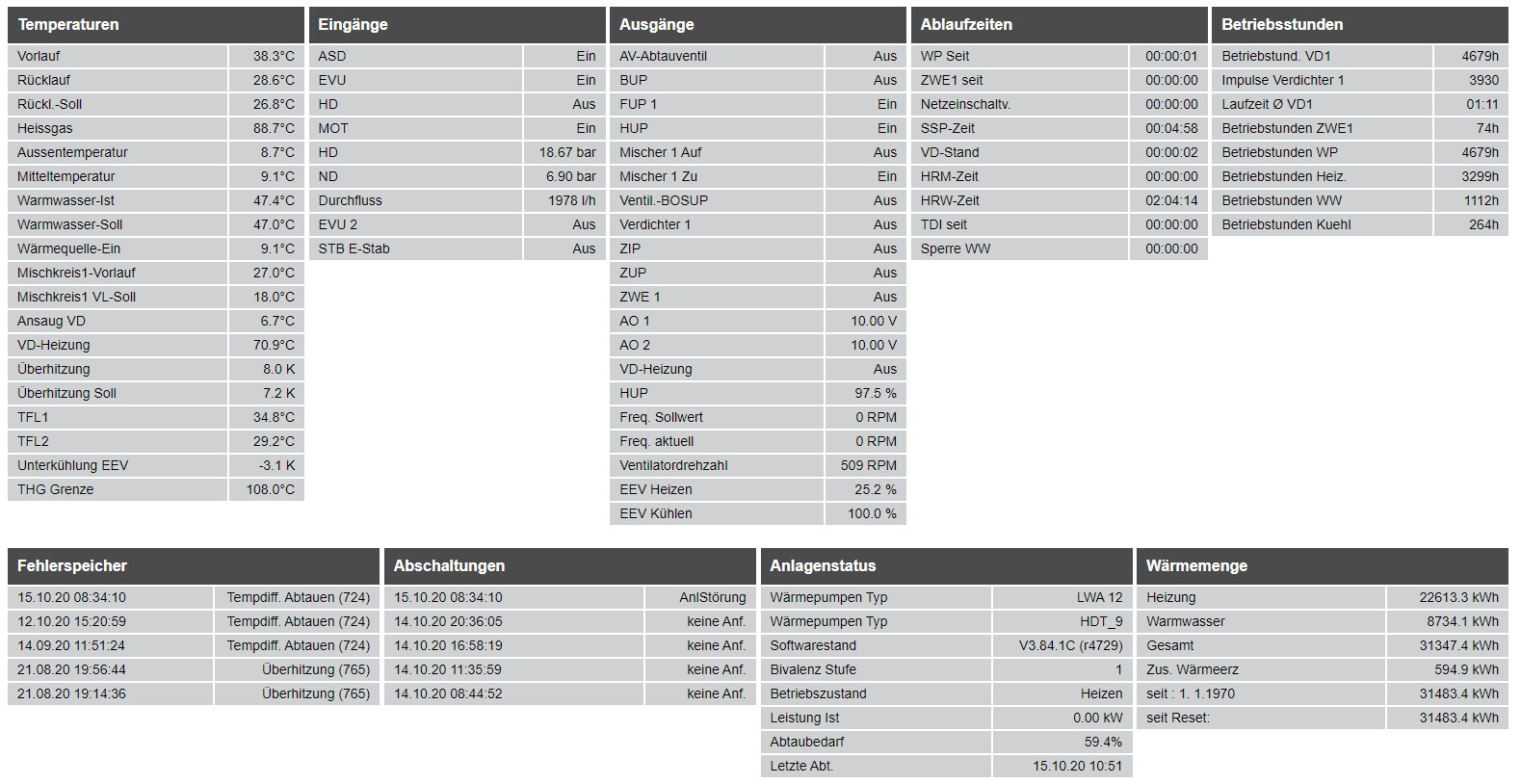

I would also like to fine-tune the settings of my heat pump. Here are the current settings:
Process dashboard: temperatures, inputs/outputs, cycle times, operating hours, system status.
Table with temperature parameters and limit values: return limit, outdoor temperature, target temperatures.
Table of heating and hot water settings with values.

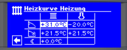

Digital heating display in blue with heating curve and temperature readings
The hot water is set to 47°C (117°F) with circulation running 3 hours in the morning and 4 hours in the evening. Circulation pump is on for 5 minutes, off for 55 minutes.

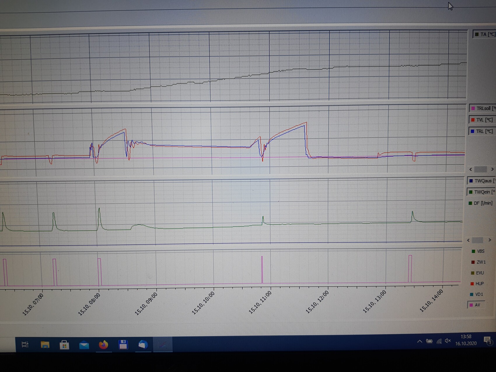

- We repeatedly get error 724 (defrost temperature difference >15K). The technician suggested increasing the secondary circuit flow, saying the energy in the heating circuit is currently not sufficient for defrosting. That sounds illogical to me. What else could be causing this error?

Can you provide a DTA?

can you provide a DTA?
Yes, link will be sent via private message
Daniel-Sp
16 Oct 2020 14:00
According to DTA, the defrost valve did not open. However, it works in heating mode. A technician needs to take a look. Try contacting the manufacturer.
