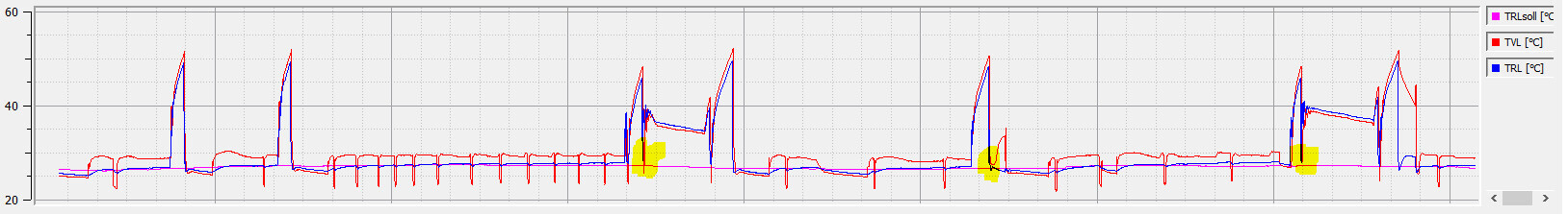

I have just extracted the current DTA. The recent faults were:
Attached is the course of the TRL setpoint, TVL, and TRL. The yellow highlighted areas indicate the faults. What could be the cause?
Daniel-Sp16 Oct 2020 13:24Hmm, this issue only occurs during defrosting while heating hot water. Could it be a software problem? Or a control system issue? I would recommend contacting the manufacturer to see if this is a known problem.
