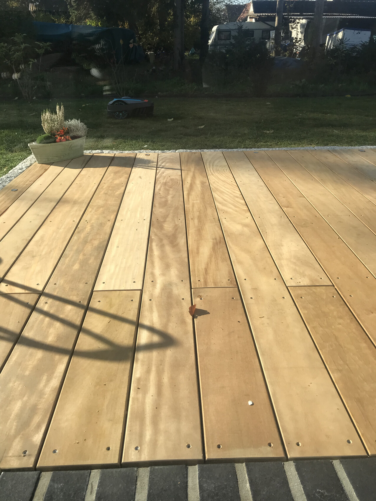

This is how our decking boards looked:
Long wooden slat lying centered on gray paving stones; stack of construction timber in the background.
With the mentioned tools, they could be managed well.

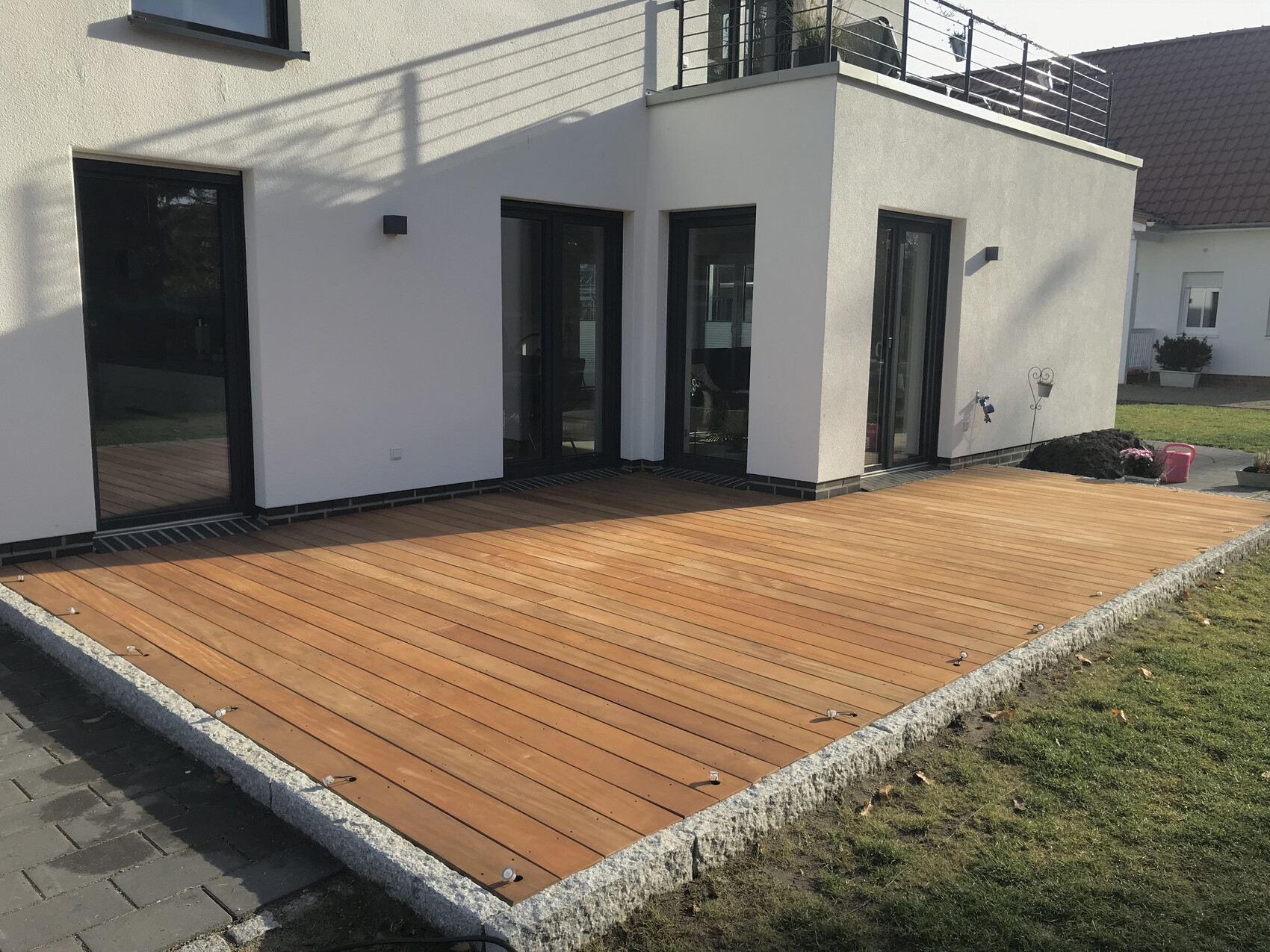

Modern white facade with large wooden terrace and glass sliding doors
In the end, the result was a terrace that brings joy every time you see it.

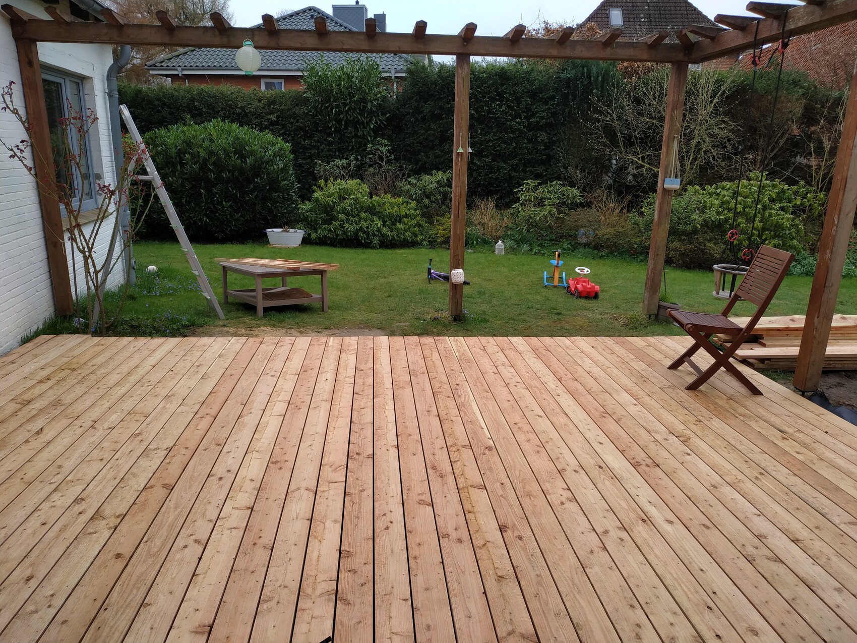

I initially leaned towards thermo-treated pine or thermo ash but ultimately chose classic larch for several reasons.
The terrace is about 34 m² (370 ft²) in size. The price of the wood was an important factor since all other options would have been at least twice as expensive. I installed 28/120 mm (1.1/4.7 inch) boards without any profiling, so they are smooth. At the moment, I’m very satisfied. How long that will last remains to be seen. I followed the main guidelines for structural wood protection, so I’m not too worried about long-term stability in general. As for splitting or checking, we’ll see. Working with larch is also easier than with hardwoods, and since this is my first own terrace, I didn’t want to make things unnecessarily difficult or struggle with particularly expensive wood.
Here is a picture of the terrace. The photo is from February, so it wasn’t finished yet. On the right, you can see the wood pile. The decking was extended about 6.5 m (21 ft) to the right with boards that are 2 m (6.6 ft) long instead of the 4 m (13 ft) ones shown here. (The pergola was built by the previous owner).
Garden with wooden deck and pergola, wooden chair on the right, toy car on the grass, green hedge in the background.
