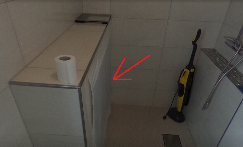

There was a planning mistake made in the guest bathroom of our preferred property.
The utility connections are located "inside" the shower. They need to be accessed at least once a year. The opening is about 1m x 0.6m (3.3 ft x 2 ft) in size.
Currently, as shown in the picture, the opening is covered with a plastic sheet.
What creative ideas do you have for adding something nice and waterproof that doesn’t have to be permanently installed?
We were thinking of a folding bathtub screen with an opaque frosted glass look. However, that would unfortunately block access to the shelf.
Thanks

There are special access panels designed for showers. If you enter the terms "access panel" and "waterproof" into your preferred search engine, you will quickly find suitable options. Please keep in mind that the rubber seals need to be maintained periodically.
They are also available in larger sizes; just give a manufacturer a call. Do you need it this big? Or wouldn’t it be easier to reduce the hole size?
