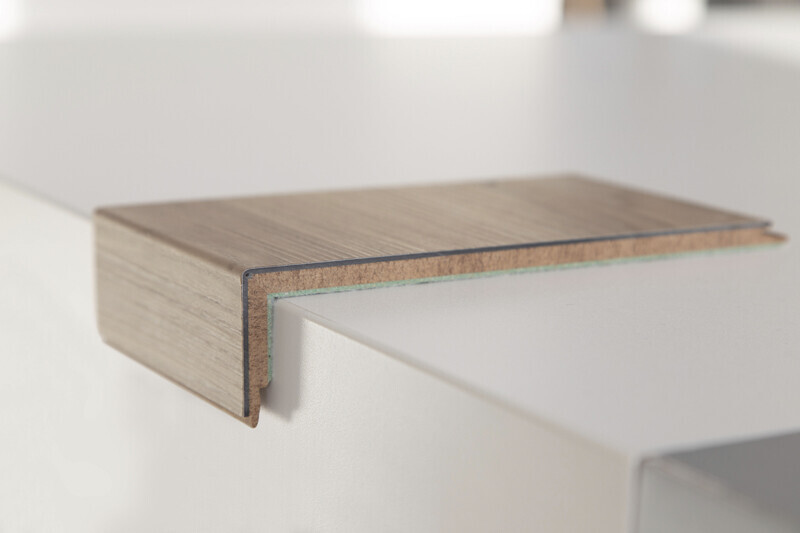

@hanghaus2023: The material should basically remain the same thickness, not thinner. Milling should not go all the way through to the wear layer. During my online research, I also came across the following:
By the way: Can vinyl coverings with HDF (as shown with wineo 400) also be glued without issues? Some exclude gluing but I can’t understand the reasons why.
Close-up of a wood-look edge band on a white countertop

@hanghaus2023: The material should actually remain the same thickness. The groove should not be routed down to the wear layer.
You asked about a routed groove like that. How can the material maintain the same thickness then?

Of course, the material becomes thinner at the milled groove. However, the support is still maintained due to folding or bending.
This was the idea of a stair builder. I just wanted to generally ask if this is a common practice...
