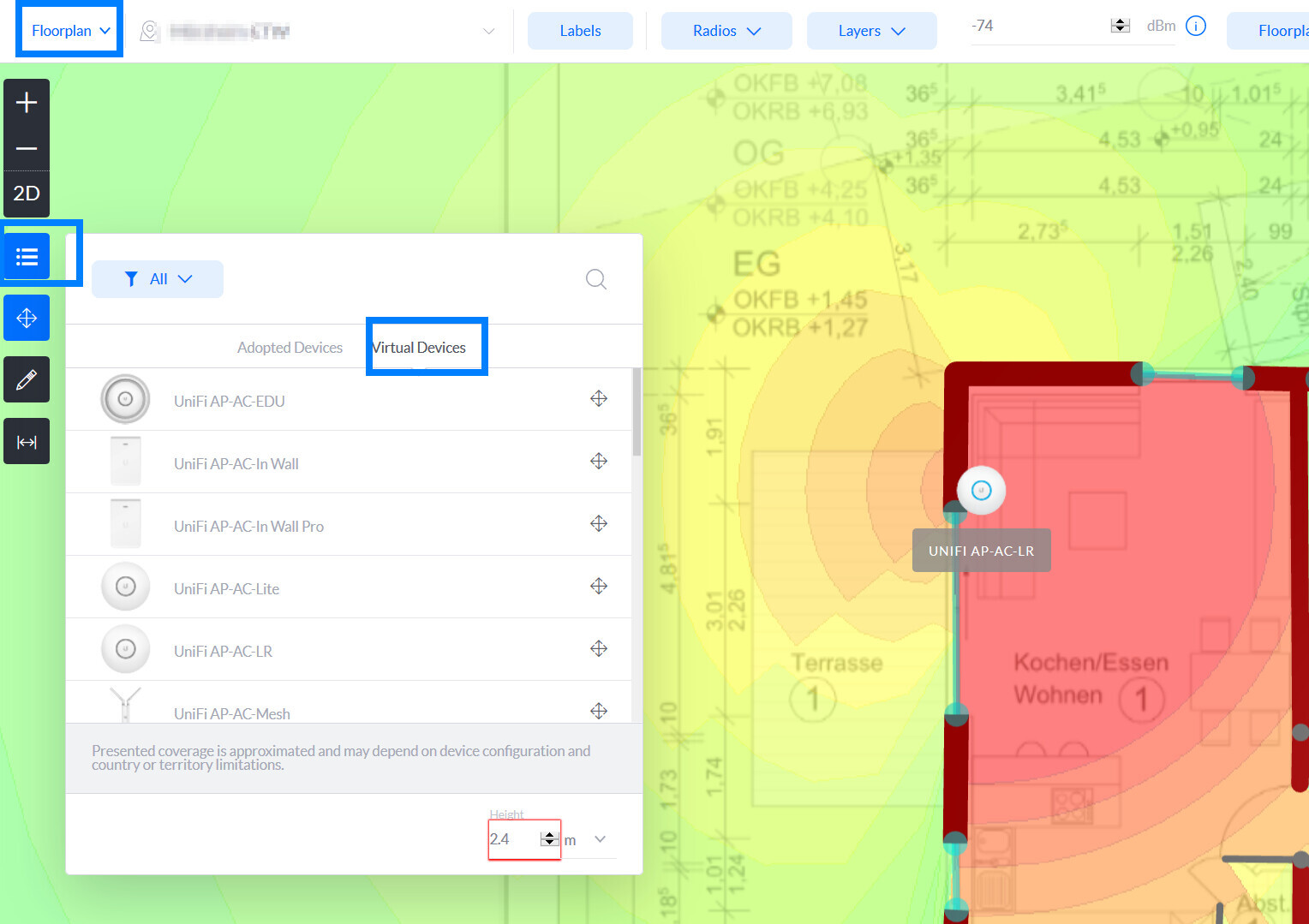

Hello, no idea why my last thread was deleted... I wanted to position the access points myself in my floor plan to see how the Wi-Fi range changes. Someone had already done something like this for me in the deleted thread (which is now gone). However, I can’t add any access points at all because I don’t have a system running?!?? Is there a way to do this in a demo mode or something? I haven’t found any information about this.
Correct. You can use "virtual devices."
Map -> top left on "Floorplan" -> hamburger menu "Place Devices" -> "Virtual Devices," and there you have all the devices available.

@Teemoe86: I just can’t find anything there, no matter how hard I try. Is that feature only available in the English version? I’m currently using the latest German version, and I can’t add virtual appliances. Creating the floor plan worked, but since there are no appliances available, I can’t insert anything there.
