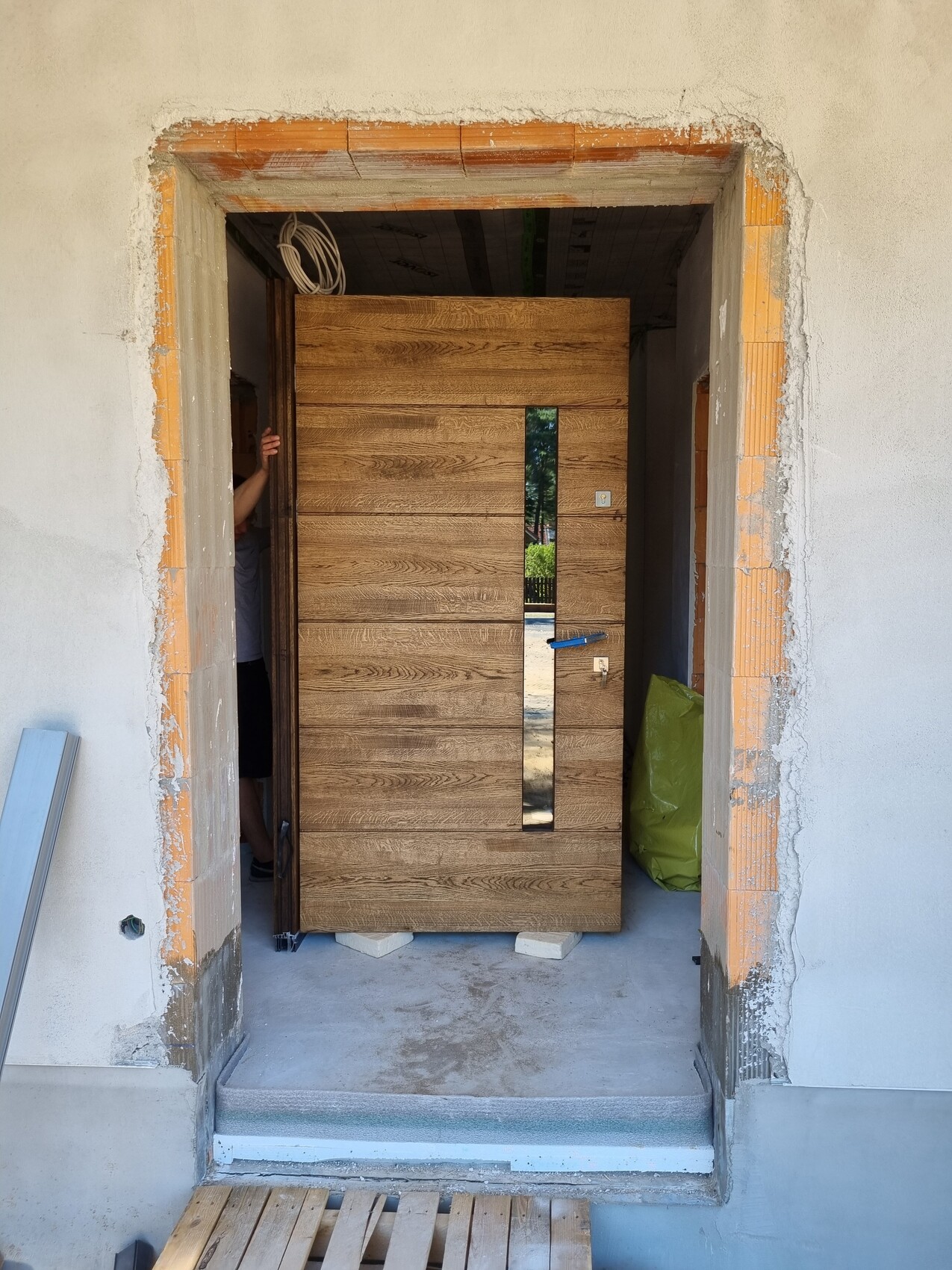

I have learned this now as well. I outsourced the doors and only followed the installation timing for the interior doors as shown on the construction plan. As a result, the exterior and interior plastering, as well as the screed, had to be done twice—once before and once after the door installation. Here are photos from outside and inside.
Hallway under construction: green pipes on the ceiling, insulation panels, unplastered walls, and wooden door.
New wooden door with narrow glass slot in unfinished entrance area of a construction site
Neubau2022
17 Aug 2022 15:26
SaniererNRW123 schrieb:
No, usually not. Plaster and screed leave some space. The door is installed at the very end and then minor adjustments are made.
Doing the work twice means double the travel costs and total expenses. The construction time also gets extended because the plasterers have to come right after the door installation, which rarely works out...
