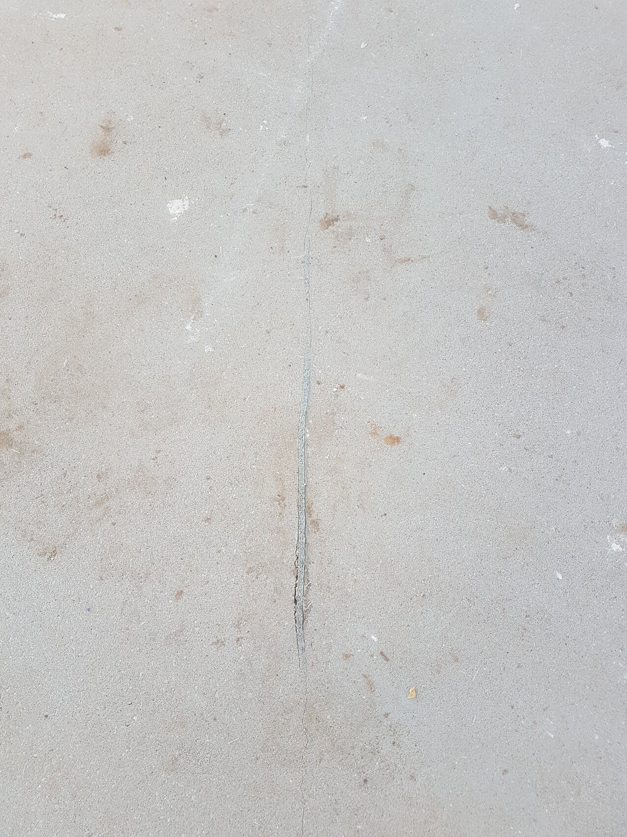

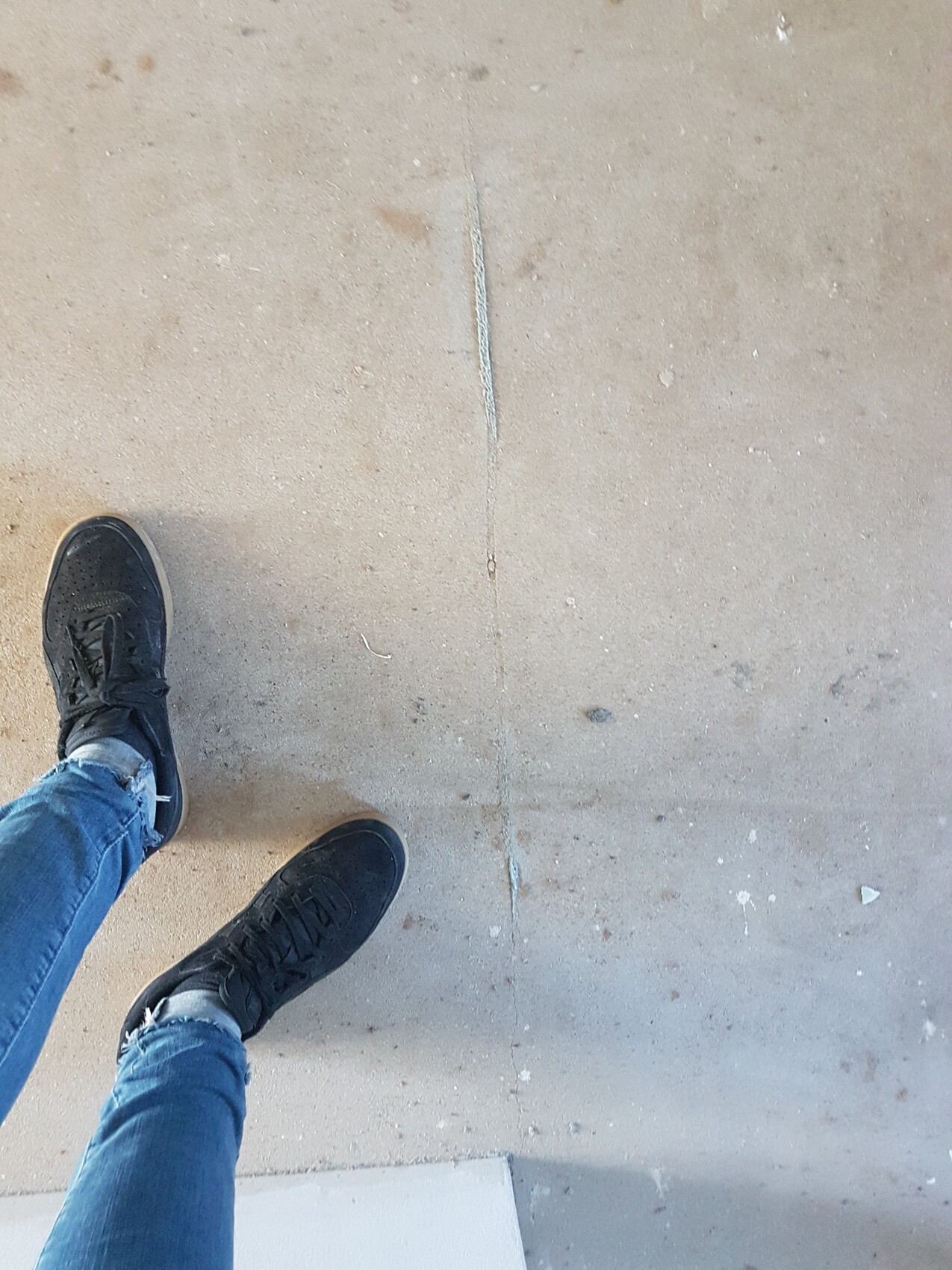

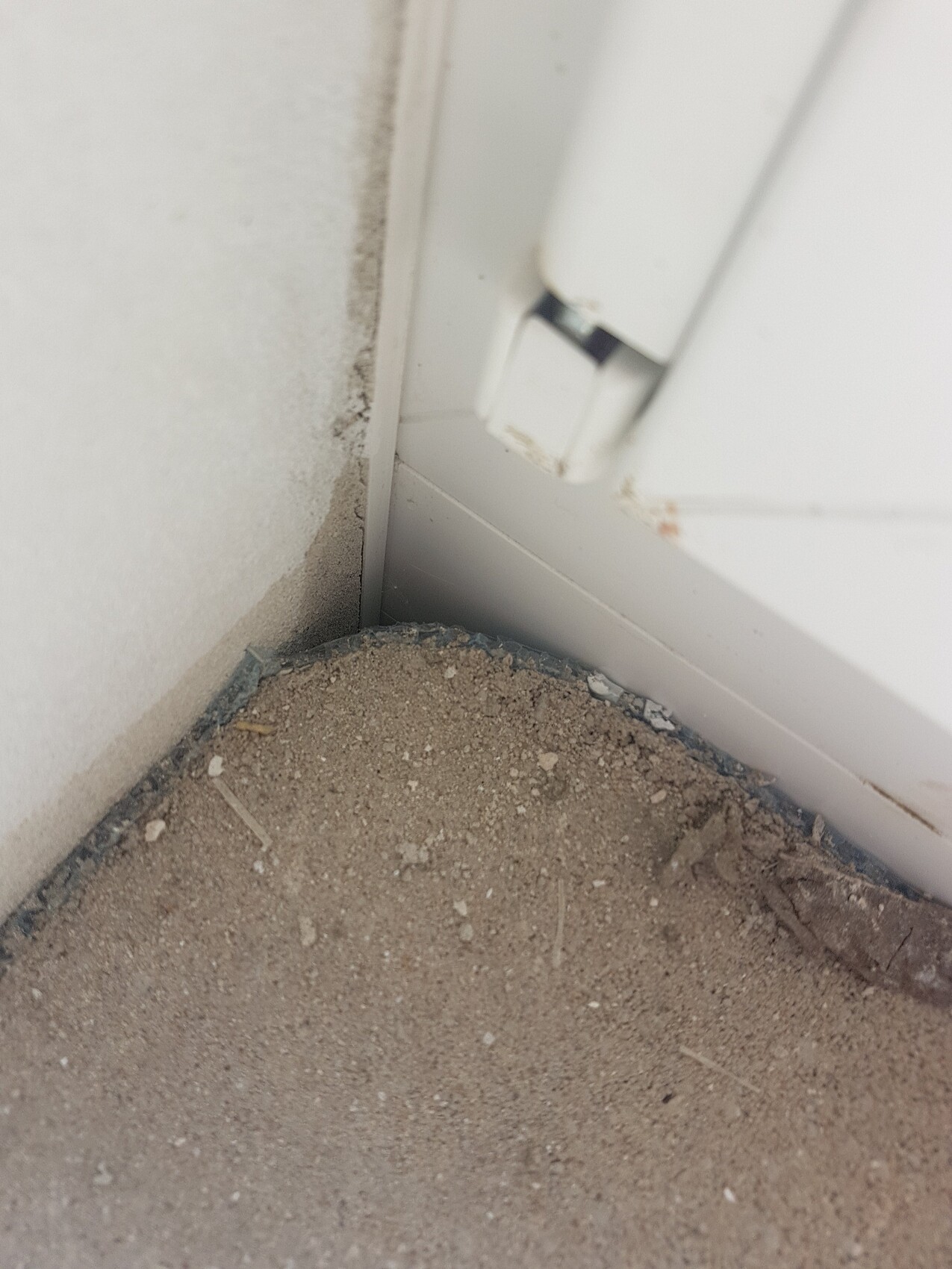

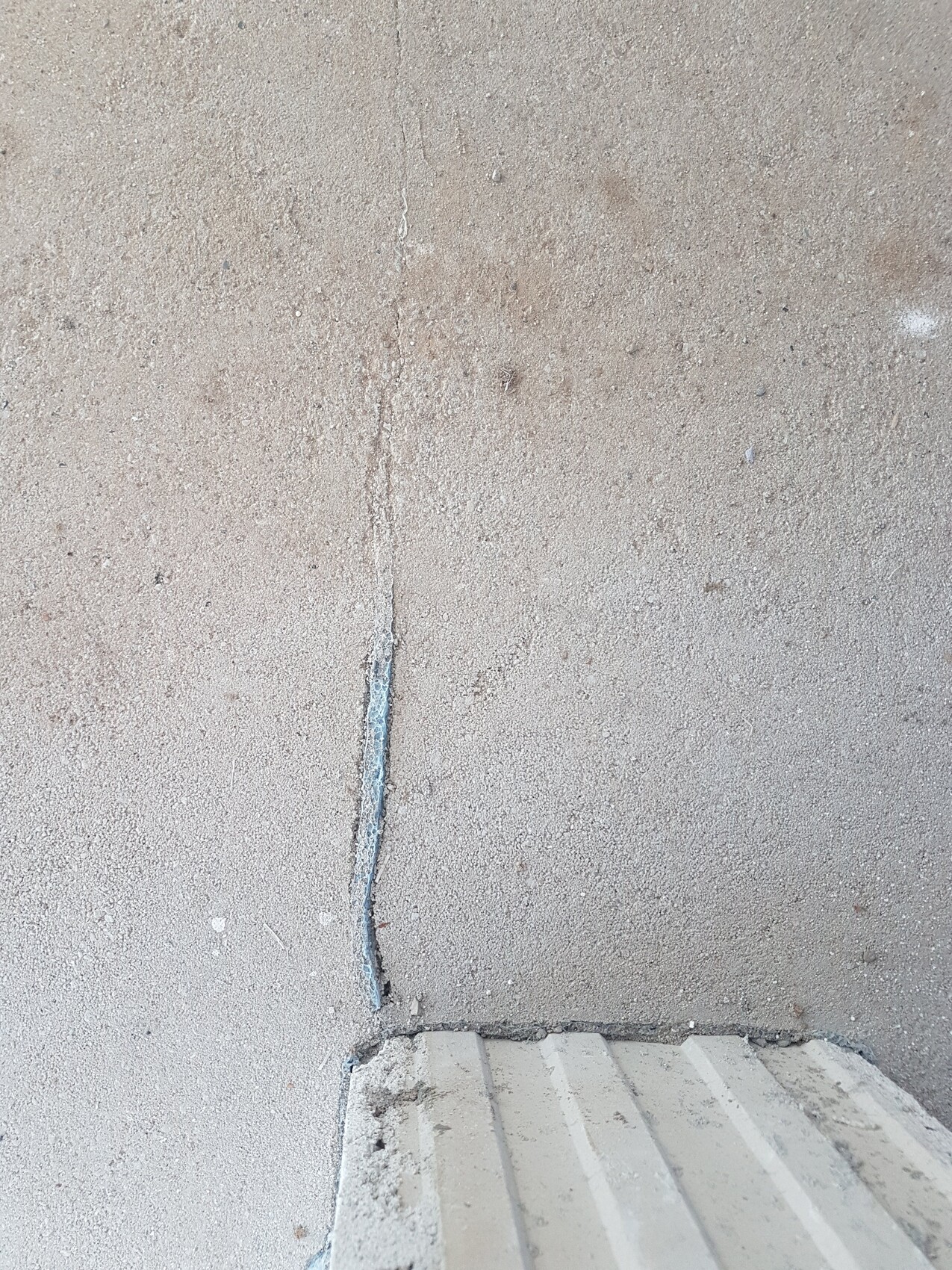

We have the final inspection of our house next week. Today, we thoroughly examined the house and noticed that long cracks have appeared in the screed on the ground floor. Also, the corners at the patio doors are rounded.
The builder says these are normal stress cracks and nothing to worry about.
Do these cracks necessarily need to be repaired? What happens if we simply lay our vinyl flooring over them now?

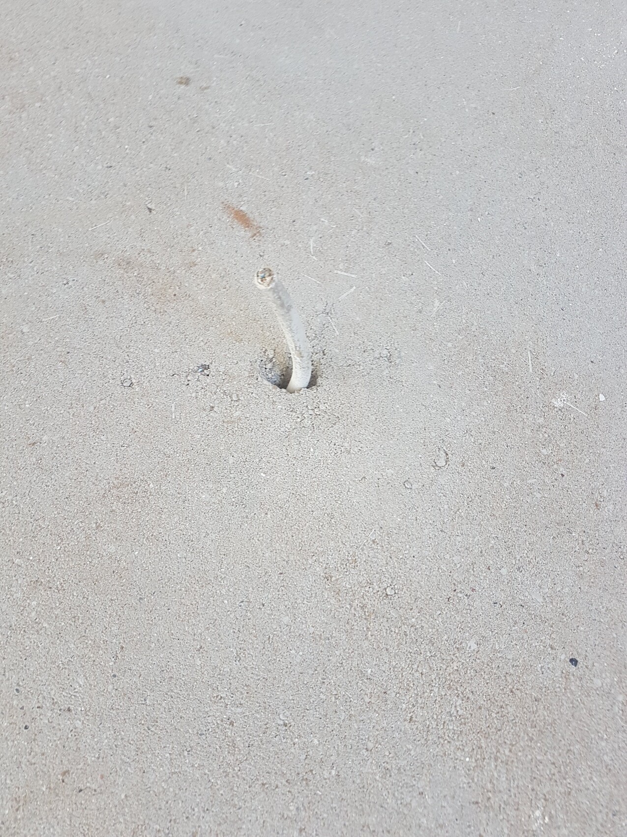

Also, does anyone know what these 'cables' (last picture) in the screed are?
Thank you in advance

Thank you for the detailed response. The house has underfloor heating, so it is a heated screed.
KlaRa7 May 2020 10:24
@ Onik900:
Please scan the floor plan, mark the room where the entrance photos (showing the alignment strip in the middle of the room) were taken, and indicate the position of the mentioned alignment strip.
